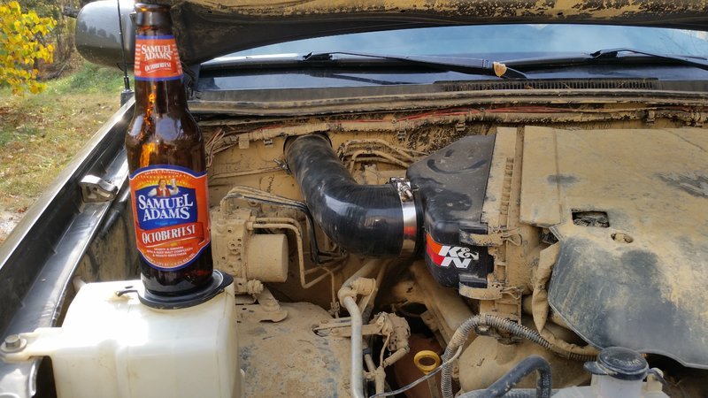

    Thanks, stock down pipe and cats, correct? I'm probably going to do this for the time being until I turbo

    Yes. Only other mod that may afect the sound is the DIY snorkel mod. Deleted factory air box and piped into the wiper cowl.

    Ah, ok. Looks "clean" besides all the dirt :D

    The Flowmaster is loud AF in the cab. Lots of drone, wife hates it lol

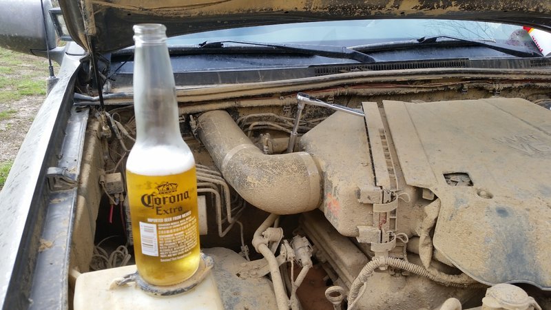

    Parts list you used?
    Yours looks like a one piece elbow all the way to the firewall?

    It's not. Used the same parts from the other thread. I cut the rubber exact length with hides the aluminum coupling. Harder to assemble their way lol

    I see the benefit of getting the intake higher to keep out water. How does it do with dust? In my mind, even a snorkel has challenges with dust, what with its forward facing head. With this setup, it would seem a lot of dust would simply blow up, over, and past the windshield cowl.
    After my Colorado trip I've been considering a snorkel. The dust out there was atrocious. If the benefit with this set up overcomes the dust, I would definitely lean this was. Plus it's a hellava lot cheaper.

    Does pretty good. Cheaper, oh hell yes!! I did it specifically to relocate my intake from the fender when I went 35s.
    Fresh TRD filter installed before 5th Annual LBL meet. Lots of mud and gravel roads.
