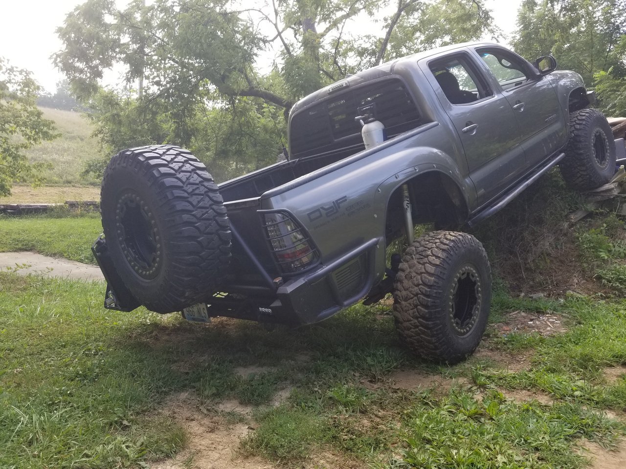

    Brakes good!! Read up on bench bleeding and decided to do it installed!!
    She stops on a dime :thumbsup:

    so just incline it and do normal bleed or what?

    Started level and opened the driver front bleeder. Half pumped about 10 times with it open and the pedal stiffened up. I think that got most of the air out of the master. Went to incline, extra bottle of DOT 3/4, pumped with both rear bleeders open (separately). Kept topping off the reservoir, bleed till I was free of bubbles in a long, clear, 1/4 vinyl line.
