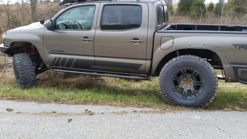

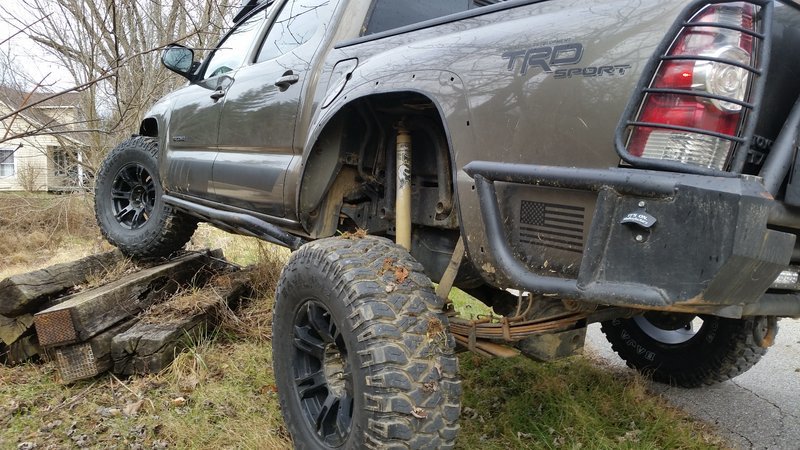

    DYF alignment round two. Cranked my coilovers down for about 3 1/2" lift and taco lean, no rubbing for DDing. Looking at 2.0ish caster, I am guessing lol. Will be doing another fine adjustment soon.

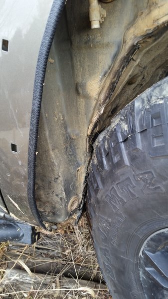

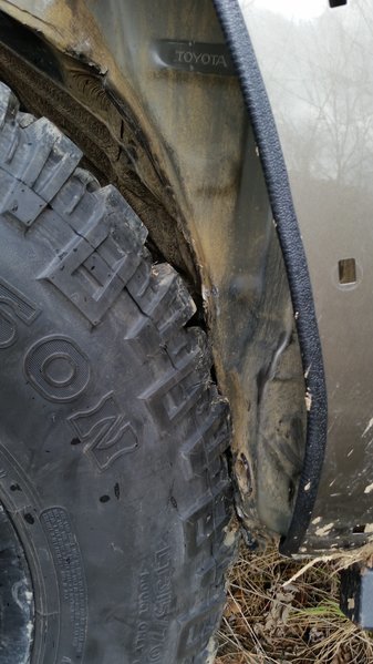

    Flexed it out in the Yard, probably cut and plate the firewall along with a more agressive CMC.
    .....RUB RUB RUB RUB LOL

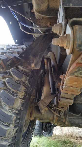

    What's the offset on your wheels? Hard to tell, are you ribbing the shock in the back?

    Fire wall cutting is fun :) easier with 2 people though

    -12. With 1.25 spacers the BS is around 3.75". Some crazy drunk guy bought stem top shocks and had to improvise during relocating. The bung top will mount more inboard, as soon as I destroy these : )

    Freakin' drunks. Do you have any rubbing in the front from just uptravel? I need to put a 1/4" spacer on my bumpstops up front because under full compression I rub almost the entire squared off area of the inner fender.

    Think I put 3/8 spacers under my Superbumps. No rubbing just due to up travel currently

    Good shock placement bro. :D
