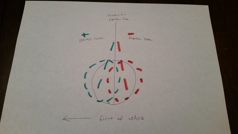

    Doesn't caster move the tires forward, therefore further away from the firewall?
    Meaning less caster would put you more in the firewall?

    this is my understanding from what I've read when I was setting up my LR ucas.
    Increasing caster from the LCA increases clearance at the rear of the well by pushing the bottom of the tire forward. However, increasing caster at the ball joint (pushing the top of the tire forward) will reduce clearance at the back of the well.

    Zack and carter are both right. Here's a quick diagram i drew to help explain for anyone still hazy. I sure yall don't need this though.

    This .

    still kinda confused but oh well. My shit ain't rubbing so I'm not too concerned
