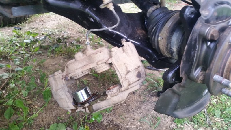

    How do the brakes feel? May be going that route as well, assuming they make a 1st gen kit.

    Brakes feel great, stopping really good now. Tough to get a good comparison since they were barely stopping me when the were worn so thin. Did poly lower control arm bushings same time and still haven't got my alignment dialed in.
