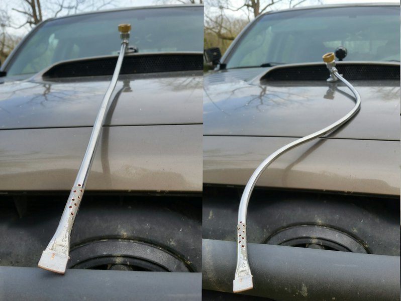

    DYF opposable douche nozzle. A clean radiator is a happy radiator. Finally using it tomorrow, had to blast the heat on a few hot days already.

    Heat blasting to run 220° - 225°. Haven't really been out on a hot day until today and it was the same.

    worse come to worse, you can pull out the engine fan and shroud and hose it.

    I've got a lot to take apart anyway, hoping this little guy will get down in there and I won't have to take everything loose next time :fingerscrossed:

    If you need it cleaner let me know. I have quite a bit of refrigeration coil cleaner. Non corrosive but it will get dirt off cooling fins when it has been baked on. Spray it on (with a garden sprayer) let it set for a short while then hose off. I've been using thiss stuff on dirty radiators for years with great success. Started off cleaning radiators on dirt bikes
    They were too delicate to hit with a pressure washer when they first appeared on bikes in the early 80's.

    I have some, just sprayed it with the DYF nozzle for now. Got a ton of dirt out, half a mind to put it back together just to see how effective the nozzle is on the temp. Will probably spray with the cleaner and rinse and not mess with it again until after RRG.

    Think the cleaner worked well, it was already pretty clean but still got some brown water.

    Clean as a whistle!!
