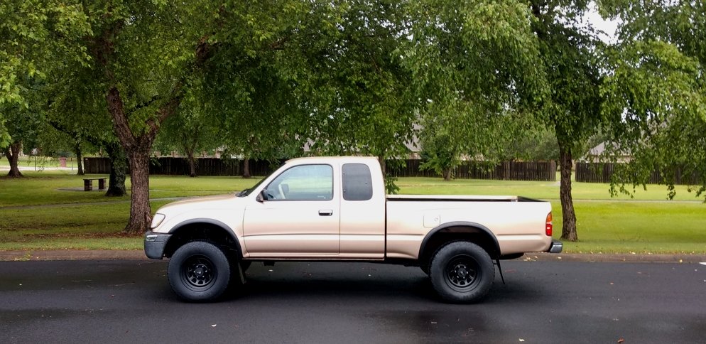

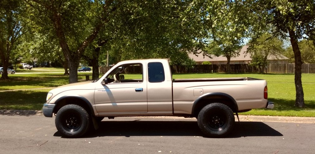

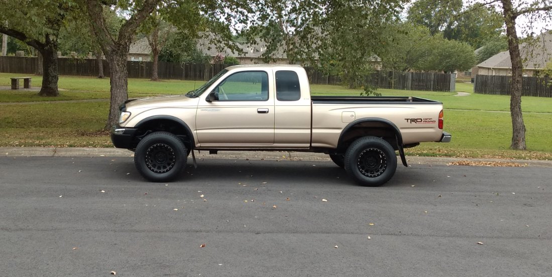

    Just finished installing Wheeler's 1.5" Add-A-Leafs with a 3 degree shim on the rear of my 1999 PreRunner TRD. Over the summer, I've been slowly upgrading the suspension. When I bought it in April, it was running the original TRD springs and shocks that were well past worn out. Overall the ride has drastically improved from when I bought it. Initially, I was concerned about how the AALs would ride. However, I am glad to find some of the familiar road bumps are not so harsh since I installed the AALs. Handling is a bit more responsive compared to when I was running with only stock springs.
    I see questions come up from PreRunner owners looking for examples of a "mild lift" from the stock suspension. Hopefully these pictures will answer questions about a "mild lift" upgrade from the stock PreRunner TRD suspension.
    Before - Stock Suspension
    After OME 880 with Bilstein 5100 shocks on the bottom (0) lift position. The OME 880s provide a "mild lift" over stock for the lighter 2WD PreRunner.
    After installing Wheeler's 1.5" Add-A-Lift along with a 3 degree shim.
    Now I have a slight rake on the rear that is closer to the original look when the truck was new.
