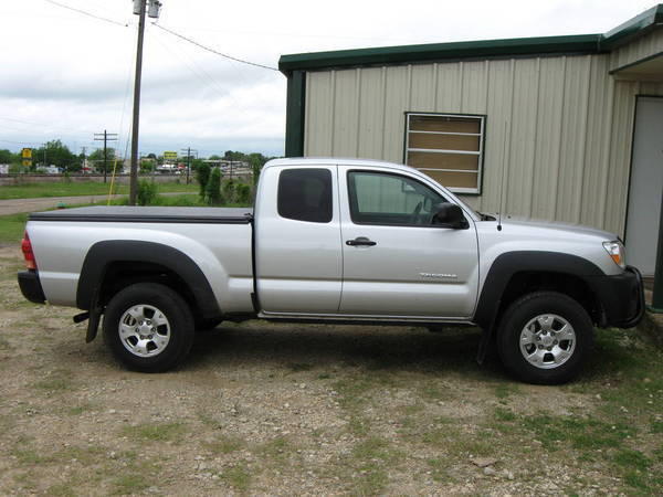

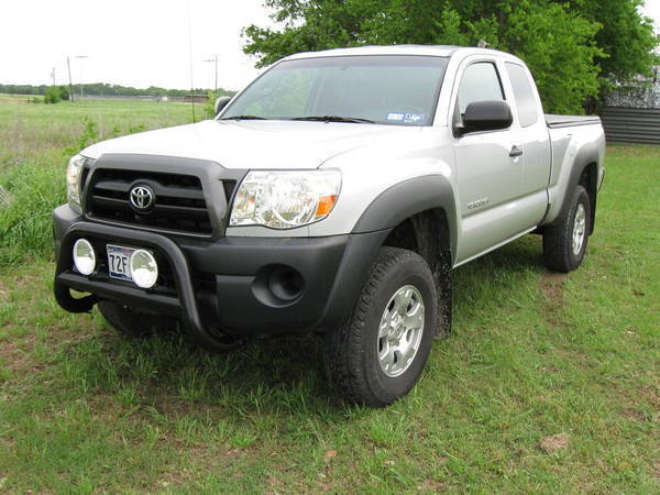

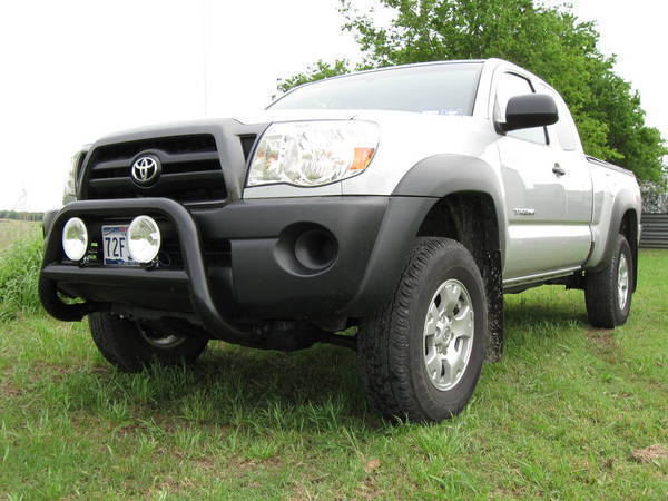

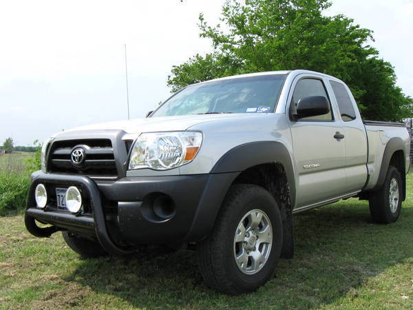

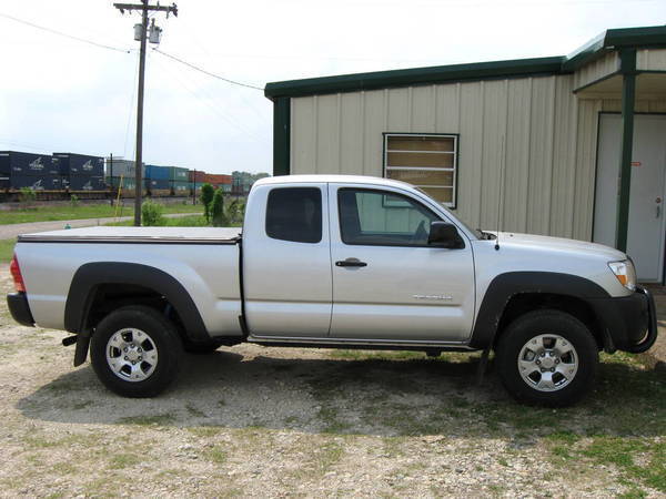

    I love the ride and the look I'm glad I went this route.[​IMG] before[​IMG] after5100s ay 1.75[​IMG][​IMG][​IMG][​IMG]

    these pics do it no justice!

    Yea I have rear tsb tires are factory 245s (I can hardly wait till they wear out to get 265s ) it looks better than the pics show. I cant beleve how good it rides. Even the wife thinks it rides better,and she thought it was dumb to do it. But hey, I think it's dumb when she cuts her hair shorter. you will love the 5100s

    that should be perfect with the aal lots of guys on here have that setup I have about 3/4" rake now but last night I pulled my 8' trailer with 4 wheeler and it was a bit nose up so I like some rake. It mesures 37" in rear 36 1/4" in front with factory 245 tires.

    tsb 4 pack only fronts at 1.75= 3/4" rake
