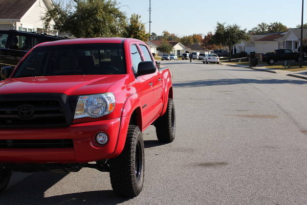

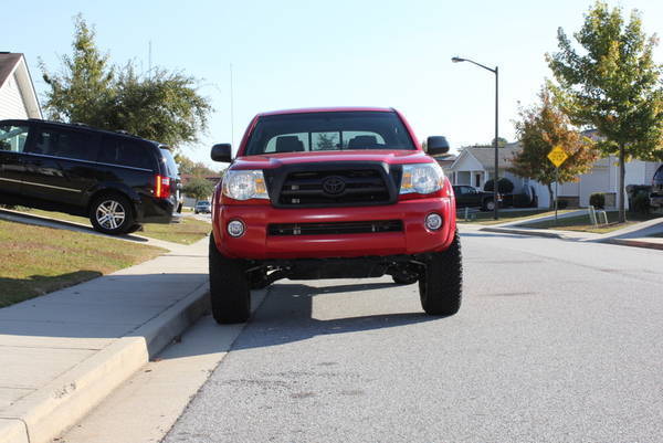

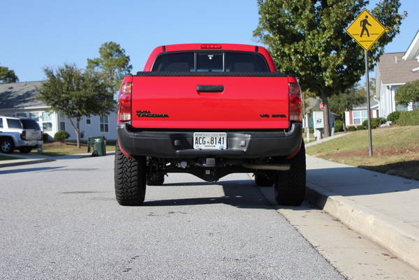

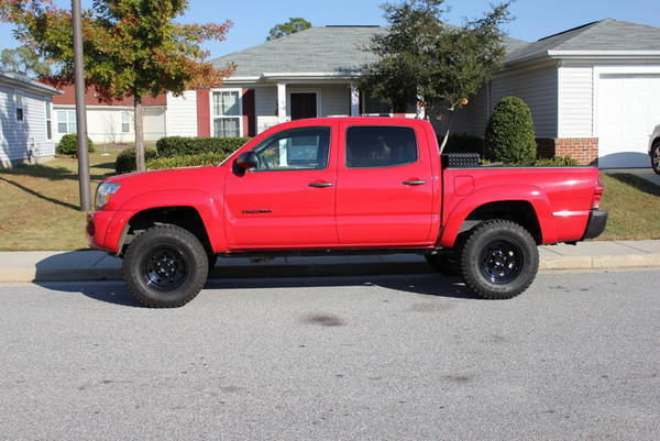

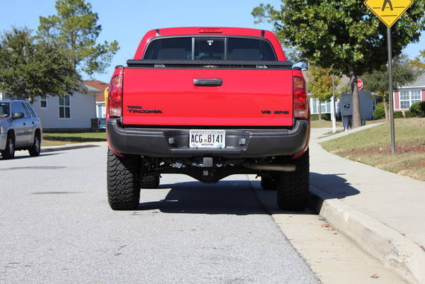

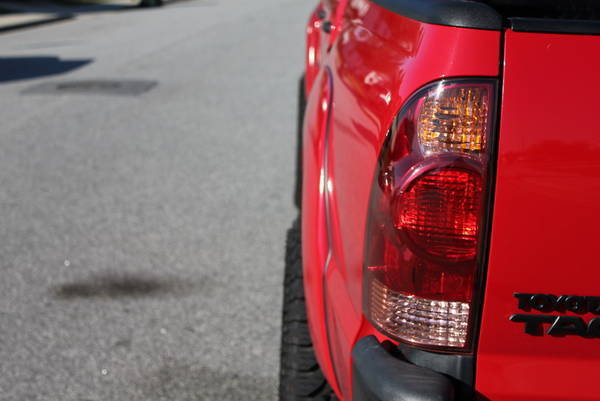

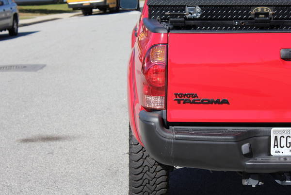

    I went from stock wheels to the Wheelers Steel Type B's. Tires are 265 75 R16 Goodyear Wrangler Authorities. The backspacing really does a lot with these wheels. there was a significant difference in spacing between the tire and the UCA's. I could barely fit my finger between the two with the stock wheels and now there is a good two inches or more in there. 285's maybe? The factory TPMS DOES work with these wheels. The differences in the pics may be subtle but I got what I was looking for. It seemed too tall and skinny before now it looks more proportional.
    Before:
    After:
    Before:
    After:
    Before:
    After:
    Angle:
    Side:
