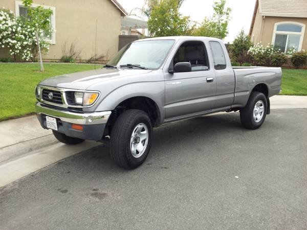

    Hi guys, just thought I'd share my progress on my 95.5!
    10153003_10152120258333403_5237376044581_7402974aacc6199ac68cc20a17bcc1b20659a096.jpg
    Clifford when I got him in April last year .
    Clifford this afternoon.
    The before pic doesn't show the old damaged tailgate, but here's the replacement:
    Parts list:
    Sony stereo from Best Buy
    Tailgate shell from carparts.com, painted matte black
    Decal from The Decal Doc on Ebay (custom order, $40)
    Bilstein 5100s
    Toytech eibachs
    2" add a leaf
    15" Pro Comp wheels from Summit Racing
    1.5" Spidertrax spacers
    33" Toyo Open Country M/Ts
    Bigass sledgehammer
    It's a long slow process and I love it. Next is painting the bed protector thingy.

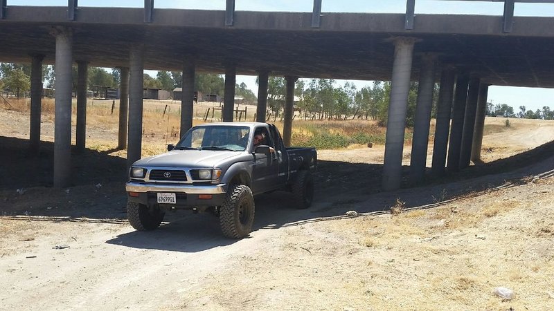

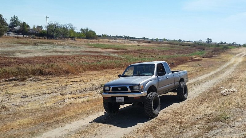

    Anyway here's what I did yesterday: 7342.jpg
    Lost a valve stem cover but that just gave me an excuse to go to Pep Boys and pick up a set of cute ones.
    This trail is SUPER easy but I'm a beginner so it was pretty fun. Plus it's like 5 minutes from my house.7339.jpg
