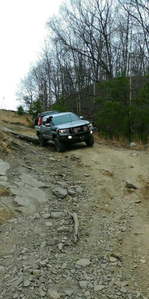

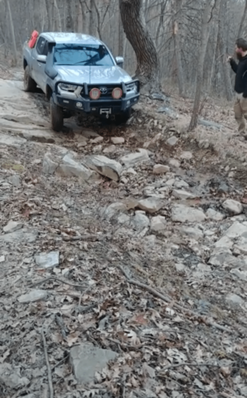

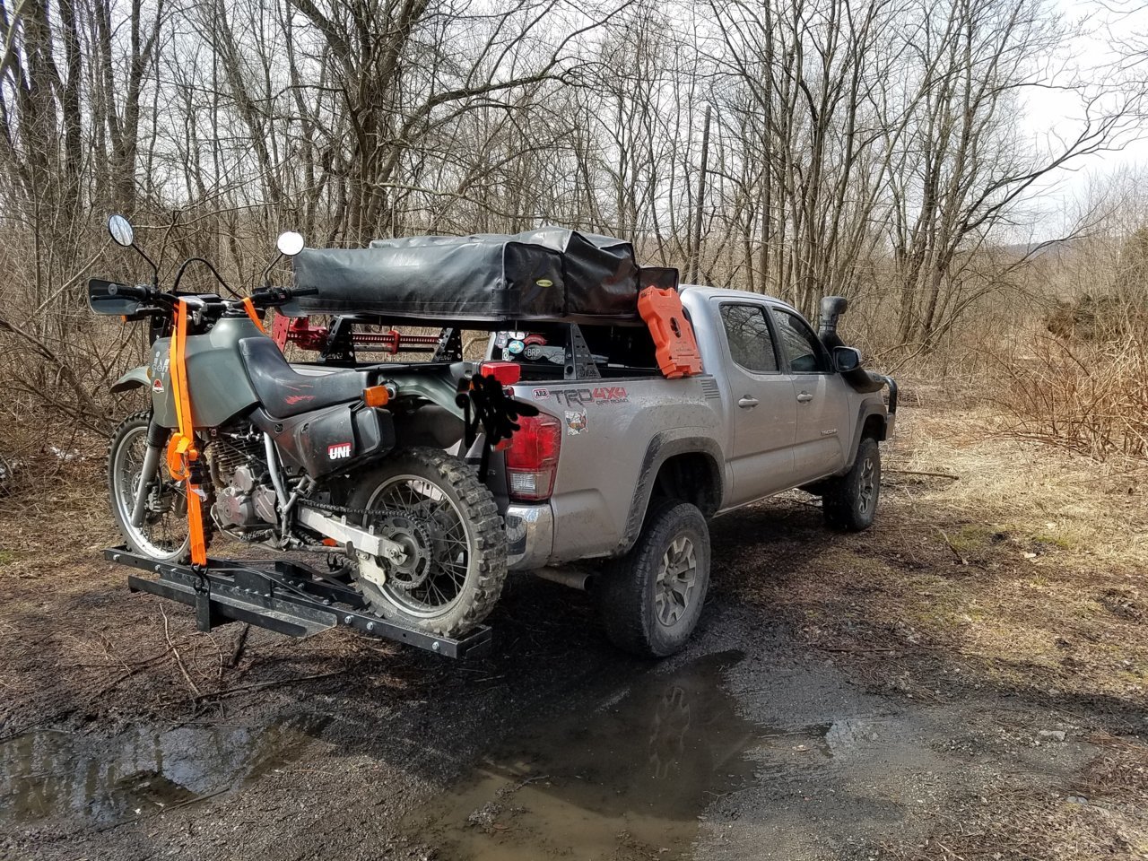

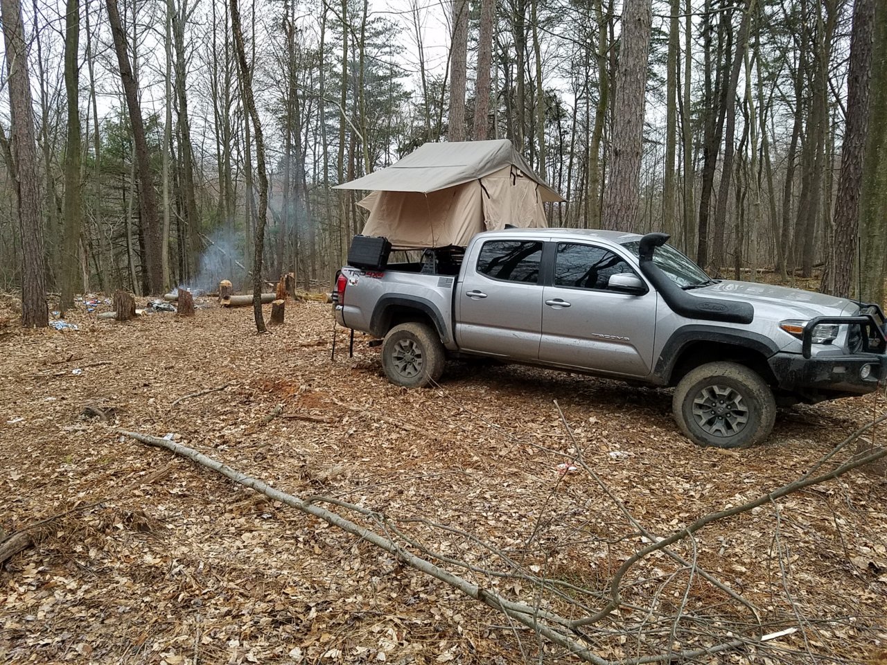

    I run a OME HD suspension system and works great my rig is my DD so my tent comes off to save fuel. But still not a bad ride with no weight in the back. 20180415_072936.jpg 6235-MMS-1523818859338-attachment1-Snapchat-514371457.jpg 20180409_134533.png 20180315_150527.jpg20180324_175805.jpg
