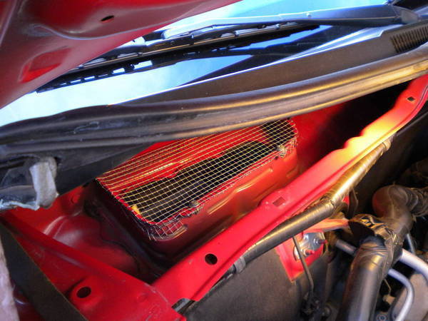

    As a follow-up...
    The cowl area is basically wide open from the fender wells.
    There is no protection at all, except ensuring you close the recirculation door each time you park the truck.
    It is possible, even with the door closed to have rodents build a nest on top of the recirc door, and when fresh air is selected, the entire "bundle" will drop into your cabin air filter.
    Oddly, Toyota designed the air inlet, just above the cabin fresh air inlet with a flange and mounting holes for a screen or something but it seems it never made it to production in the US, maybe never anywhere.
    So using cardboard to design a template, I used wire lath for stucco on a home and fabricated a screen to prevent rodent entry into the cabin airbox. Some primer, paint, a couple of metric fasteners and done.
    PK

    What do you remove to get to this? Is it just that rubber seal thing that is between the edge of the windshield and hood?
  12. Apr 7, 2012 at 6:48 PM
    blenderdriver
    blenderdriver Inflamed Member
    Mar 12, 2010
    #33076
    44
    Todd
    texAss
    Magnetic Grey 2010 4 Door, 4X4, Long bed.
    Two tailgate mounted Rolls-Royce AE3007A1 high bypass ratio, two-spool axial flow turbofan engines.
    Animal proofed mine last fall, also covered the holes at either end of the channel this sits in, keeps them out of that area all together.

    Open the hood. Remove the plastic clip with the phillips head. Gently unseat the black plastic cowl grille. I did not bother taking off wiper arms or anything beyond gaining access. Lifted and supported the plastic grille with a small cardboard box.
    BTW, this is near the right side by the antenna, directly above your cabin air filter.
