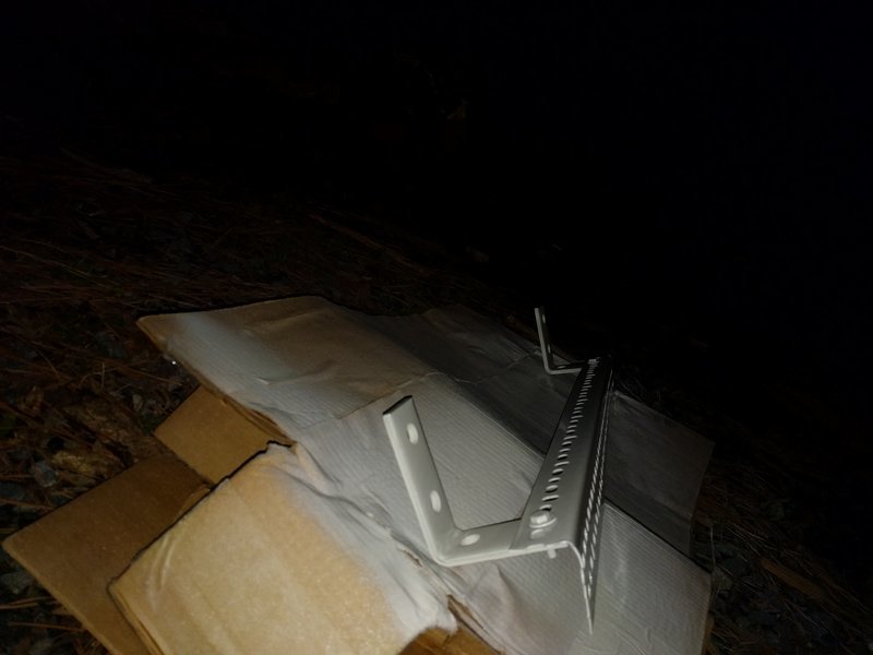

    I started with basic supplies that I could find at my local Home Depot. Here's the list:
    (1) 1-1/2 in. x 14-Gauge x 36 in. Zinc Slotted Angle Bar $16.48
    (2) 14-Gauge 6 in. x 5 in. T Straps $4.20 ea.
    (5) 1/4 in. x 1 in. Stainless-Steel Hex Bolts w/ washers and nuts
    (1) Can of Rustoleum Primer Spray Paint
    (1) Can of Rustoleum Flat Black Spray Paint
    Two Lights of your choice.
    The T straps are bolted to the back of the angle bar using 4 of the hex bolts, washers and nuts in alignment with the two mounting bolts for the AC Condensor. Once in place, I drilled a hole through the center hole of the angle bar and hood release support bracket. This support bracket is what I used to keep everything center. Using the remaining Hex Bolt, washers and nut to secure the bar to the hood bracket.
    Once everything looks good, remove from the Taco, and tighten all bolts using Blue Loctite. Prime, Paint and reinstall.
    I used the angle bar specifically because it had holes already tapped. This allows for adjusting the desired width space between the two lights.

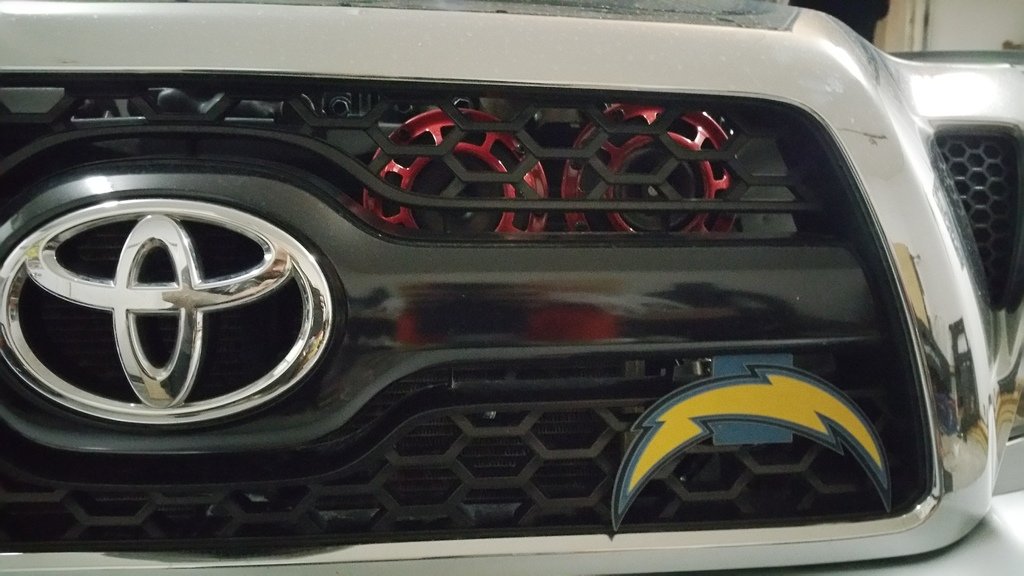

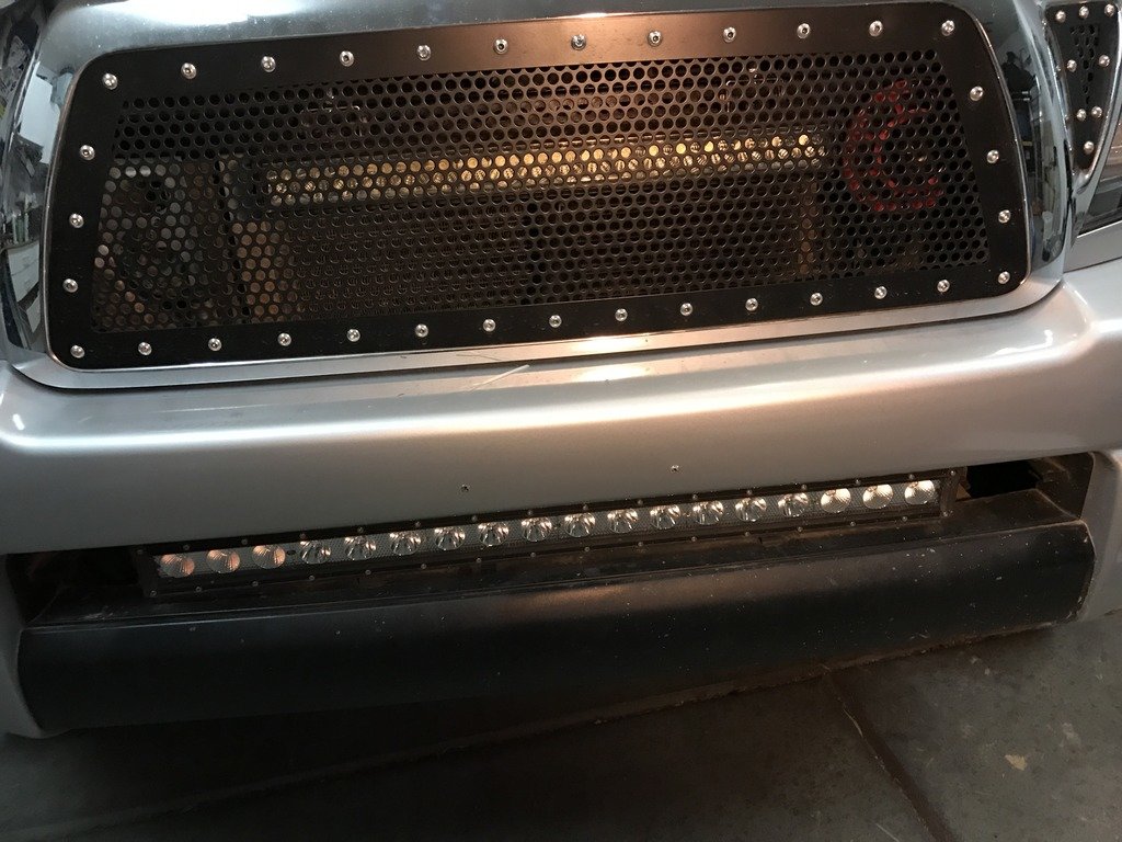

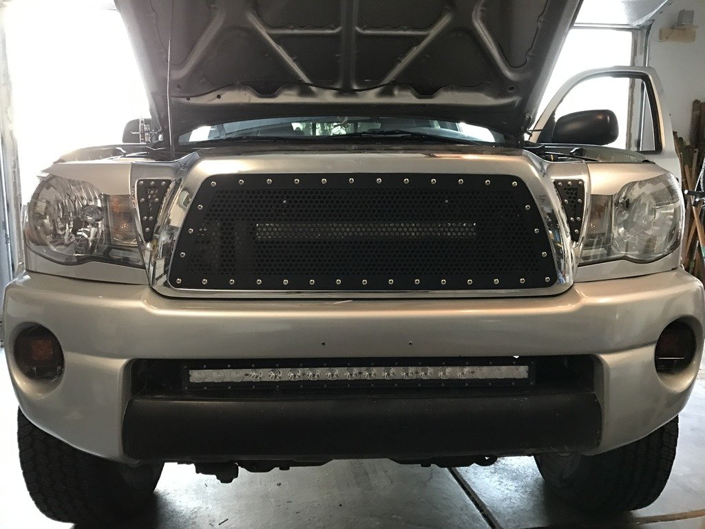

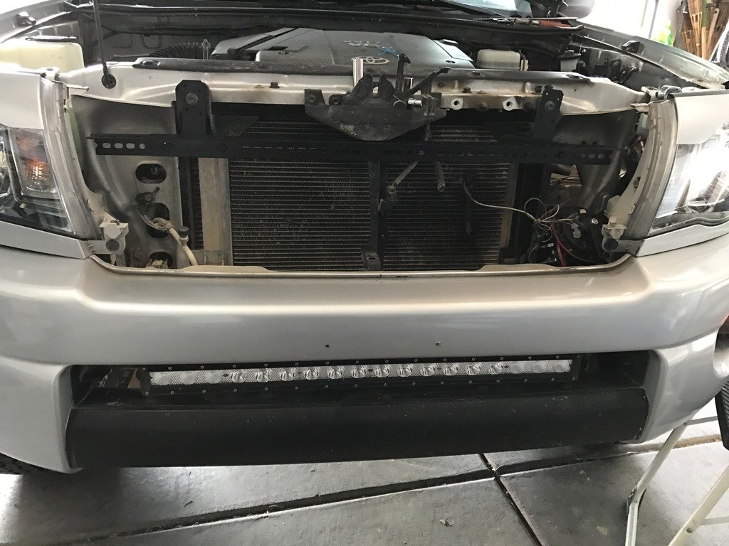

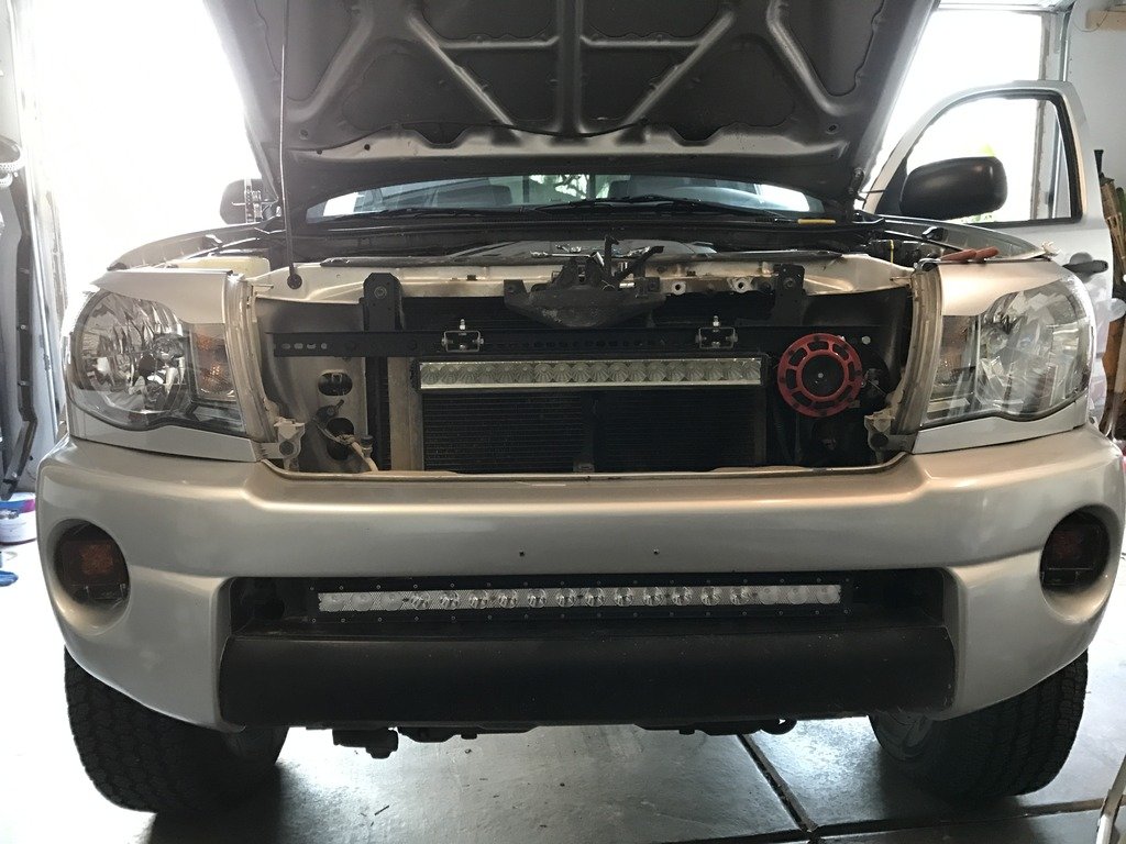

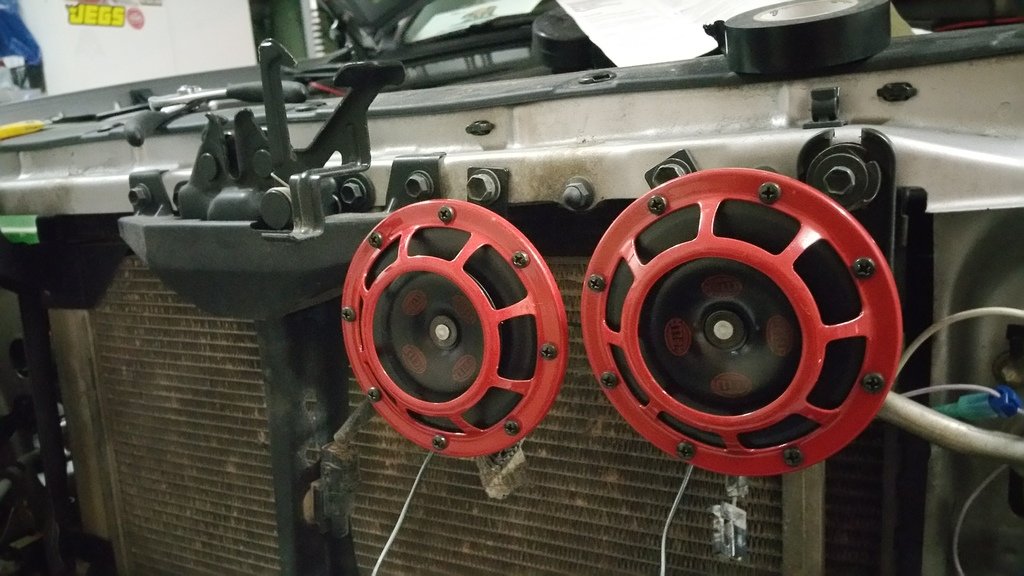

    But where did you move the horns to. I know the factory are small and i put these bad boys in. Did you relocate them?
  18. Feb 19, 2017 at 11:41 PM
    #18
    beetlevegas
    beetlevegas You are no Vader. You are just a child in a mask!
    Feb 17, 2016
    #178529
    1,354
    JP
    Las Vegas NV
    2011 silver Tacoma TRD 6 Speed double cab
    stuff
    I went ahead and got my truck done. Thanks for the info. I mounted the horns on the rail it self. One on front and one on the back.
