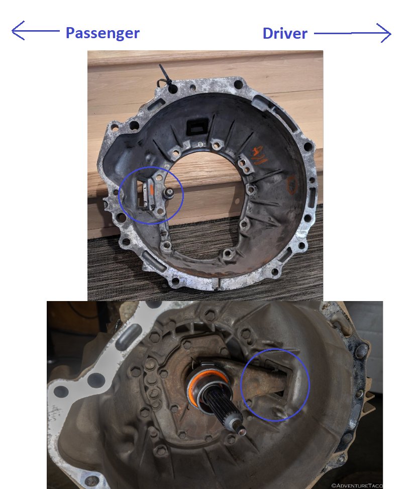

    @Gen1andDone shoot sorry you are correct I was looking at it upside down.
    Here's a better comparison. It is the slave that is on the passenger side on the one I received vs. the drivers side on my truck.

    @Bivouac looks like the lengths are different so its a no go, if I wanted to re-route the slave.
    6 1/4" (bellhousing I received)
    7 1/2" (Bellhousing on my truck)

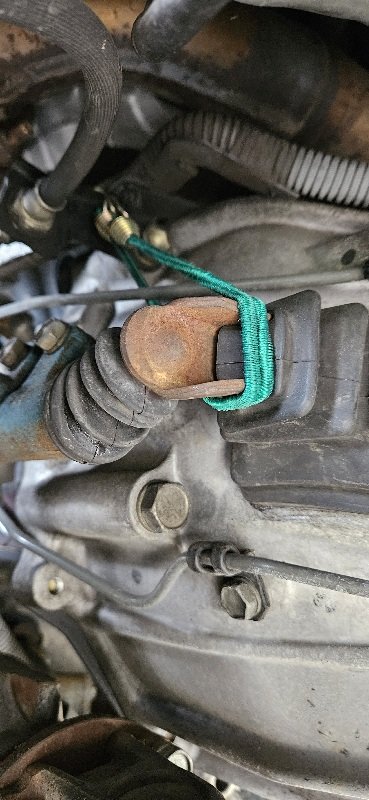

    Haha, I wasn't going to say anything out embarrassment but since you posted that I can see that I'm not alone. I also had rigged mine after discovering the break, not as elaborate as yours though. I simply gave the clutch fork some upward support using a small bungee cord. Mind you, this Tacoma isn't my only vehicle, but it went from having to force it into gears, or from a stop, having to shut the truck off to get it in gear, to now being able to actually shift through the gears without much fuss. Maybe I'll post a photo in your thread sometime.

    Oh dang a bungee cord actually makes a lot of sense, I like it! I figured if you own an old vehicle you gotta get a little creative sometimes.

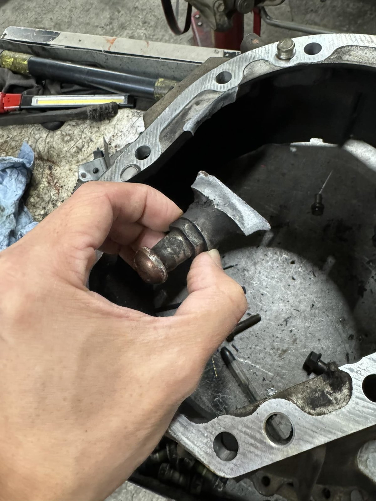

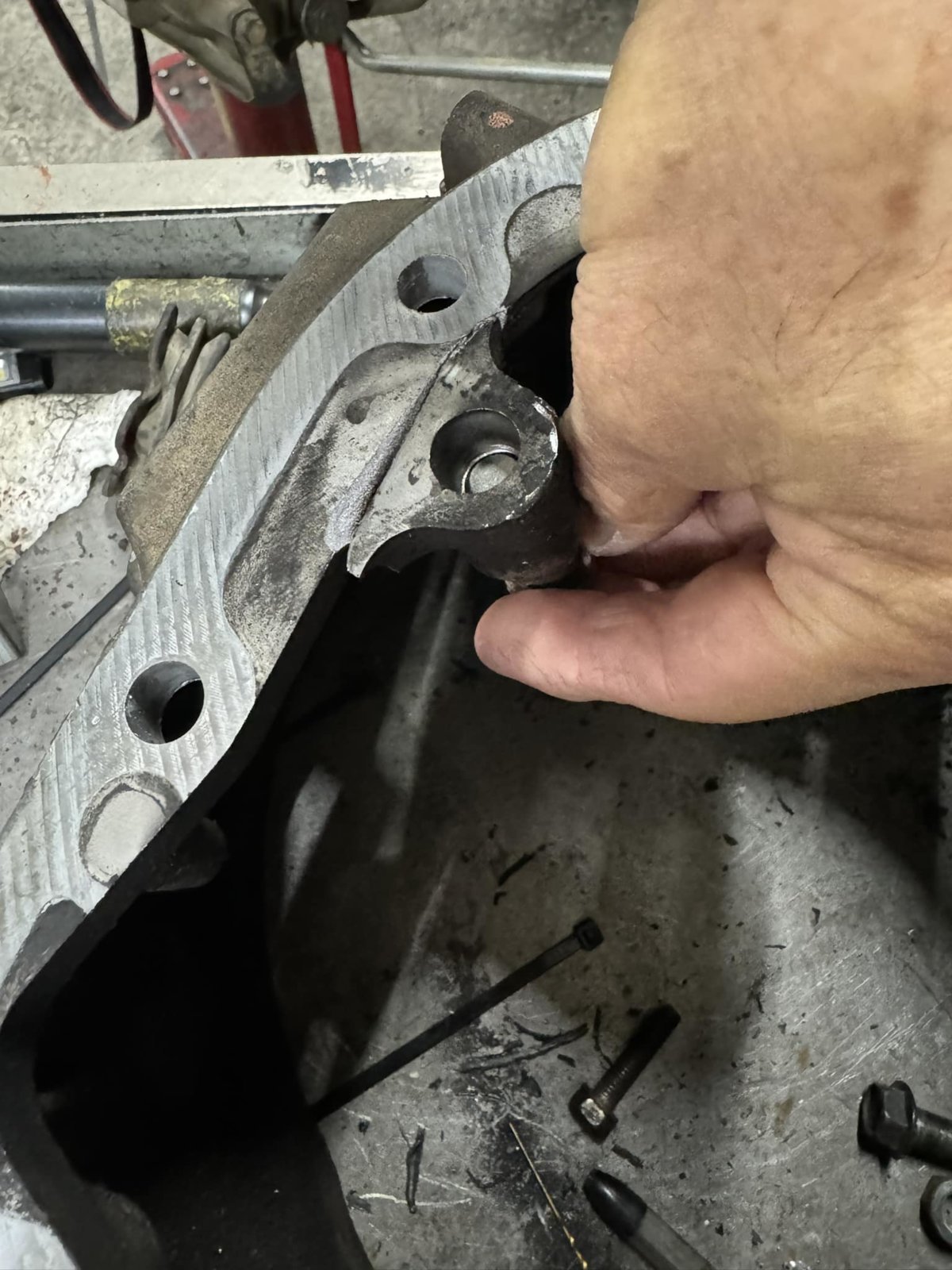

    Hey everyone, well good news to report I finally got the right bell housing in my hands and got the job done! Thanks again for the help here.
    Pretty much the same crack pattern as other posters.
    @chebosto I went in and did the clutch and cylinders too, so much lighter. Interesting theory about the heavy duty pressure plate. Got me thinking about what caused mine..
    Only thing that stuck out was I bought the truck without a rubber boot on the clutch fork. There was almost no grease under the fork pivot when I took it apart, so maybe dirt and debris got in there and just added unnecessary friction to that pivot. Over time causing cracks in the casting.
