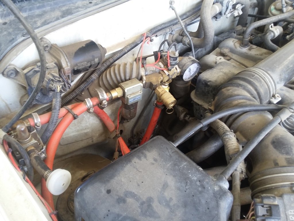

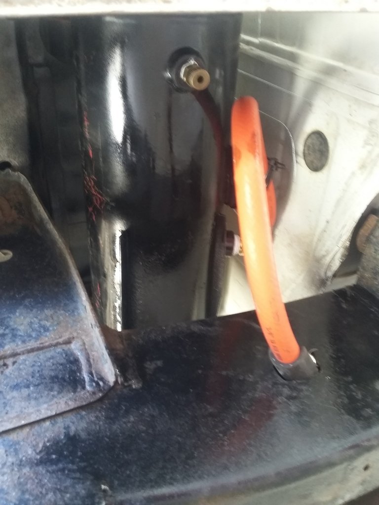

    Here's a couple pics of my set up run off the stock ac compressor on my 1st gen. Just added the tank so haven't seen how it changed things, but without the tank it pumped up tires in no time
    20160412_141226_96d0e0c71632d11c83af09039eaf16b38d6f7274.jpg 20160412_141159_fcbb1509894f5f8b0e70404a0ef3d04ee7dabb8a.jpg

    Seems pretty straight forward: in line oiler, with input air filter, filter on the output. Does the drip oiler continue dripping when the compressor isn't running? How did you connect to the compressor itself? cut aluminum tubes with barbed fittings? Did you wire the compressor clutch to a separate switch? What motor are we looking at?
