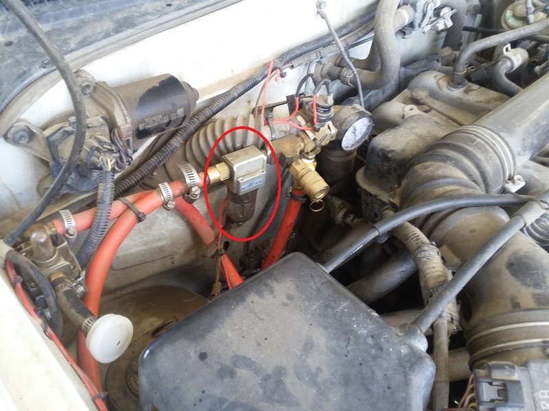

    No, the oiler only drips when there's air movement through it. To connect to ac compressor I simply cut the factory rubber lines and used barbed fittings to connect new hoses to them. Yes I wired the clutch to a simple toggle switch then wired a pressure switch in line with that. The engine is a 3rz (2.7l) in a first gen taco.

    This whole thread is a fantastic write up. I'm sick of my crappy 12v compressors always failing and leaving me without lockers and air. Vern650, my A/C has been leaking for years and I've never fixed it or recharged it, so I'm committing to no A/C and converting it to air. I'll have to use a drip oiler like you've used; Do you have a write up or list of resources for your conversion? TIA!

    No, I never did a write up I watched some youtube vids and just winged it. It's pretty straight forward though. It pretty much goes intake filter, drip oiler, hose to inlet side of compressor, then hose out of compressor to checkvalve, then oil separator, and home made manifold. Manifold contains gauge, pressure switch, pressure relief valve and air chuck. Then I just wired a simple toggle switch to the compressor clutch with the pressure switch inline.

    That's pretty much exactly what I was planning. Do you have to manually drain your separator or does it automatically recycle the oil? What type of separator did you use?

    Mine you have to drain manually. As I wasn't sure how it would all workout, I just bought a cheap harbor freight separator

    That's this guy, right?
