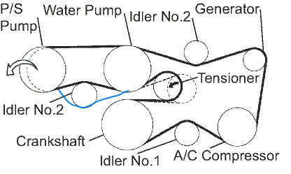

    I changed my belt the other day and installed the bottom passenger side most idler pulley on the wrong side. Instant belt eating, there was a strip torn off on the engine side. It's really easy to get that pulley on the wrong side. It's got slightly less tension that way that's not that noticeable. Anyway I have a Continental Belt from Autozone, 3 year warranty so they swapped it for free.
    Side note: the first Continental was from Mexico that squeaked. I took that back and the gave me a "made in Germany" belt and wow the quality was night and day. I installed that one wrong and it got instantly eaten. Took it back and they gave me another made it mexico one. We'll see how long this one lasts
  13. Nov 4, 2023 at 12:46 PM
    SlimeInnaTaco
    SlimeInnaTaco [OP] Active Member
    Dec 25, 2022
    #413975
    40
    2012 AC LB 4x4 Sr5
    How did you install the belt wrong? There not directional no? I’m gonna swap my idle pulleys to see if that helps
  14. Nov 4, 2023 at 1:07 PM
    RockfordTaco2006
    RockfordTaco2006 Well-Known Member
    Dec 12, 2022
    #412888
    436
    Alexander
    2006 Toyota Tacoma TRD Off Road 4x4
    2 Inch Lift
    Idler No.2 next to the power steering pump was on the wrong side. I had it under instead of over the top.
    Thought I had it set correct, fired it up and something was wrong. Shut it off quickly
    I looked and that's the one I had wrong. Feeling the belt confirmed the wrong side of the belt was riding on the pulley.
    I took the belt off and got all the strands out from around the pulley's.
    I spun all my pulley's quite a few times and confirmed they were fine. It's good to swap them anyway....
    after reading your "torn on engine side" I thought I chime in with my experience.
    Good Luck!

    I did the same thing . Mine lasted 10000 miles though. OP did problem happen after you replaced belt ?

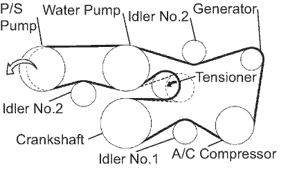

    Double check belt doesnt run like the blue line under idler 2 between PS pump and WP. I did lol. My excuse is I replaced belt from under truck :D
