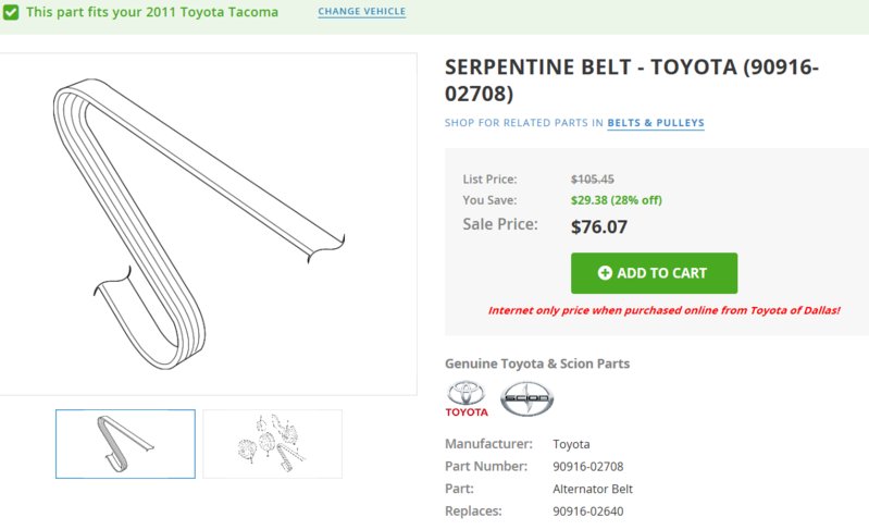

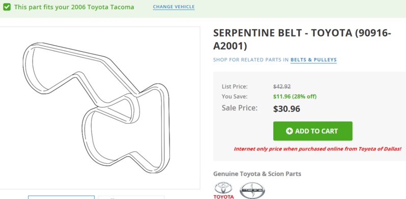

    $18 is a deal, list price is $43.
    Serpentine belt for my 2011 lists at $106
    Black97v6MT likes this.
