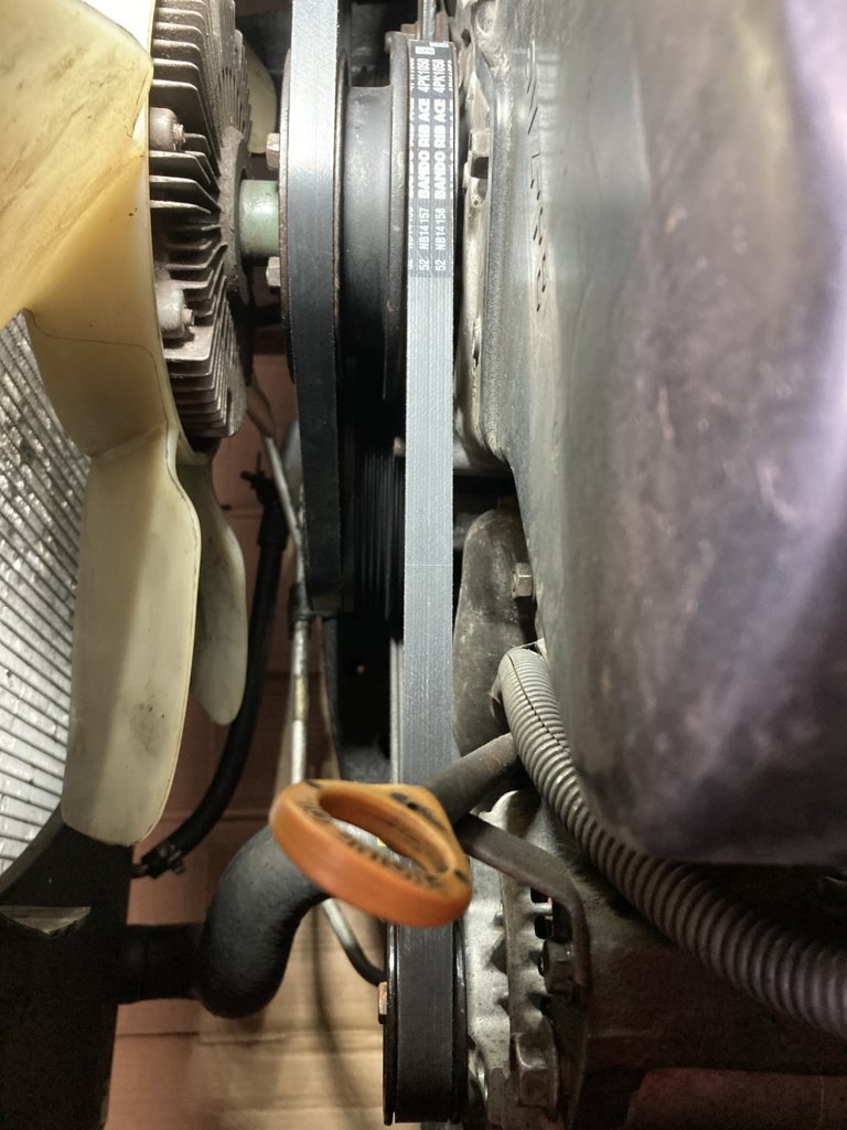

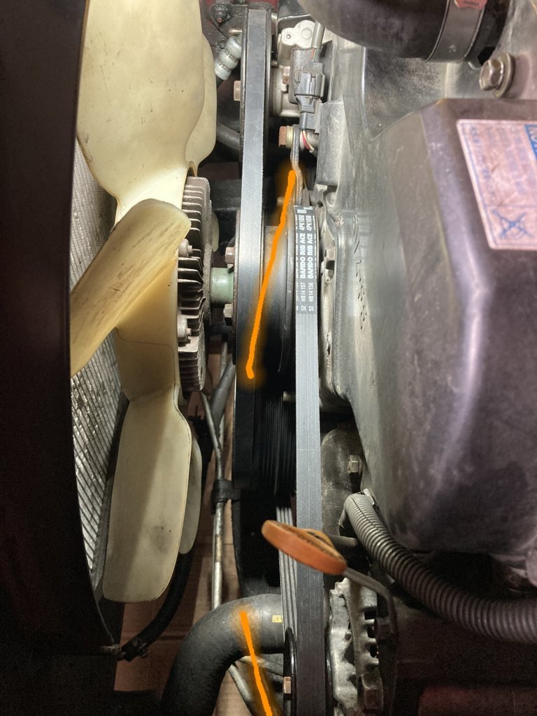

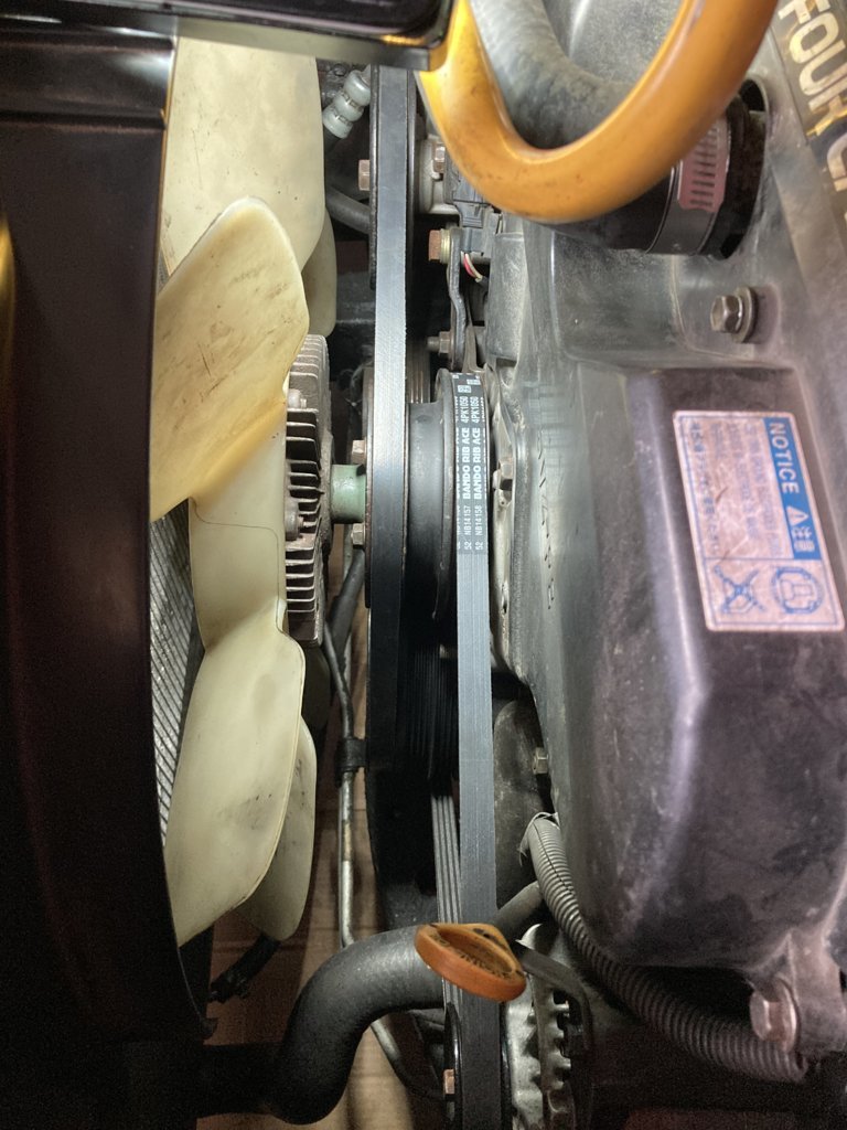

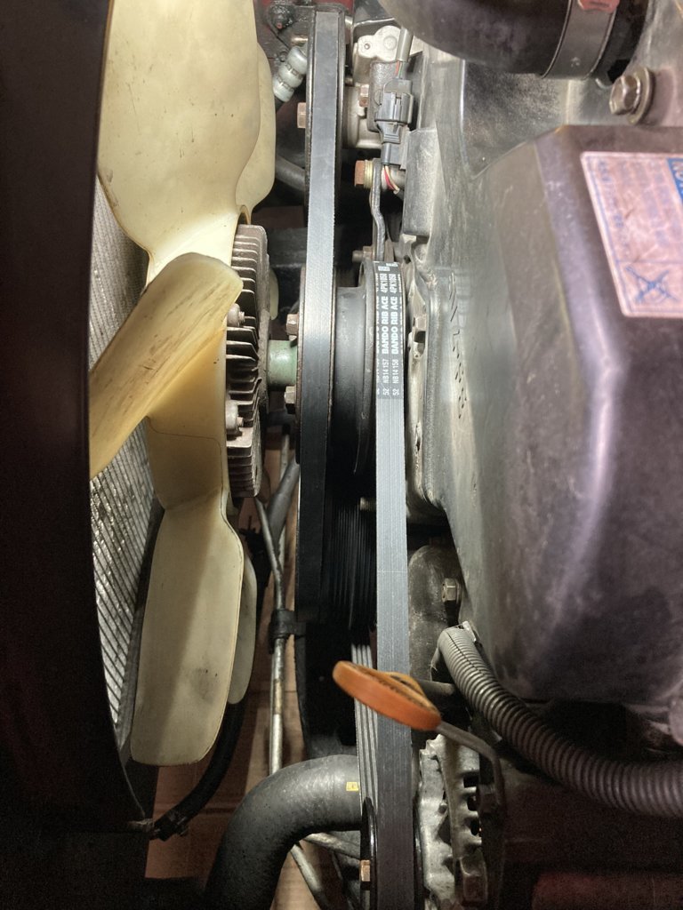

    I did take some pics of the pulleys. I’m not sure what good that will do, but I’ll post them. My ps pulley is new used. Alt is about 1yr young. I have cleaned up the fan pulley, however that may be the weak spot especially now with all the others being new-ish…. The fan pulley bracket/bearing seemed fine.

    Ya. I get it.
    When I peeked in yesterday the comments about snug but not loose, didn't seem sufficient.
    It could be the belt and pulley. New parts aren't always correct.
    i.e. new belt could be just enough wider to cause issues.
    Things swell as the heat up and contract when cool.
    To me, it makes sense that it quits after it's warm.....If the belt was loose.
    Could be the skew of the photo but does the alternator pulley look out of line with the fan?
