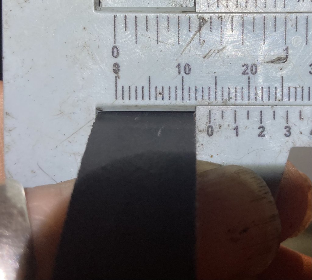

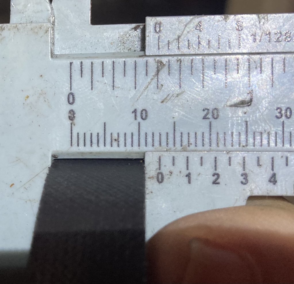

    I don’t know if this was the problem as I have not yet installed the new one….
    These are taken from different spots on the one that was installed.

    This is the new, yet to be installed, belt width

    kind of hard to determine if a belt is tight enough from the inter tube....

    So there was a little squeak on startup, so it needs a pinch of tightening. VERY happy to report though, that there’s no slippage! Thank you all! Who’d’a thunk it was all due to a one mm manufacturer’s defect….
