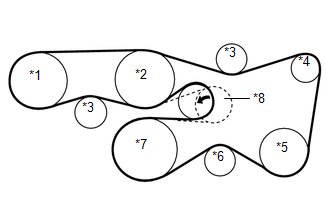

    Hi welcome tacomaworld I have 2019 Tacoma 4x4 trd sport that is squealing when idling up to 2-3k rpms after off roading last weekend, I had taken it in the very next day to dealer to find out that the belt tensioner assemble became misaligned after wear and tear. After finding out about the issue the dealer had replaced it under warranty, but it seem after the service my 3rd gen still continues to squeal at a lower pace still while accelerating in higher rpms orrolling in drive. Any solutions or thoughts ?!

    Crazy, but I’ve seen this happen, check and make sure the belt is routed right.
    They may have put the belt on wrong when putting it back on. The ribbed ends should not be in contact with any idler pulley. But if it slips off and you don’t catch it they’ll work. But squeal.
