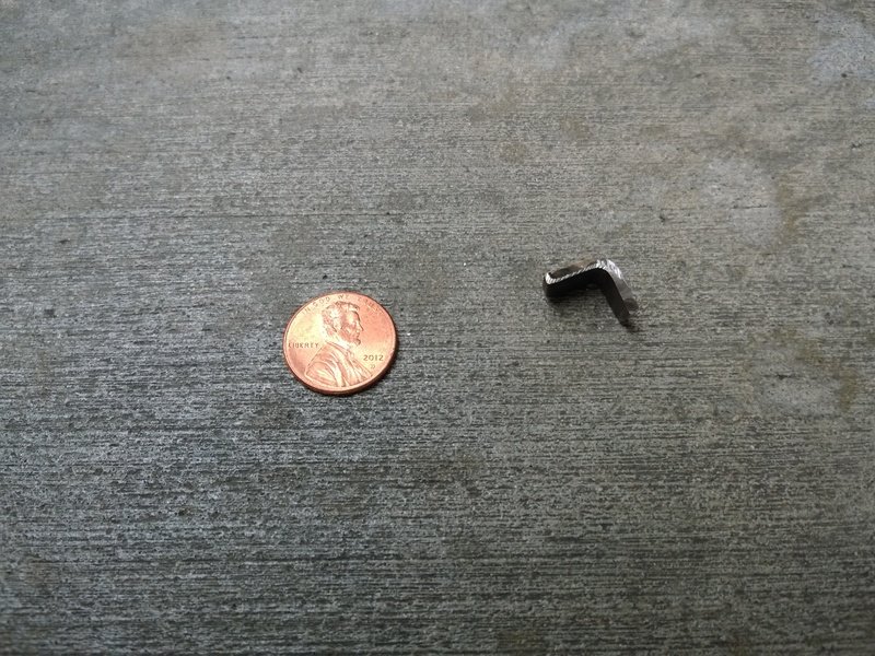

    From my observations, the ratcheting mechanism inside the bench seat is similar to any regular automotive seat that can recline. The only thing different is that its movement is limited by the stops. The amount of set positions depends on how far forward your seat is and how much material you cut.
    Below is a pic of how much metal i took off. I'd say it's less than 1/8'' of material that was cut off with a dremel.

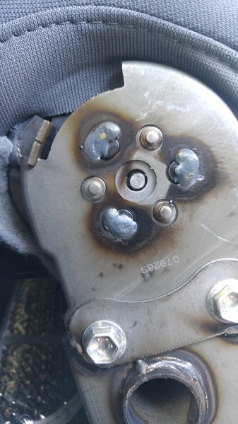

    I'm new to automotive threads but when I searched "tacoma bench seat reclining" today I stumbled across this thread. And I'm so happy I did. With a screw driver, dremel, and metal cutting disk I added an additional reclining position to my '08 Tacoma in a matter of minutes. Seriously... No more than 10 minutes max and that includes setting up. The mod worked perfectly and the skill level required to complete is basically zero. Here are some pics of my mod I'd like to share.20160923_154924.jpg Above is the factory locking position with the slot I cut out and below is the moded picking position.
    It doesn't look like much but it reclined the headrest back a couple of inches which is perfect for me. Great suggestion and so glad I decided to give it a try.
