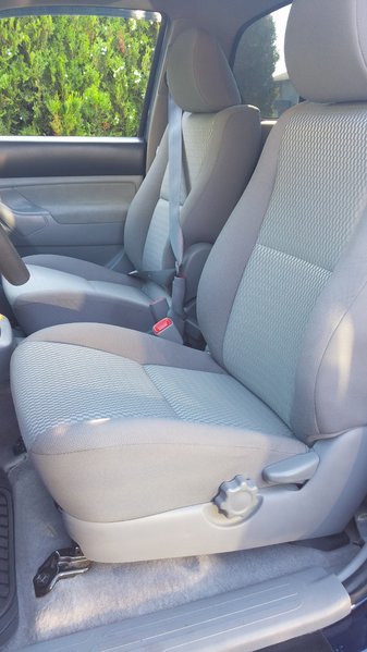

    I replaced the bench on my 06 with buckets from a 2014 access cab. I removed the whole wiring harness from the bench (real pain the ass) and also transferred the weight sensor from the passenger side of the bench to the passenger bucket seat. Seats bolted right in as the 4 additional holes needed were already pre-drilled on the floor. I do not have a console but I do not mind. All airbags work perfectly fine.0723161058_HDR.jpg 0723161754.jpg
