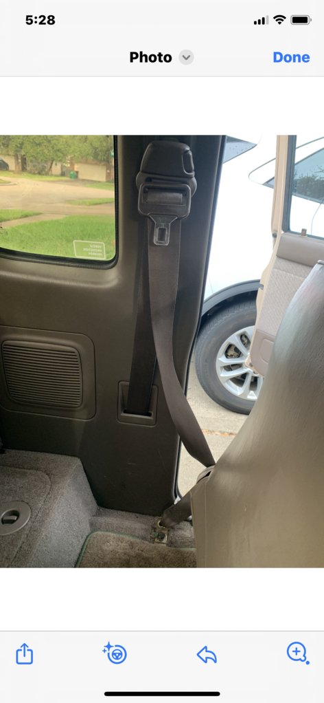

    98 buckets single cab belt connector:

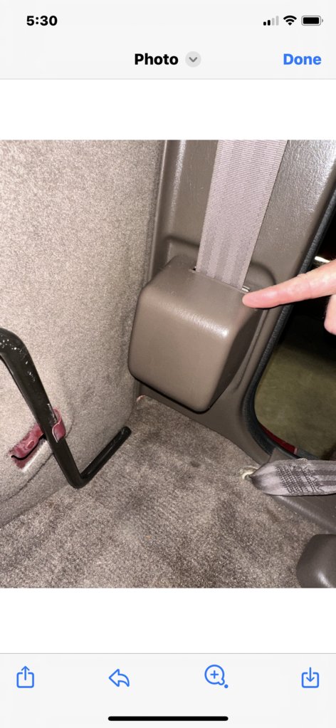

    96 Xtra cab 60/40 bench:

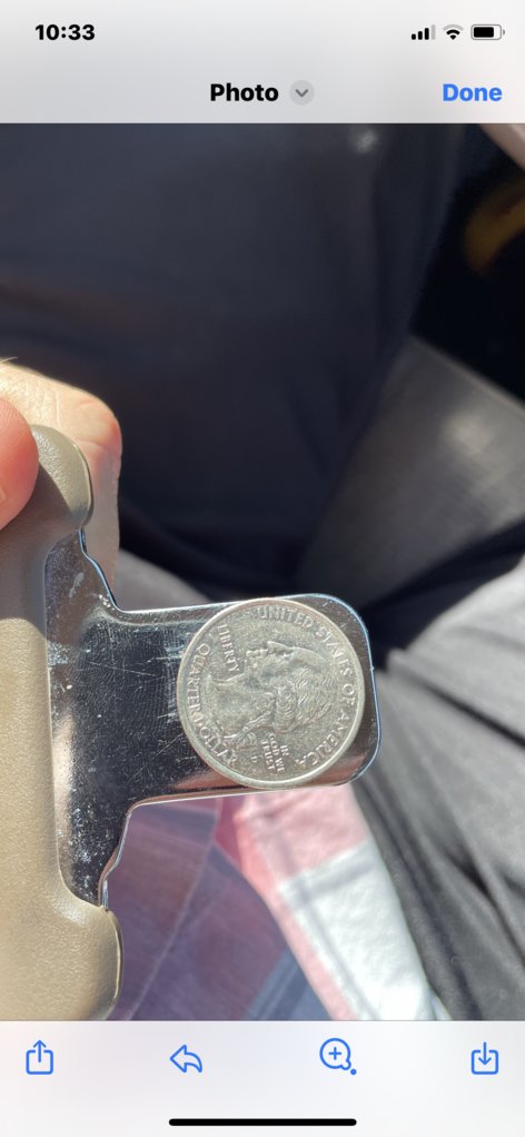

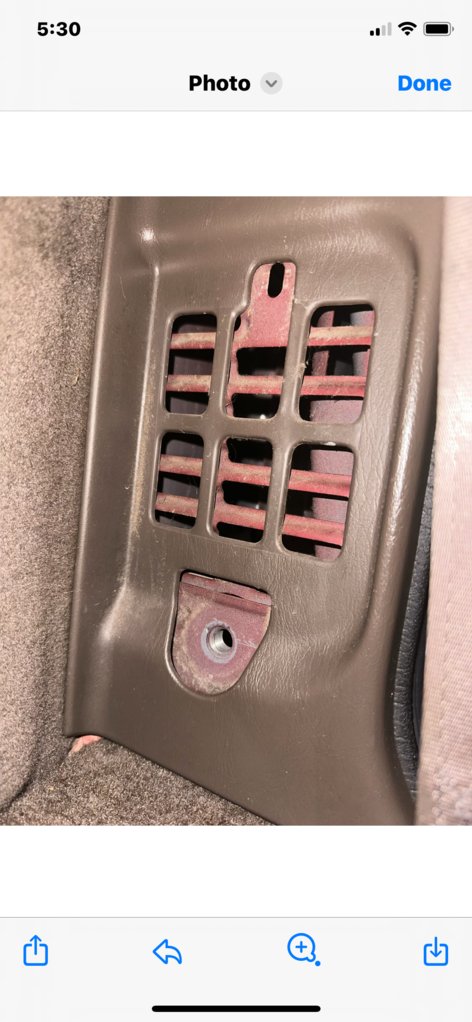

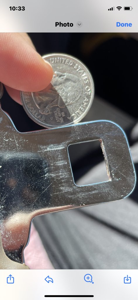

    Alright TW
    The swap happens on Friday
    almost didn’t happen
    Belt swap (single to Xtra cab)not doable without some major modifications(to body/belt/inverting belt sides)
    Too much to a safety item to “try” to fit
    Just to explain…..
  6. Sep 4, 2024 at 3:30 PM
    #26
    ControlCar
    ControlCar [OP] My Moto: Help & Learn…period.
    Jul 22, 2023
    #429578
    3,152
    Steven
    Sugar Land TX
    1996 Taco 2.4L 2wd Automatic
    Clock Volt meter/LSPV Delete/Hyundai 16’s/FP gauge/after 9months of wrenching ZERO oil leaks
    Xtra cab belt mounts:
  7. Sep 4, 2024 at 3:31 PM
    #27
    ControlCar
    Jul 22, 2023
    #429578
    3,152
    Steven
    Sugar Land TX
    Single cab belt mounts:

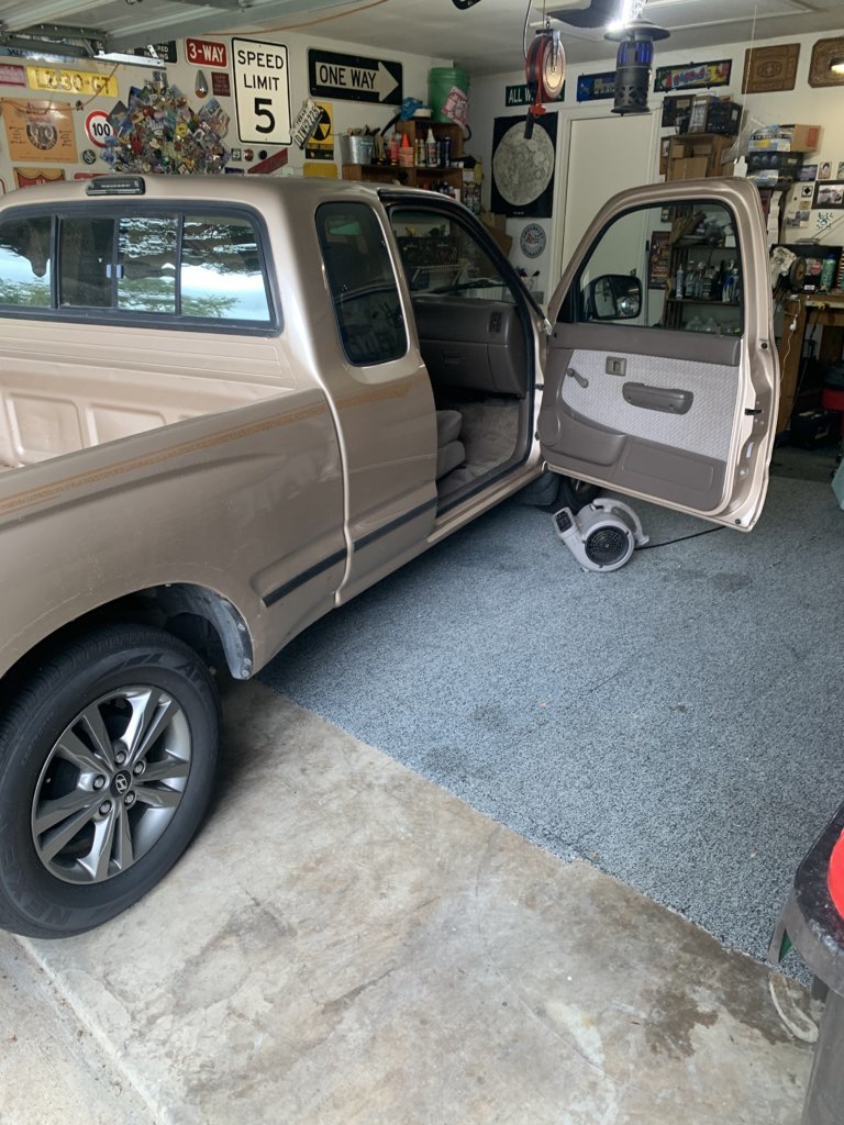

    Brett’s Single cab:

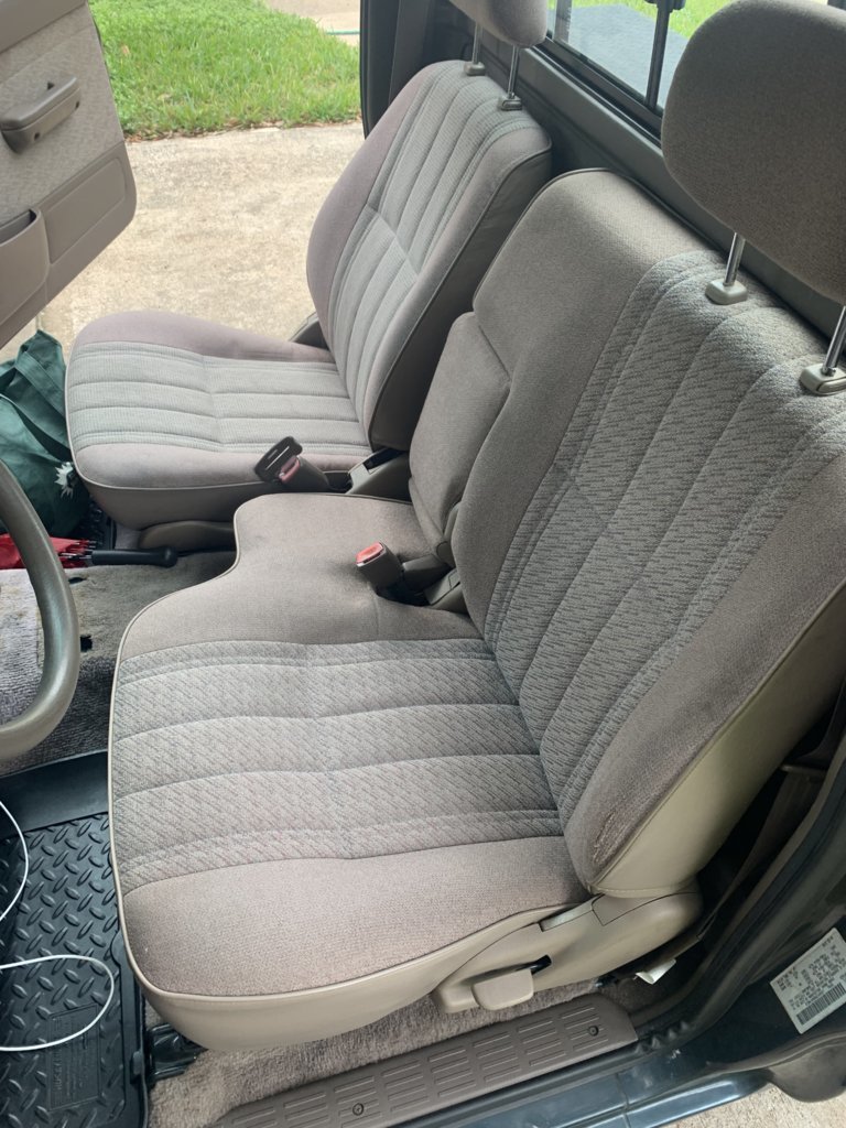

  13. Sep 6, 2024 at 8:00 PM
    #33
    ControlCar
    Jul 22, 2023
    #429578
    3,152
    Steven
    Sugar Land TX
    the 15yr old approves!
    He Checked results out today
    He really likes the center console
    Brett is pretty much more knowledgeable than myself with Tacos
    Was pretty easy/fast install with his expertise
  14. Sep 12, 2024 at 7:42 AM
    #34
    bretts
    bretts Well-Known Member
    May 6, 2013
    #103633
    352
    Pasadena, TX
    98 Tacoma Regular Cab 2WD
    Honestly the hardest part of this swap was mounting the center console due to the floor pans being different. The seat swap went pretty quick!
    Glad everything worked out for us. :)

  15. Apr 8, 2025 at 9:48 AM
    #35
    YotaBro
    YotaBro Well-Known Member
    Apr 2, 2022
    #394095
    438
    98 Tacoma

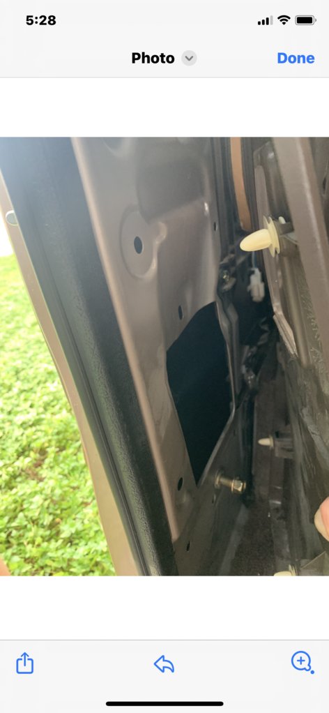

    how did you unclip the side panel in pic 2? mine is rattling around a bit and i don't think its clipped in properly so i'll have to re-seat it
  16. Apr 8, 2025 at 3:51 PM
    #36
    ControlCar
    Jul 22, 2023
    #429578
    3,152
    Steven
    Sugar Land TX
    Man
    During seat swap we decided to leave both of our belts and only swap buckles that bolt to the “swapped” seat frames
    One weird 16mm bolt(each side)
    Then IIRC, bent each buckle just lil bit for great fit
    Saved a crap ton of time
