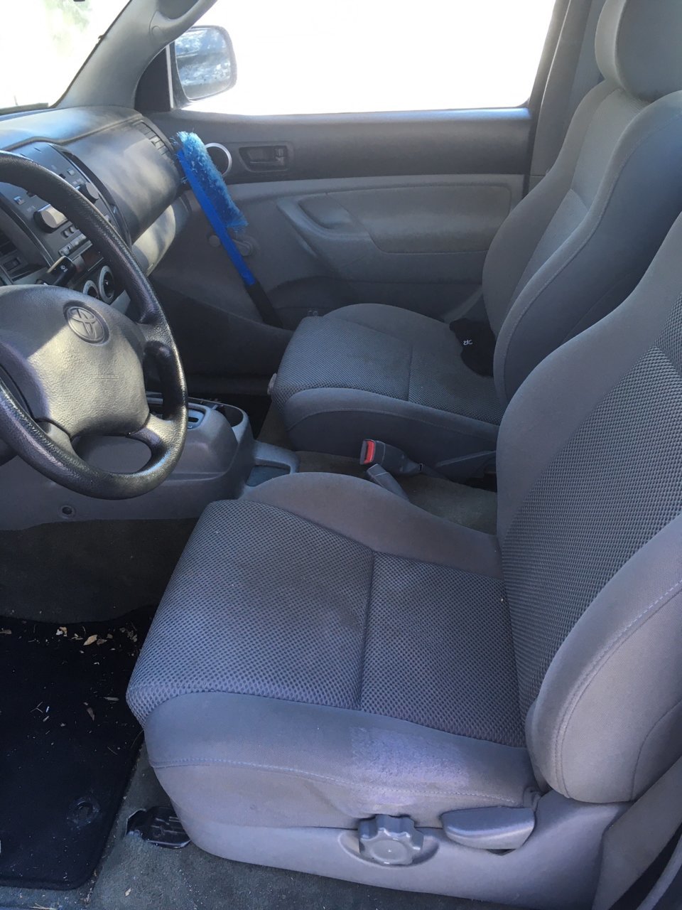

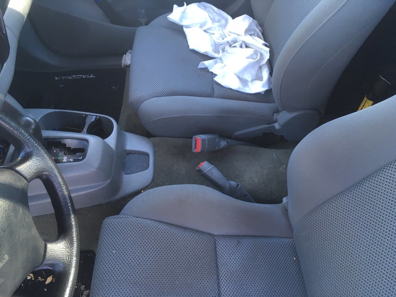

    All new under the floor, factory frame swap. Bucket seat swap. Bilstein 4600 shocks and X Runner rear swaybar. 4:10 DIfferential. 225/60/17 on Sienna 5 spoke alloy wheels. After market black headlights. OE replica fog lights. OE Intermittent wipers plug and play. Leather steering wheel (OE eBay) that came with a cruise stalk, I bought the $38 OE wire to plug into the clock spring, plug and play.
    I'm just in the beginning this process on my 08 Regular Cab, replaced the bench with by 08/09 (not sure of the year) buckets. No airbags on either seat but sensors for both that I do not have worked out yet.
    The existing bench seat belts do work with the buckets, just leave them bolted in the same hole they are in, the seat mount uses a different hole just behind where the buckles bolt down. The child seat restraint belt/latch has to be removed from the bench buckles. I will have to modify the long plastic covers on the receptacles also. My seats did not come with any belt receptacles so I had no choice.
    No need to make brackets, all the correct peg holes and threaded holes on the floor are present on a bench seat truck, some are just unused until you swap to buckets.
    You can use bench seat belts when you swap to buckets also though you will have to get rid of the center/child seat belts.
    I swapped to buckets, used the bench belts and retained the bench console, it all works fine though the passenger seat fore/aft movement is limited by the bench console. I put in new carpet at the same time so there will be some unwanted slits in the center behind the console if you go with the OEM carpet.
