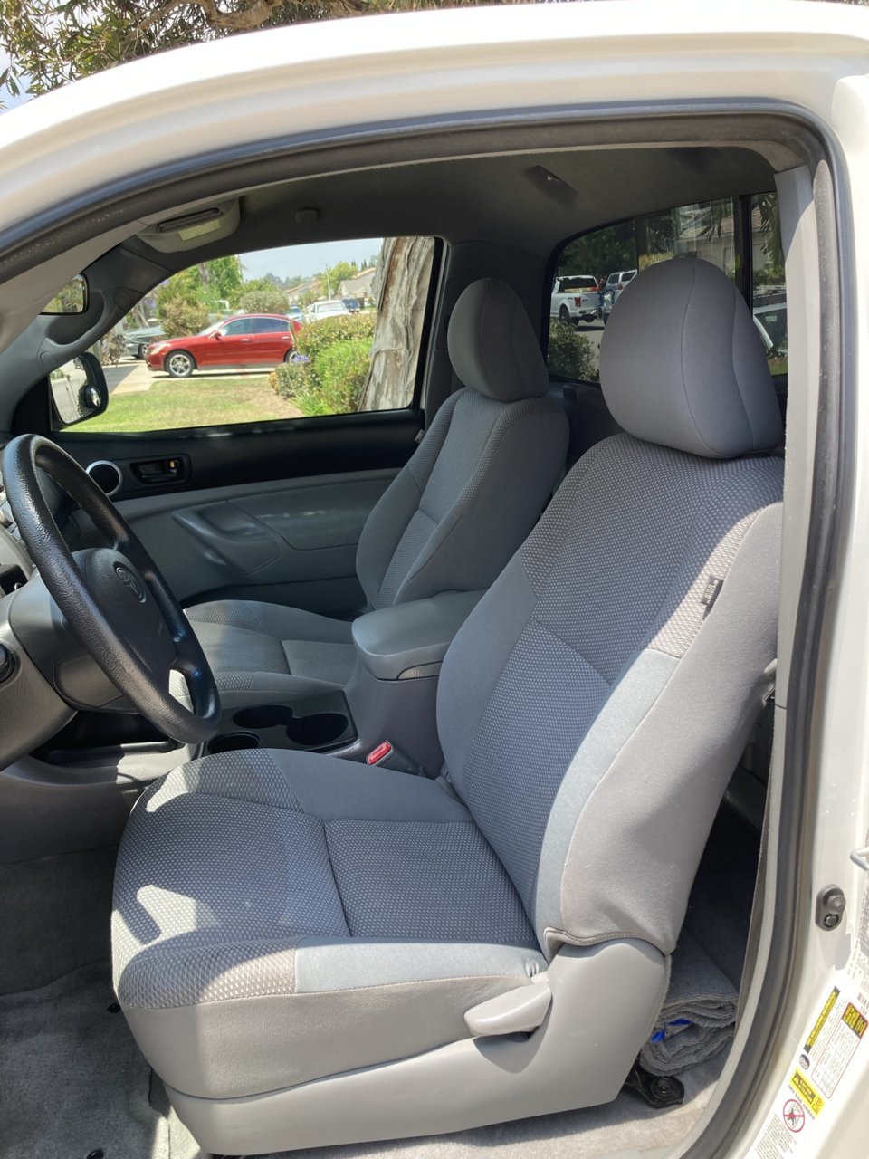

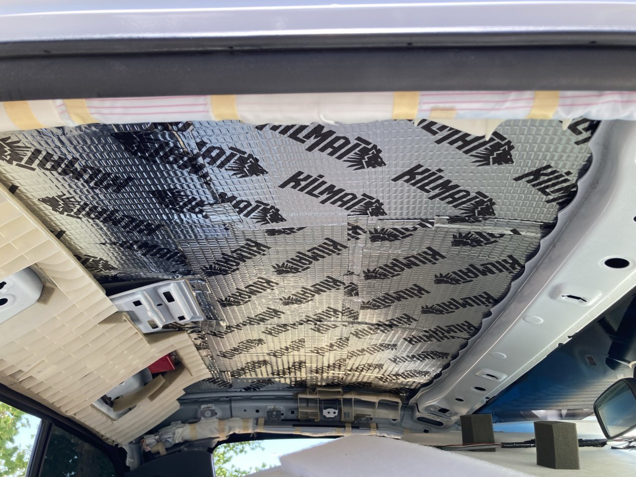

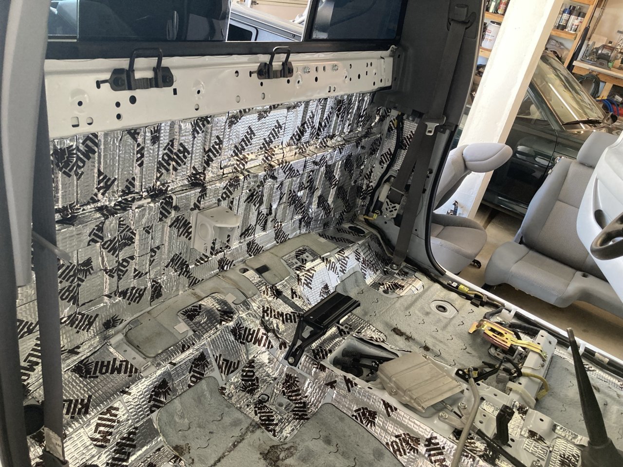

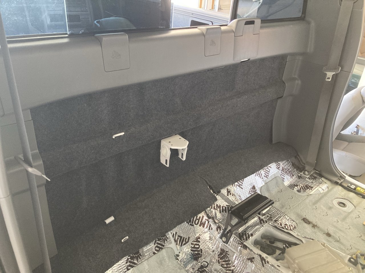

    I just completed this swap in my 2009 Regular Cab PreRunner. I purchased 2012 buckets with airbags and followed the detailed directions to the letter. Came out perfect, no airbag lights, and the seat sensor pad swap into the passenger bucket works as it should.
    While I had everything out, I sound deadened the cab and headliner with 80mil Kilmat. Next step will be installing Kilmat in the doors when I install my new speakers and tint the windows.
    Thanks again to the original poster!
