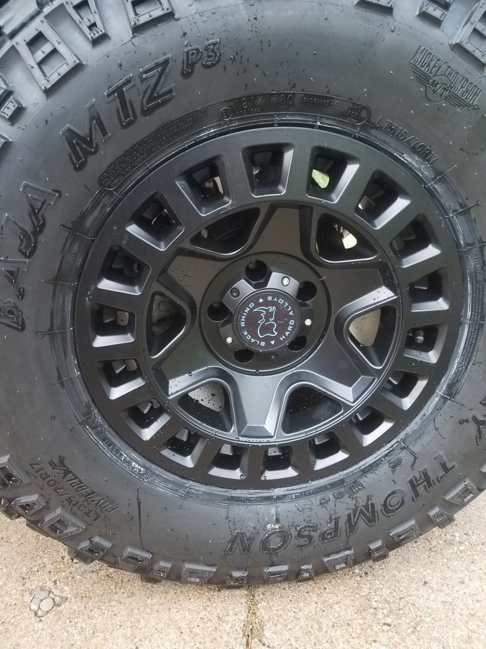

    tacotoe
    tacotoe Pastry Chef
    Nov 25, 2007
    #3593
    5,915
    Nebraska
    `17 AC Sport MT
    ARE Topper, Icon aal, OEM Audio+
  6. Dec 21, 2020 at 4:03 PM
    #26
    BuzzardsGottaEat
    BuzzardsGottaEat Well-Known Member
    Apr 27, 2011
    #55669
    8,577
    Some Toyotas
    Round tires
    None whatsoever until you get up to certain 35/37”+ tires.
    Stick with 16s. More rubber than metal is a good thing.
