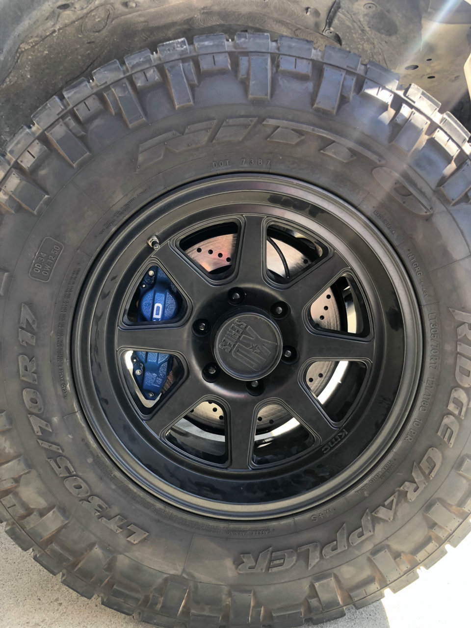

    Im on 305/70/17 with 5th gen 4runner sized rotors and calipers. My truck could hardly stop going downhill (sometimes it didn't at all) before the upgrade. Night and day difference so I'm glad I had 17s. E91D4CDD-2196-48FF-BE52-B9AB64515BCD.jpg

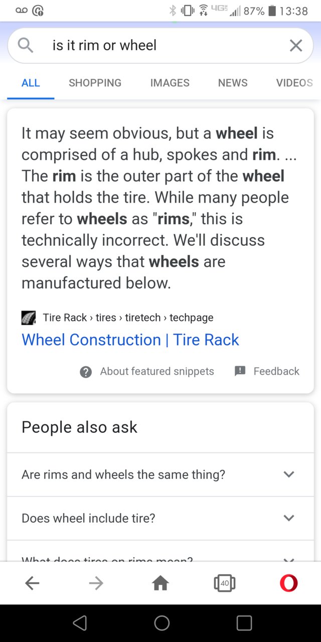

    tire + rim = wheel.
    Careful about mixing terms. Confusion can follow.

    If we want to get the technical, a wheel doesn't necessarily have to have a tire. "Wheel" is a more general term that can apply to just the "metal part", or the "metal part"+the "rubber part".
    Although in casual usage, I most often see people using wheel to mean only the metal part. For example people often say things like "I bought new wheels and tires" and not things like "I replaced the rubber part of my wheels".
    I would also consider the "rim" to be the actual rim of the metal part. In other words, the outer edge of the metal part that holds the rubber part.
