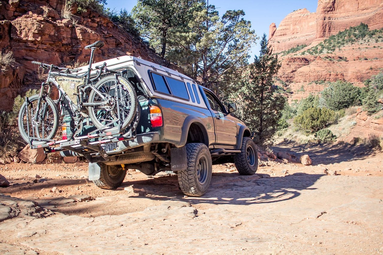

    In Sedona this weekend on our way to Joshua tree for some climbing!

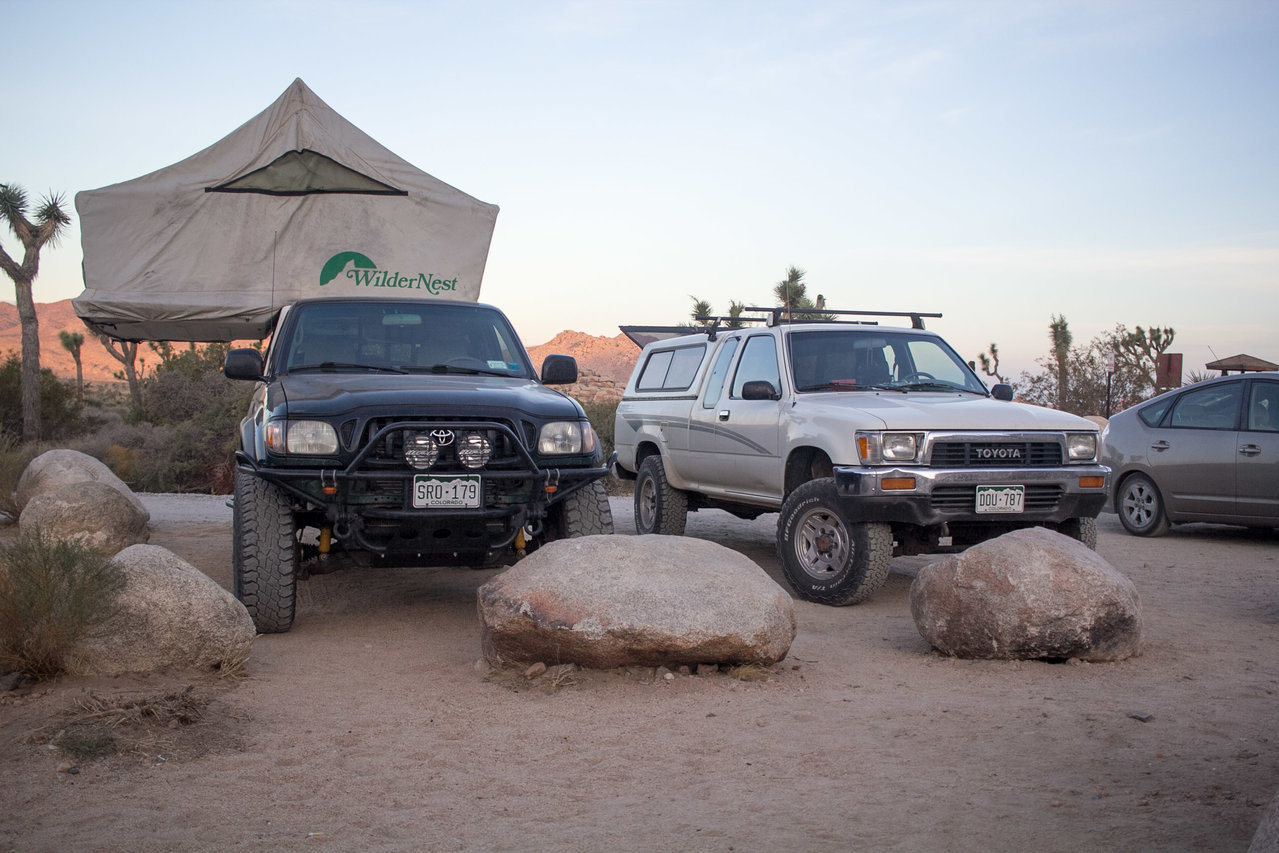

    Joshua Tree and Death Valley for Thanksgiving week.
    Yota Gang at J-Tree:

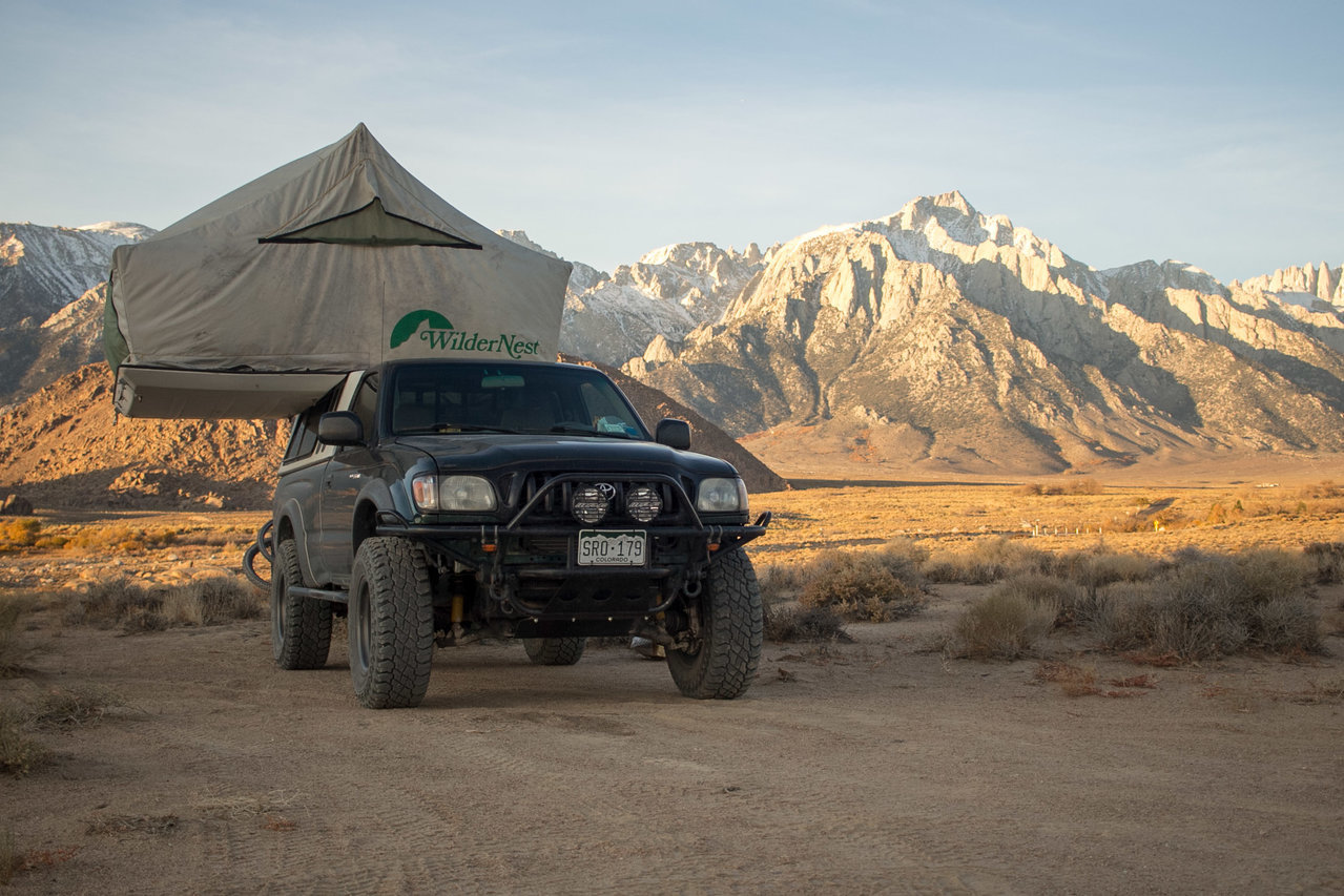

    Alabama Hills in Front of Mount Whitney:

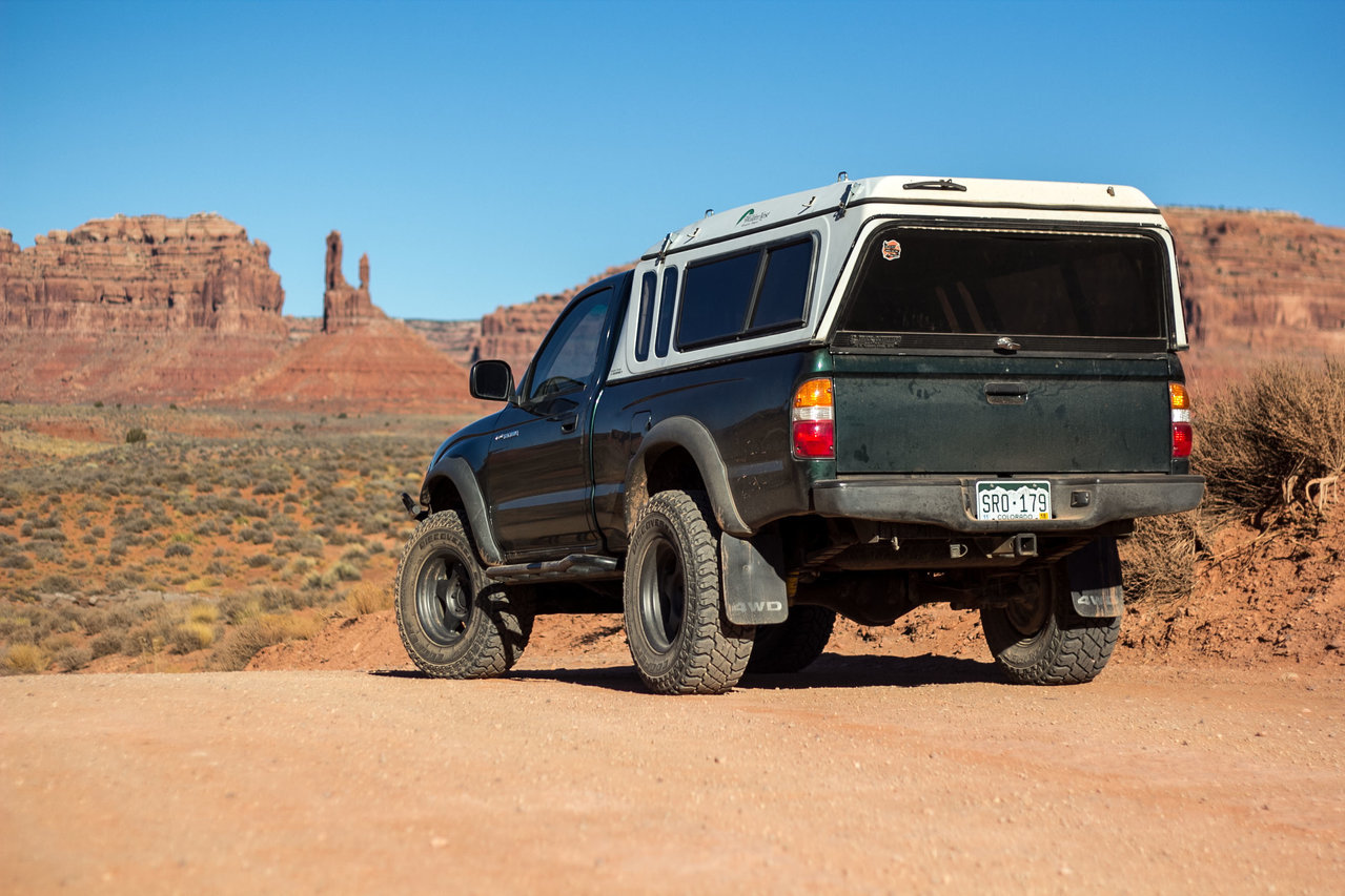

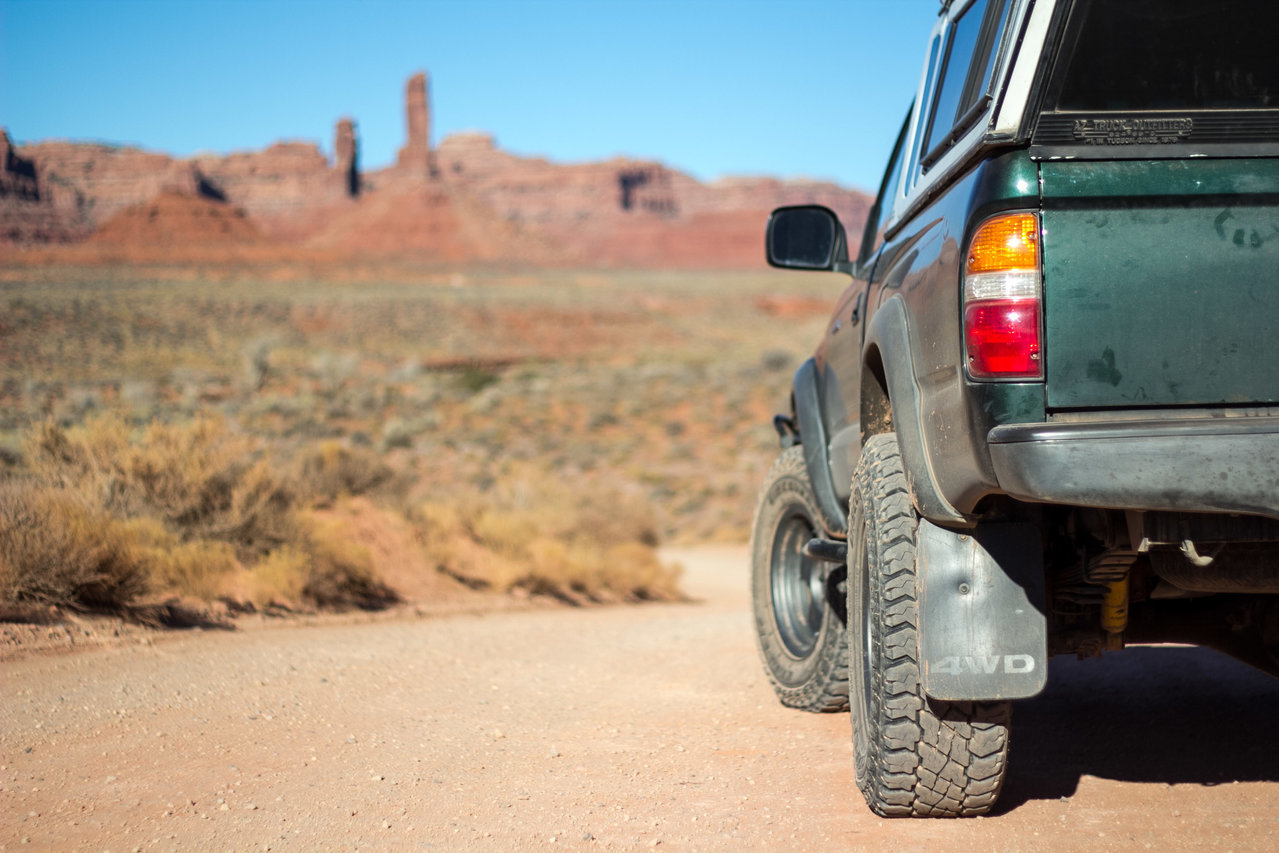

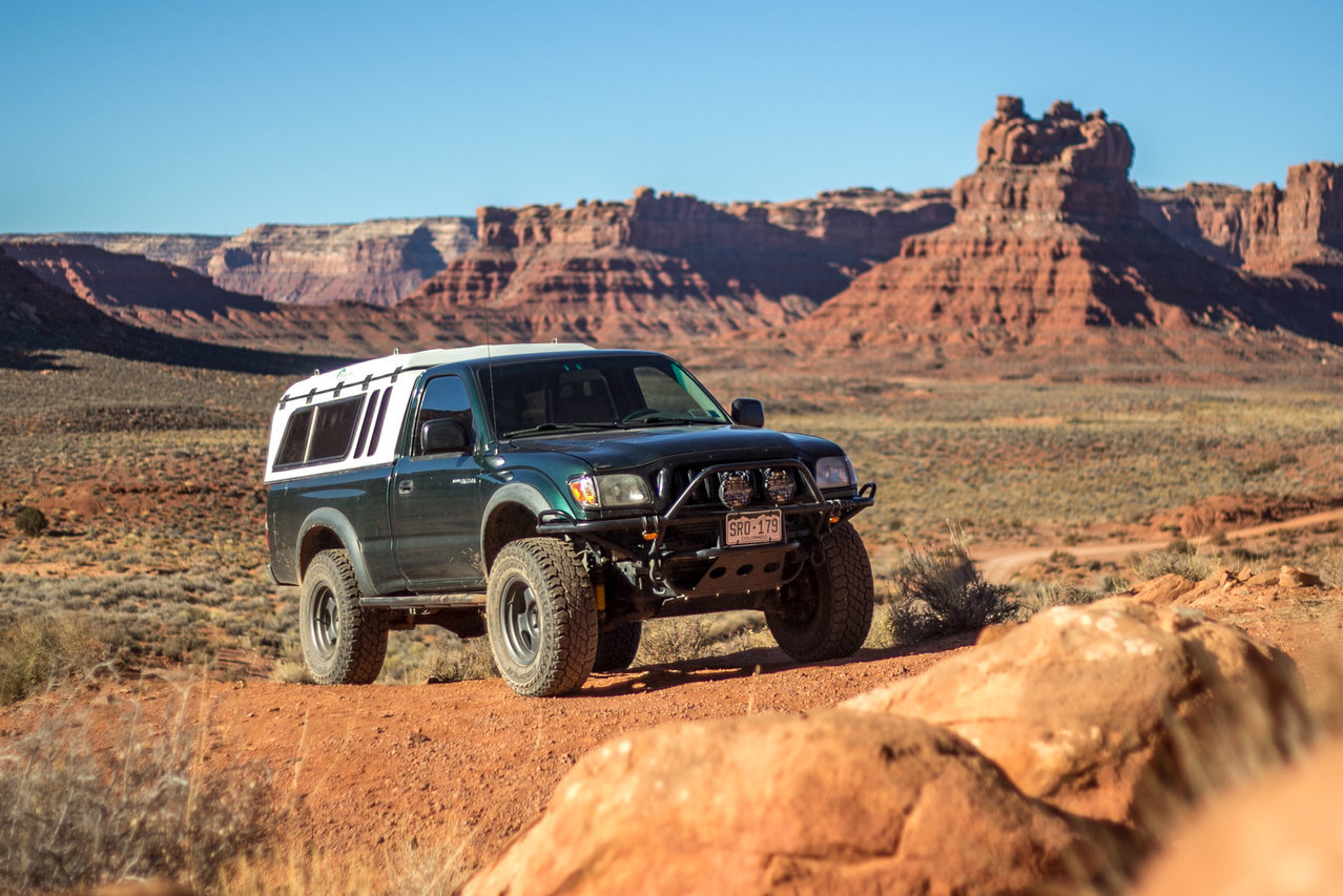

    Valley of the Gods.

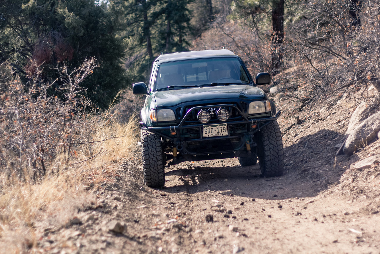

    Took a trip into the mountains today.

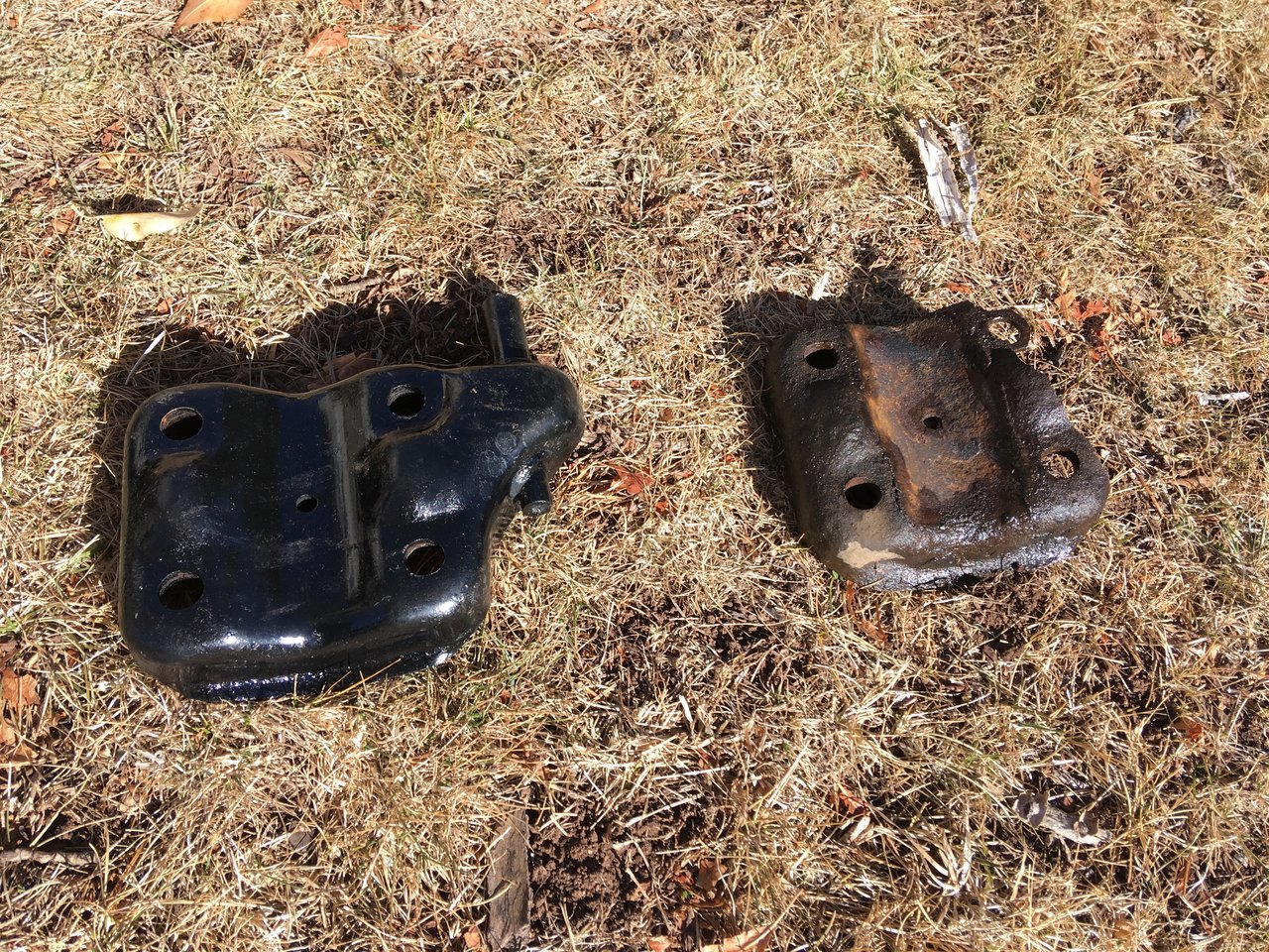

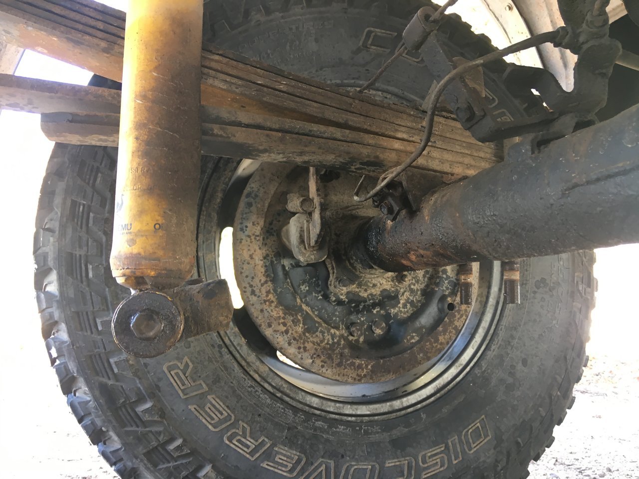

    Had the truck teetering on two wheels coming down some switchbacks on this trail today.
    Broke the rear seat plate. Realized that this is a pretty crucial piece as it is both the shock mount and holds the axle to the suspension. U-bolt flip makes a lot of sense to separate these two functions as well as for clearance/flex.

    What's your plan for a new mount if you do the U bolt flip?
    Ahh, found this. Makes sense

    For now, I just ordered a new seat plate from a junkyard. I figure that's the cheapest and quickest way to get the truck back up and running. I'm pretty sketched out to drive it as the right side of the rear u-bolt isn't holding on to much. A u-bolt flip is definitely in the near future though. It just takes some welding which I don't know how to do and don't have equipment for.

    shitty about the rear shock mount. All the more reason to upgrade!
    Love the wildernest on the single cab. Might have to put mine on one.

    Got the new seat plate on. Here's the new one next to the old part. RUST!
    The 'Nest is heavy. I think I might stick an AAL in the Dakars.

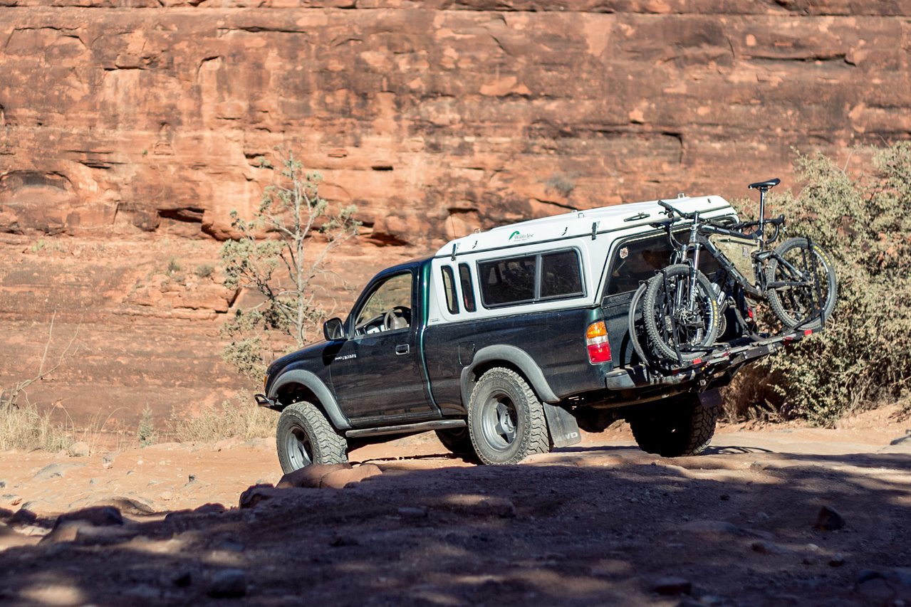

    Moab this weekend! (last time I was in Moab the truck was on a trailer with a broken driveshaft)

    What gear ratio are you running with those 32's?

    I'm not sure what I have but it's stock. It's a bit sluggish around town and very noticeable when trying to pass at highway speeds.
