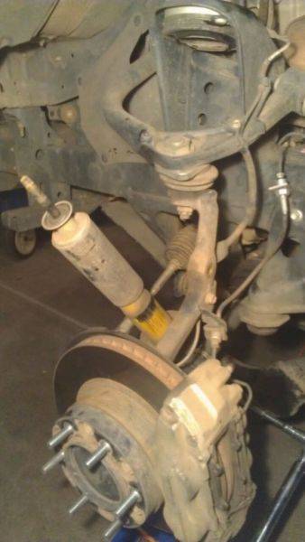

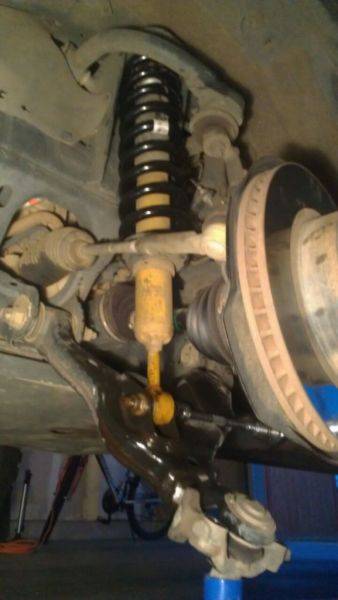

    AAL and 886s installed. The coils raised the front 2", and the CVs are at a pretty high angle, but I think when I add the ARB and they settle-in, it should be a perfect height.
    The D29XL kept the rear at the exact same height as the 1" block, so that's good.
    I was able to change coils w/o removing the shock. :D

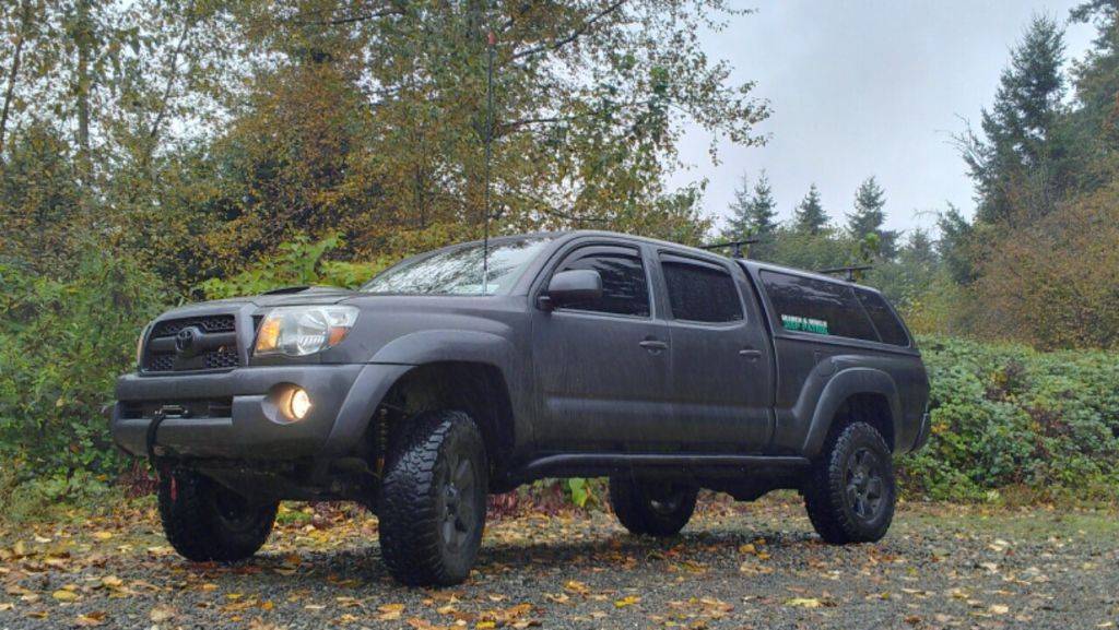

    Full truck shots?

    Its still dark here, I'll snap some pics later with my super-deluxe digital camera smart-telephone :thumbsup:

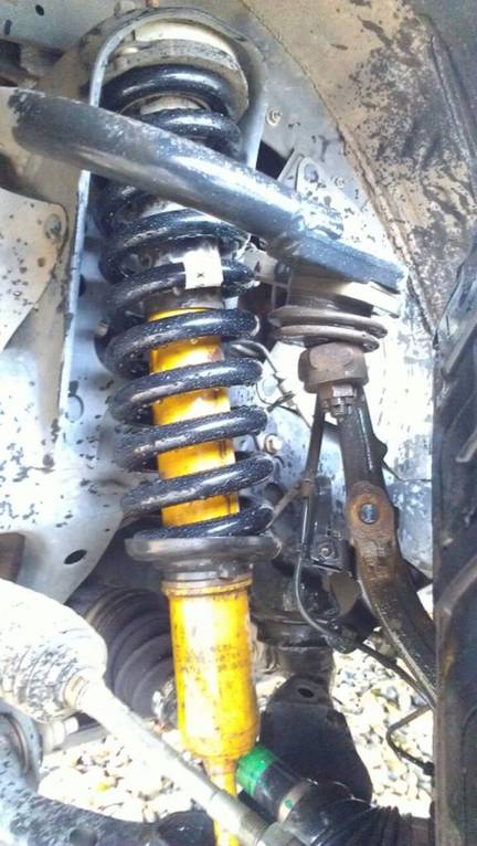

    Looking good. Do you have top plate spacers?
    And something looks a little off about your coil seat. Is it actually angled like that or is it just the picture?

    Yup, kept the toytec spacers in there for now.
    The coil cup is supposed to be like that. It wraps around with the last coil.

    Damn, you must be sitting around 4'' of lift in the front then. Never noticed that about the OME coil seat. Now I know. :rolleyes:

    39.75" from the ground to the fender. Putting the bumper on tomorrow.

    CV's look pissed off...but like you said, I'm sure that'll change with bumper and settling

    Yeah, I am trying to baby it today :eek:

    The front dropped 3/4" overnight, coils are settling down.
