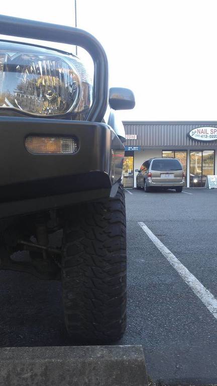

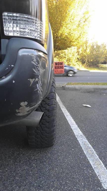

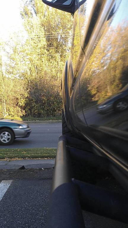

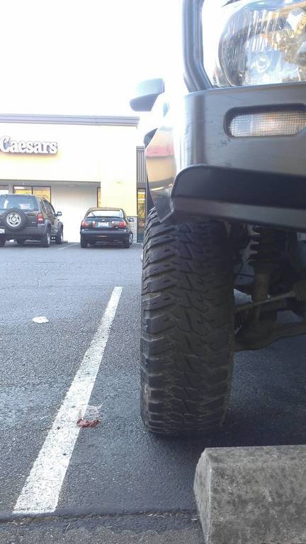

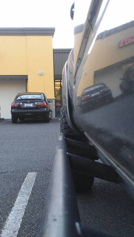

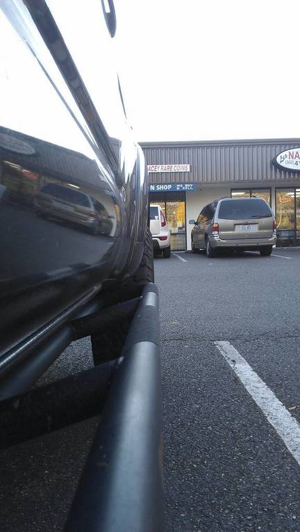

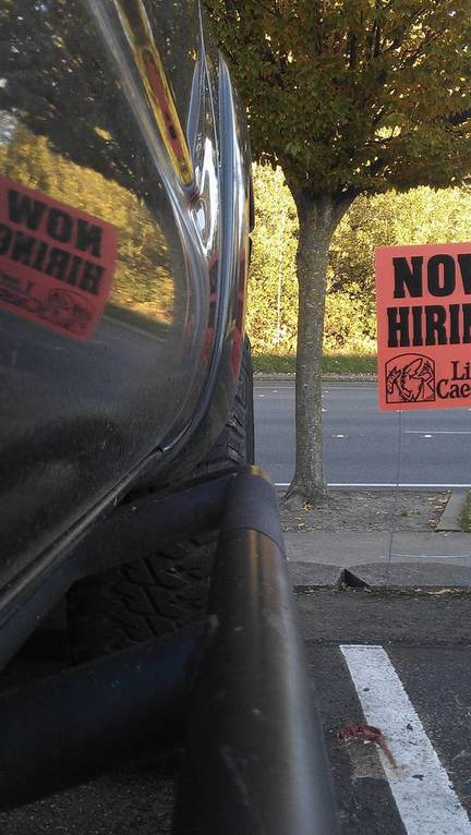

    Ask and ye shall receive my friend:
    Front/Driver
    Rear/Driver
    Front/Driver (from slider)
    Rear/Driver (from slider)
    Front/Passenger
    Rear/Passenger
    Front/Passenger (from slider)
    Rear/Passenger (from slider)

    Thank you sir! Gives me the feeling that I'm gonna have to go with at least a 1.25 spacer to get the tires setting where I want them to.

    The 1" put the tires almost exactly flush with the fender flares.
    Not bad at all. It doesn't lurch when braking or cornering. I had to put 886s on to compensate for the weight though.
    Taking the sway bar off made a big difference when driving through roundabouts; there's a lot more body roll.

    Do you have any pics of how much if any trimming you have done to fit the 285/70/17's

    Just realized that there seems to be some pretty significant damage to your fender! Thanks again for the pics! I asked UncleArt to do the same so I have a comparison of the different tires. Probably gonna go with spidertrax on mine

    I'll grab some pics later today. The front liner is tucked up now (since I put the ARB on), but I had to trim the rear a little and also did the CMC
    Lol, yeah...about that. There are a couple cringe-worthy spots on my truck, but they all come with a good story and great wheeling memories :D

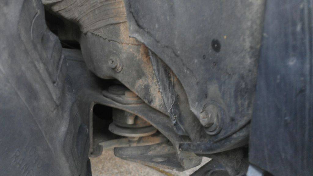

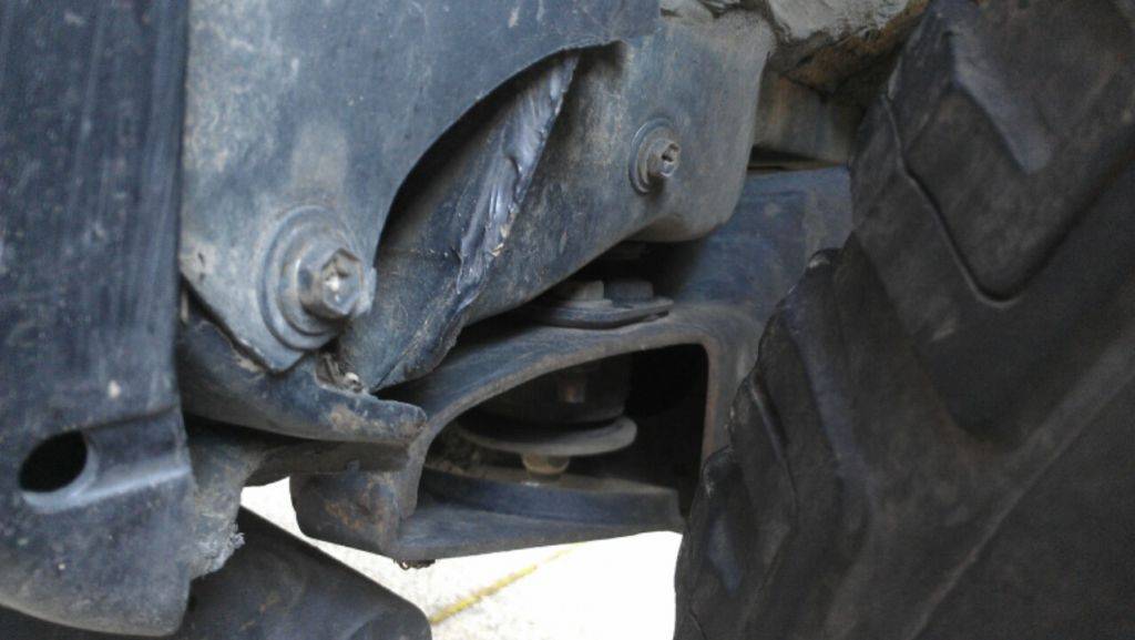

    Forgot to take pics yesterday. I guess these aren't the best examples, but maybe they will help you out:
    Driver's Side:
    Pass. Side:
    You can see the small amount of plastic that I trimmed, and also the CMC (yet to be plated in :eek:)

    So nothing trimmed from fender or flares?? Sweet I think I will have to go with the 285's

    Nope, the only trimming I did was the fender liner (as seen in the pics). I am also running 1" spacers, so keep that in mind. Your wheel's backspace will dictate what your potential rub-spots will be.
