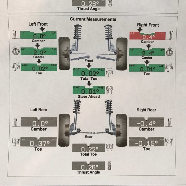

    I just had an alignment done and noticed the rear has readings that differ from left to right. See the image attached.
    My understanding is that since this is a solid rear axle there is no adjustment for camber or toe. Given that I have different values on the left side and right side of the truck does that mean my axel is bent? If not, what does it mean?
    Thanks,
    Chuck

    I wouldn't say bent axle right off the bat, there are a lot of variables with your rear axle being off. For one, your axle might be pushed forward even a fraction of an inch on one side than the other & it will give you different readings.

    Thanks, I suppose since one side is negative and the other positive that would indicate the axel is rotated around the pumpkin looking top down. No?
