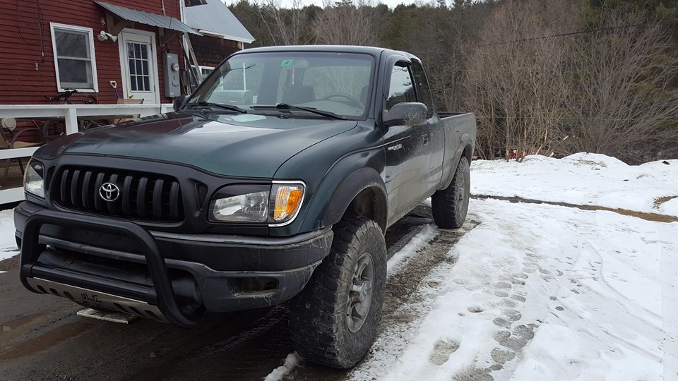

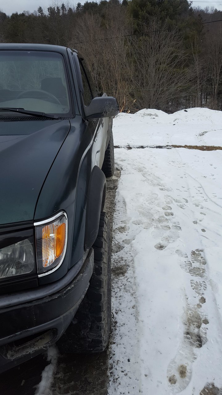

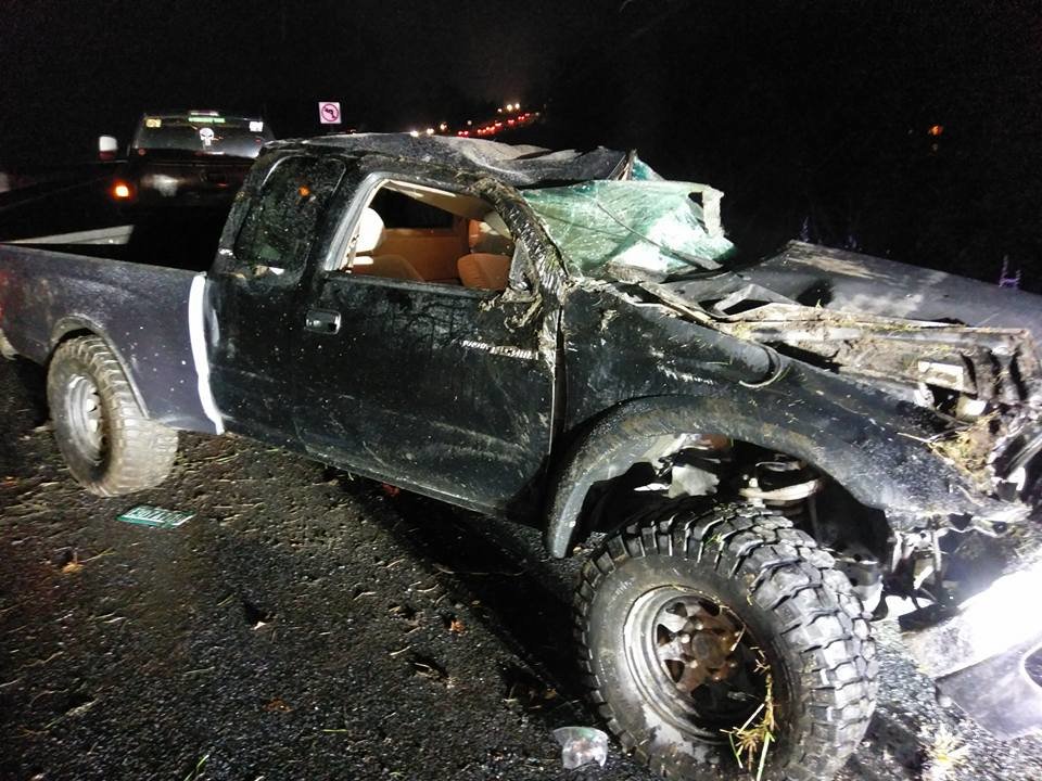

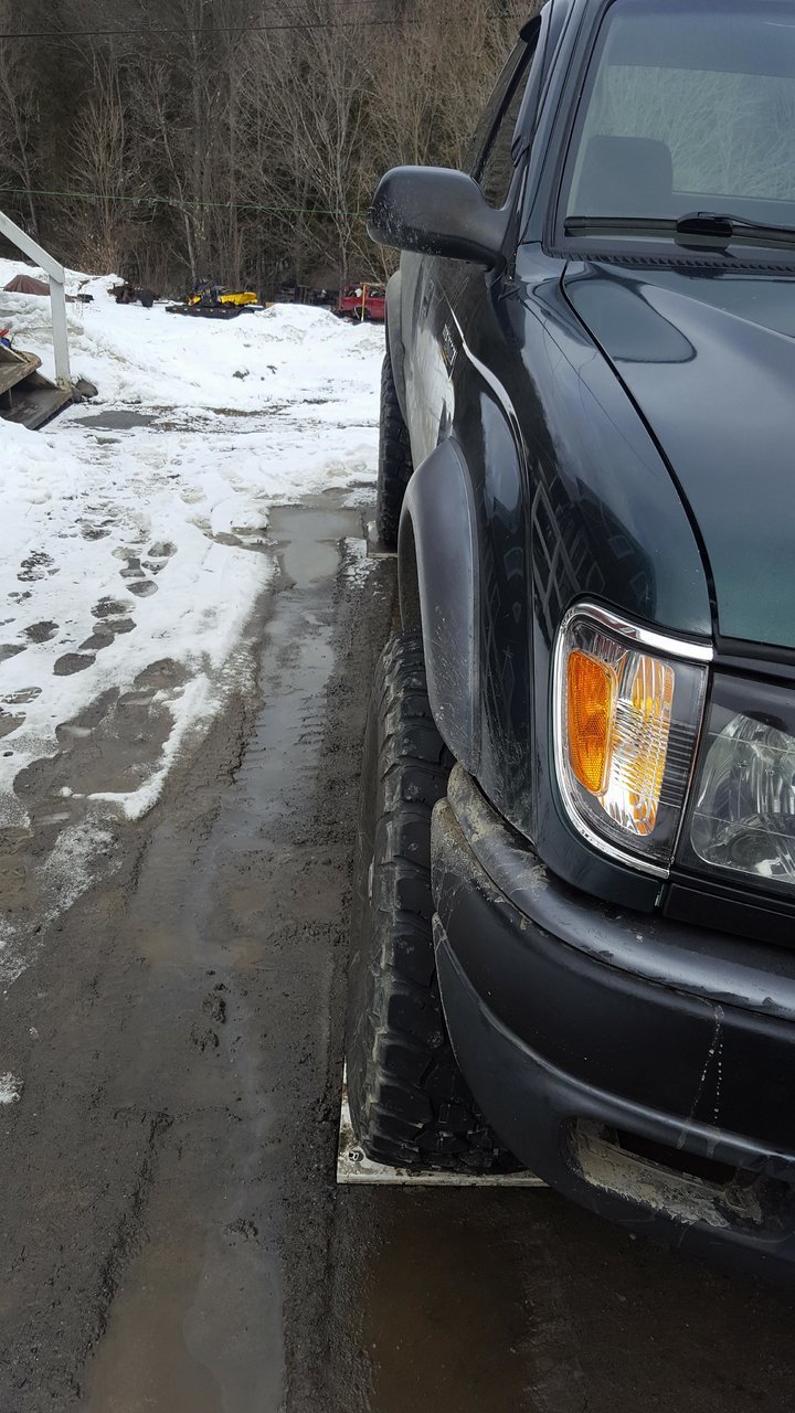

    Hey guys and gals, so the story starts like this. my boss bought an 02 tacoma extended cab 4x4, the previous owner put in a 3 inch lift and had pretty big tires put on. i got my hands on the truck and began cleaning it, once i cleaned the frame i was shocked... it was destroyed, it had scabs welded on.. and ive seen dog poop that looks better than these welds. so after getting annoyed and about to give up, my buddy rolled his on the highway, exact same truck. so i bought his for the frame, motot, and drive train. put my cab on his frame and my bed only to realize his frame was bent behind the cab mounts in rear. i figured i could tweak it back close enough with my tow truck winch... well i got it as far as i could, put tires on and its terrible. i had to put new wheels on all the way around because the steel rims were bent. thats not all though.... after finishing the truck i thought... it pulls WICKED to the left, well i used wheel spacers on 3 of the 4 wheels to make them somewhat line up.... well that was the plan at least. see, when it was rolled, the driver side slammed down hard and shoved the rear axle, leaf springs and frame to the right. but it also turned the axle a little... but barely, last night i wook it for a rip on the interstate... it pulls seriously to the left.... like if you let go it instanly goes left, so i took a gander today.. and the pics are right. look at the wheel positioning, for some reason the right front is cambered in at top pretty bad but no damage to syspention or shock tower... nothing up front is bent from i can tell with a level and straight edge.. but the back... aparently the axle is bent.. good news is, i have the other axle off rotted frame. my plan is to take 1.5x4 or 5 inch 1/4 inch thick rectangular tube, use a hole saw the diameter of the axle and make new mounts, then cut mounts off other axle and align it with front, then weld on these new mounts.. the only reason im saying this is because the frame isnt straight so the leaf springs are offset to the right.. if i offset the axle mounts the 3/4 inch, it should line things up. then measure off front cross member to axle to make sure its straight...

    truck went from this... to this
