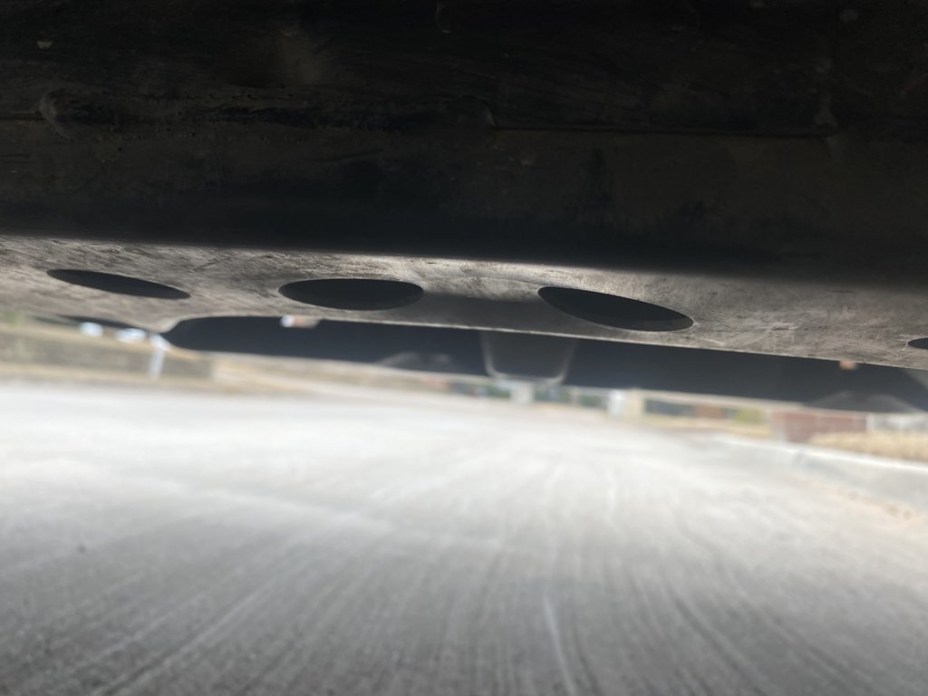

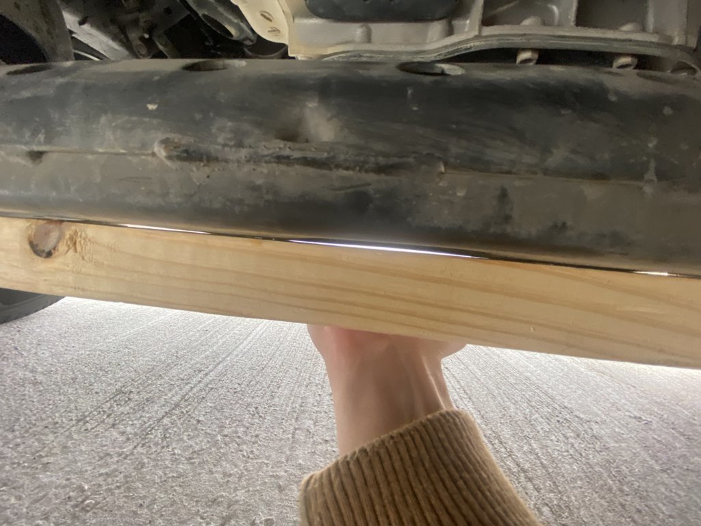

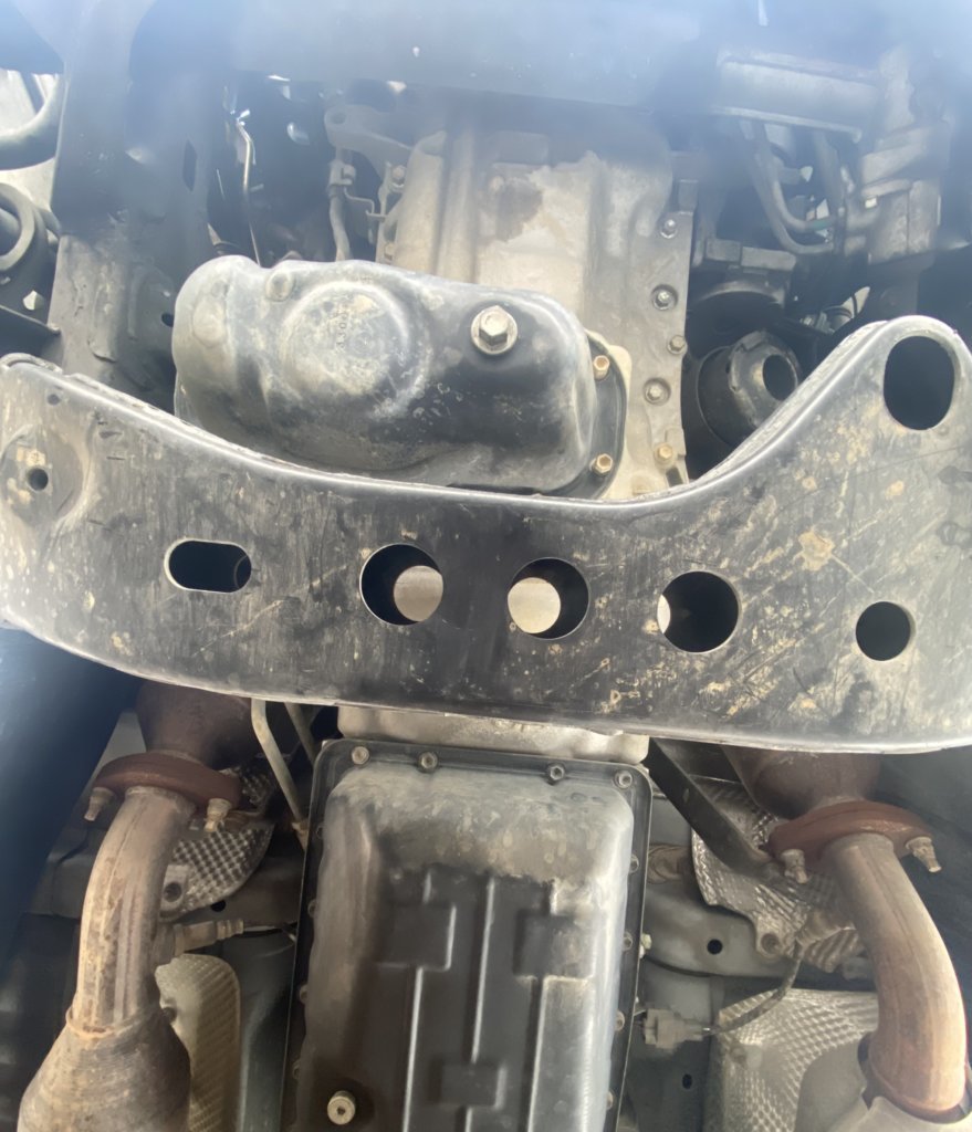

    In the process of trying to jack up the front end of my 09 access cab, I bent/dented the cross member that protects the trans. In the future, I know to use a jack point, but right now I am wondering if this is any cause for concern or if I'm worried about nothing. I've taken it for a drive and there doesn't seem to be any alignment issues.

    Since it is not connected to the suspension, I wouldn't think it would affect the alignment much, if at all. I should check mine, I’ve lifted from there several times. Did you use a bottle jack or hydraulic jack with 4” pad?

    Bottle jack. It looks like people who use this cross member as a jack point suggest using a plank of wood to distribute the weight, but I don't plan on running that risk.

    It looks like a very minimal dent at a web type location between 2 big holes. I think the dent could be deeper and still not change the geometry.
    Had you dented/kinked the verticle sides of that member, that could be an issue.
    In short it's fine.
    And as mentioned before, lift from approved points.

    You're fine.

    It's fine

    dont think he was referring to suspension alignment, he was referring to engine, trans, driveline, motor mount alignment...
    To the OP, its fine....
    Think you just dented the lower portion & didnt actually bend the whole thing...
    But if you think the whole thing is bent, try to find a used replacement.....

    Nothing to worry about.
