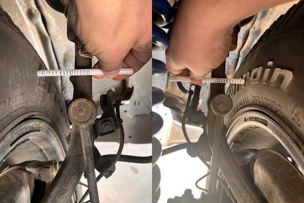

    He said he adjusted it as far as it would go, he didn’t charge me anything for the adjustments.

    Well he lied to you
    The sheet shows he did nothing
    He didn’t even set your toe

    An alignment isn't going to change the distance between the tire sidewall and the spindle. Only a bent spindle or severely worn bearing can do this:

    no I agree
    But he doesn’t know that’s the problem and even a bent knuckle won’t matter if the bearing is good and there’s enough movement to get a good alignment
    The tire to knuckle distance doesn’t necessarily mean anything if it can be aligned

    OP appears to have a 2.5"+ lift with King coilovers and stock UCAs. No way for caster and camber to be in spec at the same time.

    Ok I got it up on the jack and there is no play in the wheel at all. (Edit) at the time of taking it to the shop I didn’t know my spindle was bent and was hoping it was an alignment issue. I’m not proficient in the terms shown on the sheet either.

    It needs a knuckle. Any alignment adjustments performed before the knuckle gets replaced are worthless. The tech likely knew this so he didn't do anything.

    so what was the problem?
    What was the behavior the truck has that you wanted fixed?
    There are people who will be worried
    But honestly based on that alignment sheet both fronts are out of whack
    So I’m not overly worried about the knuckle yet
    If you properly shook it down and everything is tight then what’s the issue?
    If the knuckle is super bad then it’ll wear your tires funny
    But that’s gonna happen anyway with those numbers
    Maybe not even that bad
    You don’t have pre 5mph rock impact numbers so in all likelihood the high mileage heavily moded suspension has had these issues for a while
    If all this is true I’d drive it till I could get it reworked
    And I’d look for an alignment tech who’s willing to try to help sort it out.

    Well it drove straight before the impact and it didn’t have a camber. Post impact I have to drive with the steering wheel turned to the right a decent amount and it rides different. I had my alignment done at a shop that I trust with all my heart. The only reason I didn’t go to them is because they are closed on weekends. Every mechanic or person with a mechanical mindset who has seen it in person has told me my knuckle is bent. I can also see different patterns in the dust on the tread when I drive it on my flat concrete pad.

    If you’ve got drivability issues and it absolutely can’t be helped with alignment
    And you don’t have much money
    Then I’d order a knuckle off eBay for $90
    And swap it in your driveway
    Then you’ll still need it aligned
