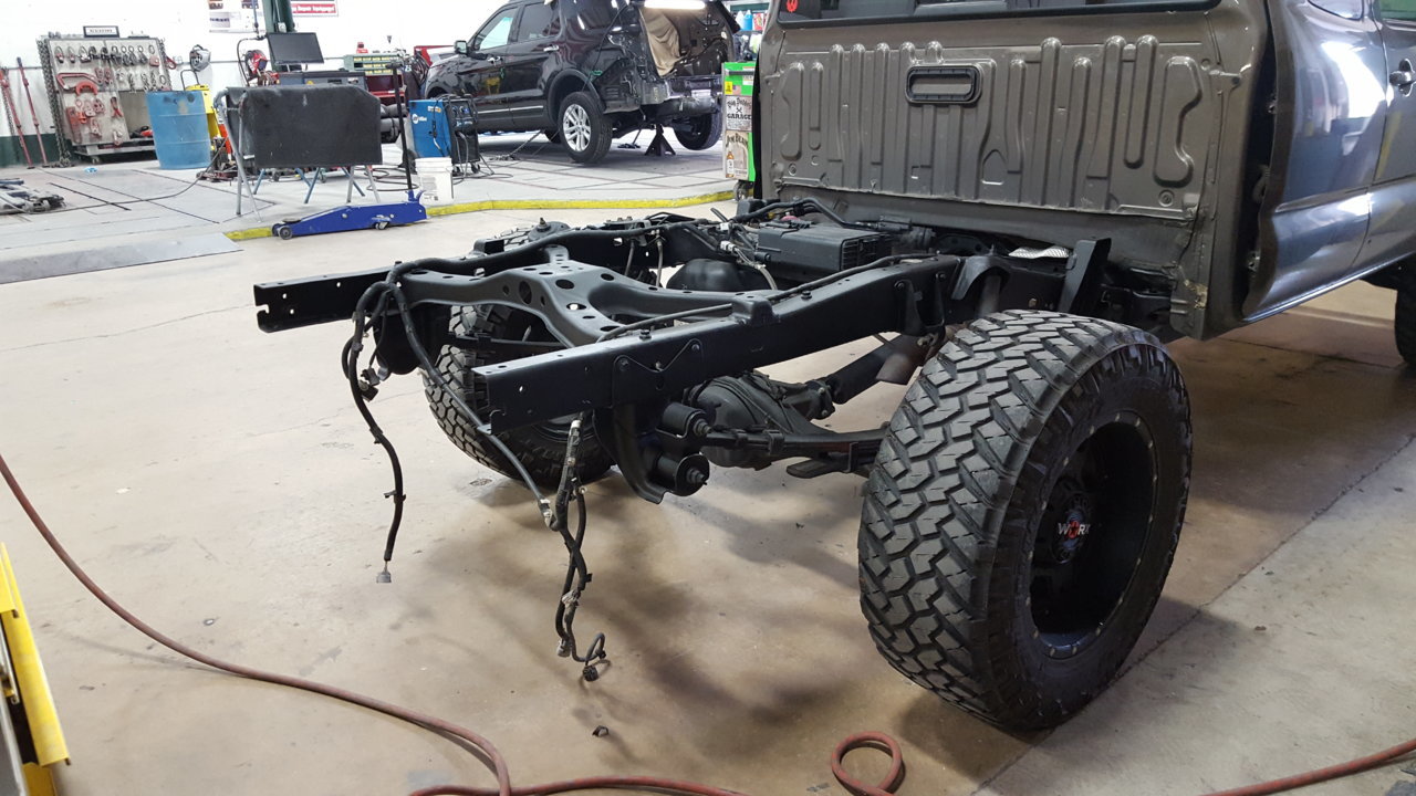

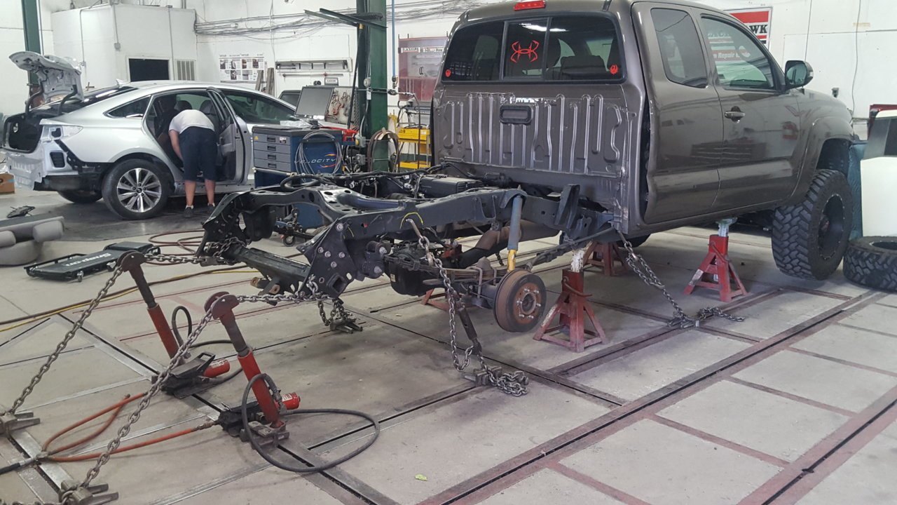

    Price would be about $350 for measure & frame pull. If frame also has diamond, add another $50.
    You will probably need a new lower control arm as well. (You figure if that control arm pushed back with enough force to bend the frame, then the bushings and ball joint in it are damaged too) Then we'd get into whether the cam bolts are seized up and woukd need a new set of those

    Insurance company wanted to put a new frame under it, which would have totalled it. It also needed a new bed assembly, new tailgate, left bedside, two tail lights, and new bumper. Estimate total was about $11.5k repairing the frame vs $16k replacing the frame.

    It's a Blackhawk Korek machine made in early 1960's. The absolute best frame machine ever made in my opinion. We only use it for full-framed trucks anymore. We also have two Korek II's which are slightly smaller and designed for unibody cars. All three use 10 ton hydraulic rams and chains. I've been straightening frames and unibody frames since I got out of high school in 1979. My dad was also a frame tech from 1956 until he retired in 1998.

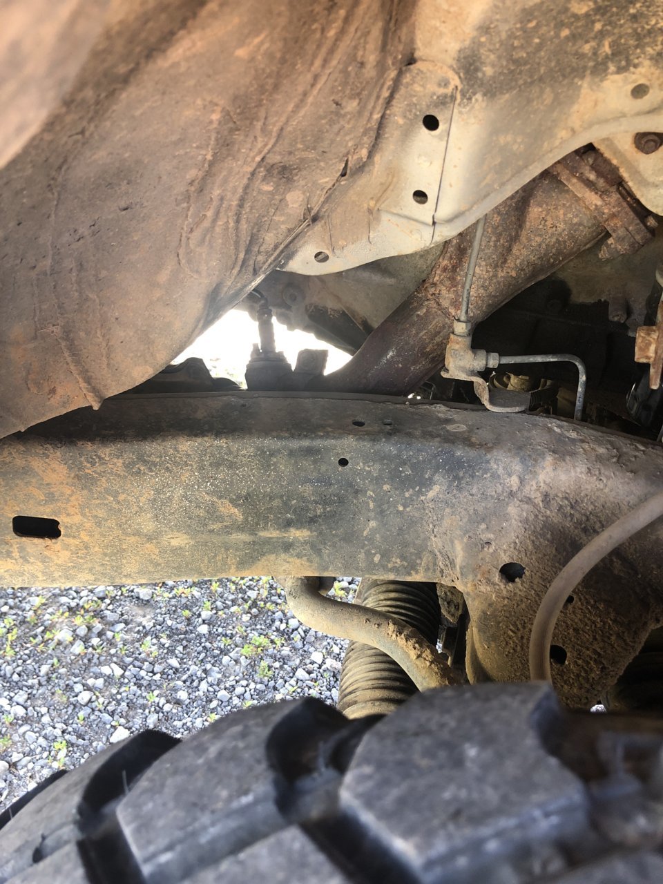

    How much does a frame straightening roughly cost? Think my rear end after a frame repair is currently sitting at a lower angle

    Thanks for the response. Yea I hear that, I wouldn't say its terrible now, my frame was just rusted at the front leaf spring mounts and I had safe-t-caps put on and now it sits a little off. This is not my truck but the way the gap is from the bed to the cab is almost identical to how mine now sits after the fix. My mechanic said rest of the frame is sound and good to go.

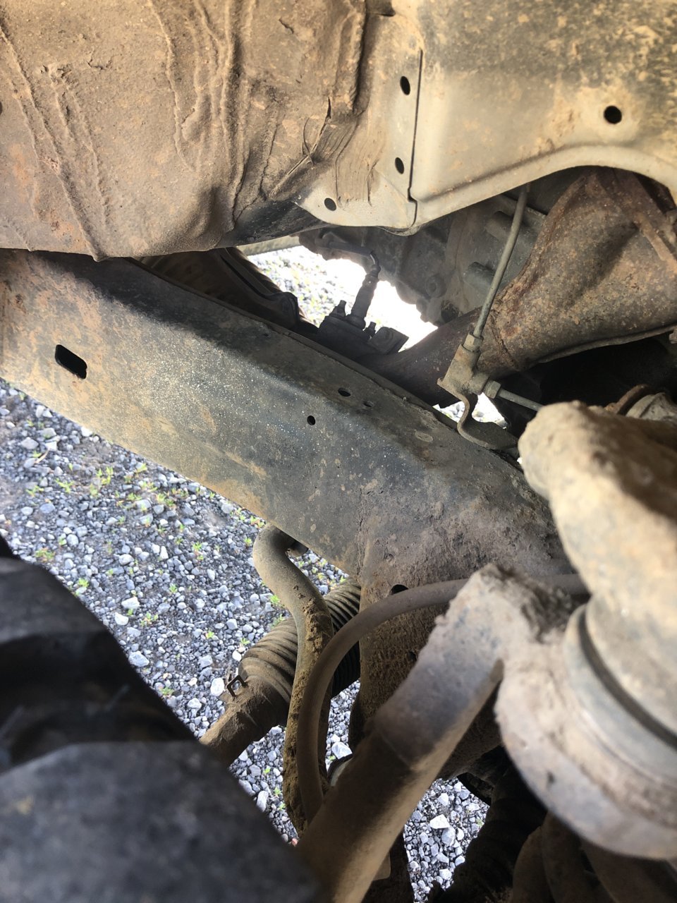

    I can hardly see the bend. My frame looks identical to this and even differs from the driver side but the truck aligns and drives perfect, no uneven wear.
