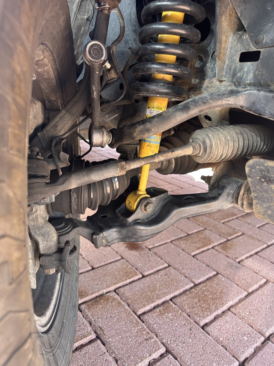

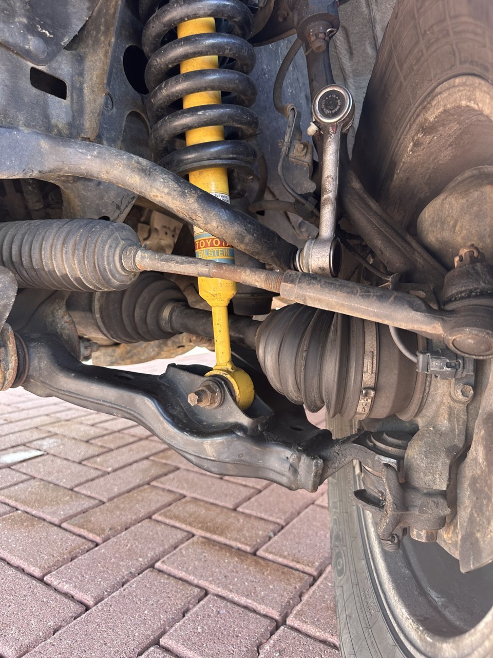

    First one is the suspected bent one and second is my passenger side for reference. Probably going to buy mevotech ones from rock auto
  9. Jul 27, 2023 at 10:54 AM
    Jdilla83194
    Jdilla83194 [OP] Active Member
    Apr 29, 2021
    #364238
    41
    Carlos
    Colorado
    2006 Radiant Red Tacoma TRD Sport, Access Cab
    Picture might not be doing it justice, but in person it just don’t look right
  10. Jul 27, 2023 at 11:20 AM
    nd4spdbh
    nd4spdbh Well-Known Member
    Oct 7, 2013
    #114055
    14,552
    SoCal
    13 DCSB TRD OR v6 Auto
    definitely looks bent to me.
  11. Jul 27, 2023 at 11:26 AM
    dtaco10
    dtaco10 Well-Known Member
    Jul 4, 2018
    #258356
    793
    Dave
    Anoka County, Minnesota
    2010 White Tacoma 4x4, 4.0, Auto
    It does look bent. I'm not an alignment guy, but I would think it controls toe-in/out.
