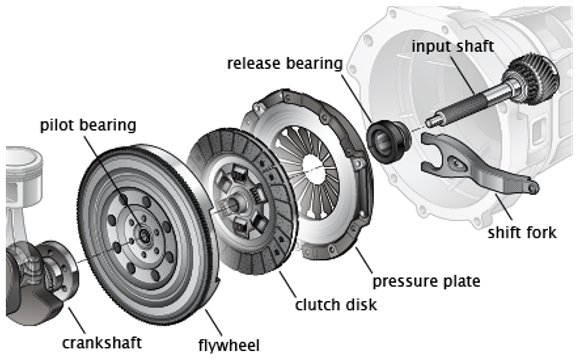

    o_O Bent input shaft...?
    Let's think about this a minute.
    The input shaft is supported on the front by the pilot bushing/bearing on the end of the crankshaft and in the rear by the front bearing of the transmission - just how was this supposed to get "bent"?
    Just to be clear, when you say "put the clutch in" I'm going to assume you mean depressing the pedal to the floor. If you do this at a stop the transmission input shaft stops spinning - if the noise stops as well that indicates the front bearing of the transmission is making the noise.
    Question: Do you have an aftermarket shift knob? If so, transmission noise that travels up the shifter is sometimes more noticable.
    The bearing right in front of the gear on the input shaft is usually the culprit.

    actually no pilot bearing or bushing on ours, because the input shaft is fully supported by 2 bearings and so there is no use or benefit for a pilot. So technically it could be bent but I don’t understand how that happens.
    Transmissions utilizing pilot bearings usually have a super short input that ends right after it connects to the counter shaft just inside the transmission, and so it needs the pilot bearing for stability. Ours doesn’t have the input connect directly to the counter shaft, so it’s different. Still, a bent input shaft seems unlikely.
