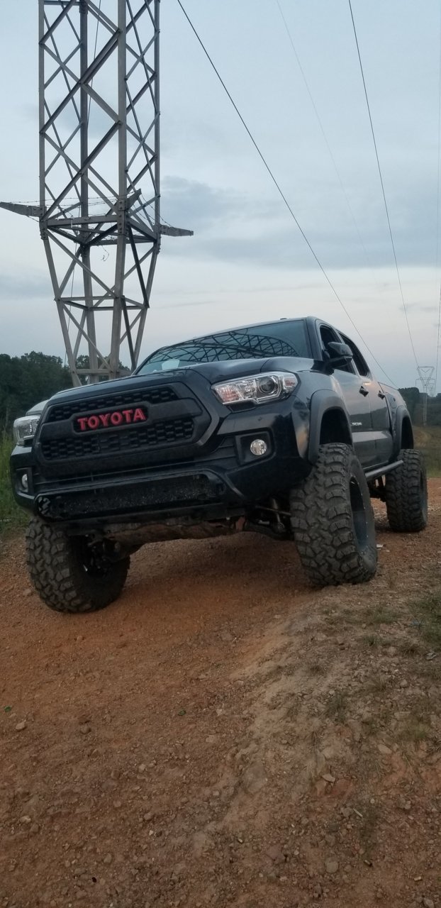

    Went to 33's first and then 35's. Ran the 35's for about 4 months before I decided to regear.
    Here she sits on dirty fives on a 3" lift. (True 3", not the 2 inch plus stock 1 inch crap)

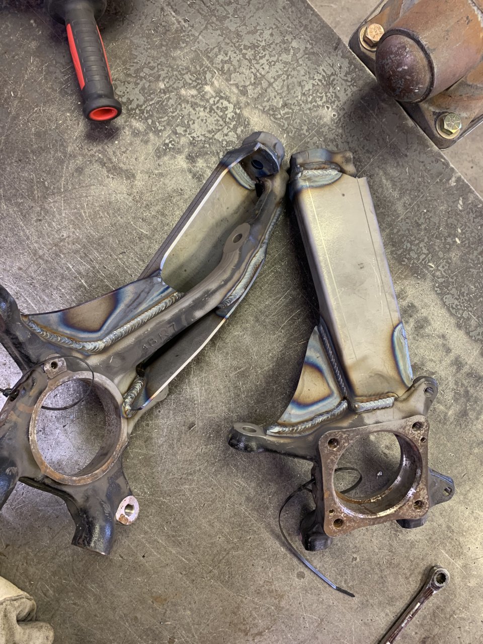

    camburg makes an indestructible set for $1800. Most people just gusset them using total chaos gussets. It costs around $175 for the parts and welding.

    Thank you man that is exactly what I need.

    That really doesn’t look like 3” to me. Mine has 35s and looks like it sits higher but just under 2”. But not like it matters.

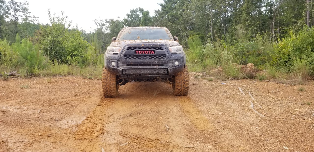

    Are you on legit 35’s or 35’s that actually measure to 33’s?
    Pportera likes this.
  9. Sep 13, 2020 at 8:09 AM
    #29
    Pportera
    Pportera Well-Known Member
    Feb 10, 2016
    #177747
    202
    3rd gen.
    Down here in the south If it dont say 35x12.5 on the side wall they ain't tru Dirty fives..
    These are tru 33x13.50 on 17x10

    here is mine on 35’s. Tires measure 34.8”. Lift is 2” (3” according to ADS, but that is based on 2nd gen numbers), going any higher would result in little to no down travel left.
