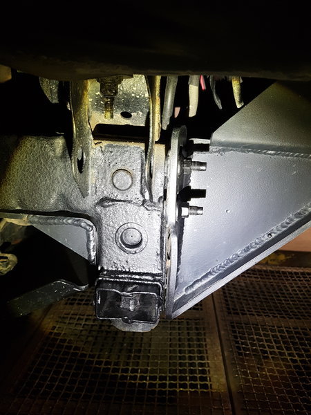

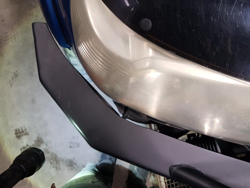

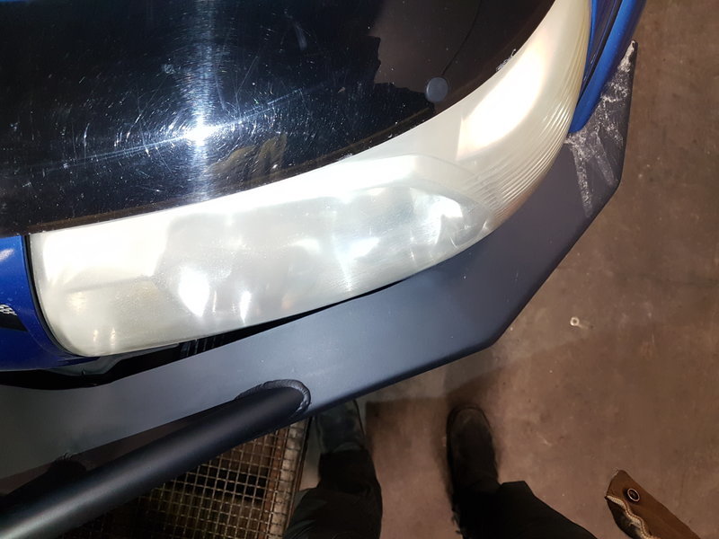

    So I recently had to recover a friend stuck in the snow. I had no choice but to pull in reverse, and had to give a bit of a bump to get him out.
    I have an aluminum pelfreybilt bumper, and the mounting tabs have bent about 1/4" leaving a gap at the top of a bit over an inch.
    I'm wondering if I should just chalk it up to lesson learned, or if I should pull the bumper off and bend the tabs back.
    My reason for hesitation is that I don't want to over stress the aluminum and cause it to crack. The gap really bothers me though, even though it's not really affecting anything.
    So all you metallurgy guys, do you have any advice?

    I don't really see how it's bent ? My tabs are bent in a little since I used shims

    Kind of hard to tell in the picture, but where the bumper is bolted to the frame, both inner bolts and outer bolts, the mounting plate is bent about 1/4"

    Have you seen the reinforcement plates from relentless? I would bent them back and use those...I heard pelfrey has them too

    I'd pull it off and bend it back. If it cracks take it to a metal fabricator and have em weld it. Then go buy a winch. lol.

    pull it and bend it.. call pelfrey and see what they have to say

    Thats too bad for you guys. Its always 'cool' to see how shit plays out in real life though.. obv steel is stronger, but I never thought you'd see something like this..
    But to the original point, probably take it off and beat it back until its close. If you see some cracks forming might take it to a shop and have them drop a few extra welds over it. Not sure how easily Al work hardens, but I don't think its too bad..

    Cracks could be in just the powder coat .I basically did what these guys said, took it off and beat it back with a hammer. I wanted to weeks on extra gussets, but in the end couldn't be bothered. It's pretty close to straight, nobody would notice
