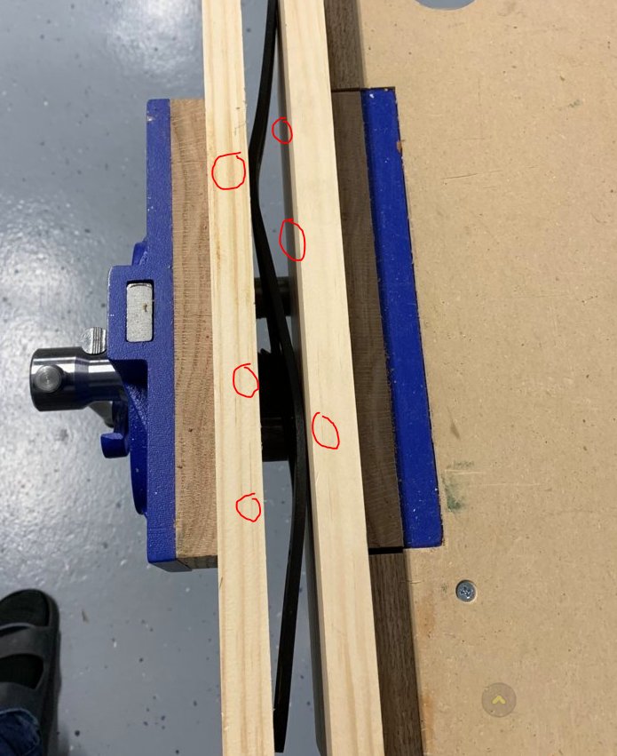

    The aluminum is not going to break. No, you don't need to heat it up. I wouldn't put truck weight on it.
    Just use regular c clamps or bessies from harbor freight every foot or so in the effected area, and you'll get it 90% there. The rest can be done by hand.

    Yup, depending on the angle of the rope, potentially quite a bit more force than just 200lb. I wouldn't be surprised if the entire mounting rail got ripped out if you tried to hang a hammock that was fairly taught.
    Should be easy to bend that thin aluminum back into shape though, just don't flex it back and forth several times or it will fatigue crack.
    Pro tip, Don't use anything really hot like a propane torch/stove. Aluminum transitions to a liquid very quickly (compared to steel which softens first before going liquid). One minute the aluminum bar you're trying to heat won't budge, the next moment liquid aluminum is dripping on your boot (also don't wear sandals when doing this)

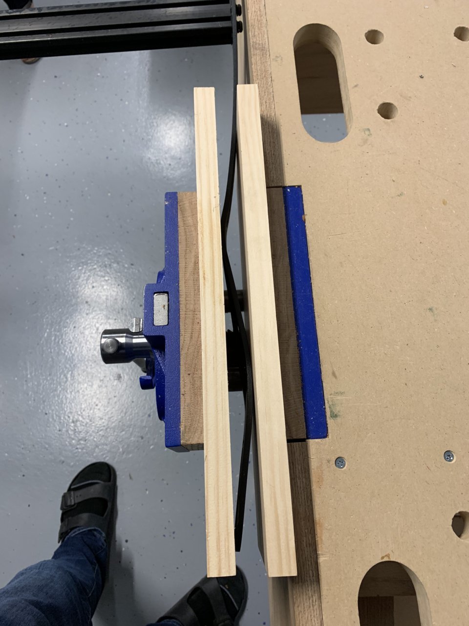

    Vice went well. Although there is some minor “waves” still present in the bar. Might take a mallet to it.

    He's just using a vice....

    You'll have to go slightly past "flat" to get it straight. Add some dowels here and try. You will be mimicking brake press tooling. It still won't be perfect and that area is now a fatigue point no matter how you bend it back. Keep an eye on it for cracking/tearing.

    What @monkeyevil said. Your going to need to bend it past to get it straight. Are these racks powdercoated, or anodized? If PC you can't use heat you'll melt the PC off before you get to a temp that makes it easier to bend. If anodize you'd need to use a oven, no direct flame. Or since you have it all apart see if you can just get two new side rails? Aluminum does like a little heat to persuade it to move. Some aluminum may crack if bent to far. Depends on its alloy, 3000, 5000, 6061, 7075, hell even different series can have different tempers. IE 7075 T-6 would crack if you tried to bend it without heat. Have fun and good luck!

    We all make mistakes. Especially if beers were involved. Lol. I would start by disassembling it and trying to slowly bend it back. Maybe placing it between two two by fours and hammering it out?
    Good luck. If all else fails I'm sure you could buy just the one piece as a replacement part.
