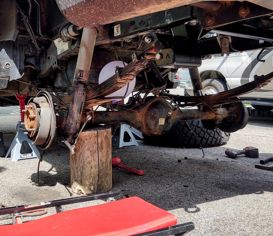

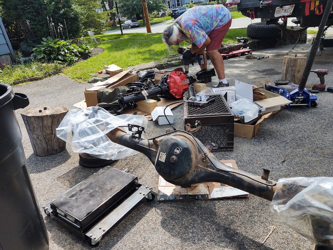

    Ok, I just saw this but I have a rear axle I am looking to get rid of, I am having a hard time selling it.
    it has 4.88 gears with about 1000 miles on them.
    2009, factory e-locker
    I will throw in the nitro chromoly axle shafts, I never pressed them in.
    I am willing to negotiate.
    here is a photo. I am getting rid of it, as I decided to upgrade to the ECGS Dana60.
