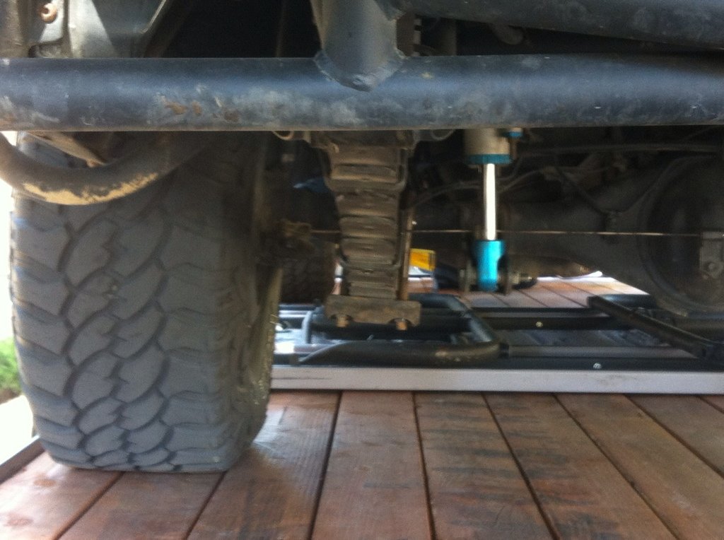

    Well today I drove over a little ditch that I didn't see while heading off road. I hit the ditch pretty hard going at about 20-25 mph and caught some air, it was really rough. The truck seemed to drive fine and I didn't see anything broken until I noticed the rear wheel on the passenger side to be slightly angled in. Is this a bent axle? How do I get if fixed and is it okay to drive? Any help is appreciated.

    I would jack that side of the rear wheel and turn it by hand to see if it turns smooth and looks straight, it could have bent the rim or the axle, that's a place to start and have it checked out soon.

    A couple photos from a distance would help too.

    Well I didn't really jump it, I approached the ditch at an angle and pretty much slammed into it and caught some air. I'll get a picture of it tomorrow.

    If you notice the tire wearing more on that outside edge you probably bent it. It does kind of look bent from here but... hard to say. May want to get it checked out by a reliable shop who deals with this kind of stuff.

    Well chances are likely it's the axle tube if anything is bent, not the axle shaft itself...
    Theres no wobble right?

    But really none of us will be able to tell from those pictures. Get it checked out by a shop as it could be potentially dangerous. Summer is approaching...perfect time to get a job and fix it!

    It's not as hard to bend as you think. They are pathetically thin walled axle tubes especially by the flange.
    ^What he said.
    If you bent the shaft you'd have some wicked vibrations. Ask me how I know :anonymous:

    Safe yes. I think you'll be fine but if it is bent it's putting extra stress on the side gear as Jason full well knows and you can break the side gear. That's doubtful IMO because his was severely and obviously bent. Yours looks it but it's hard to tell. Our axle tubes are a little beefier as well.
    At any rate, safe yes.

    Do you have a digital level? If not...go buy one. They are like 30 bucks.
    Park on a flat level ground and measure camber and you'll have your answer.

    Thanks man. And if its not bent, what are any other possible reasons to cause the tire to be slanted in?

    You're driveway not being level and possibly low air pressure

    Pretty sure its not my driveway because the tire is like that everywhere I go. It's not low tire pressure either.
