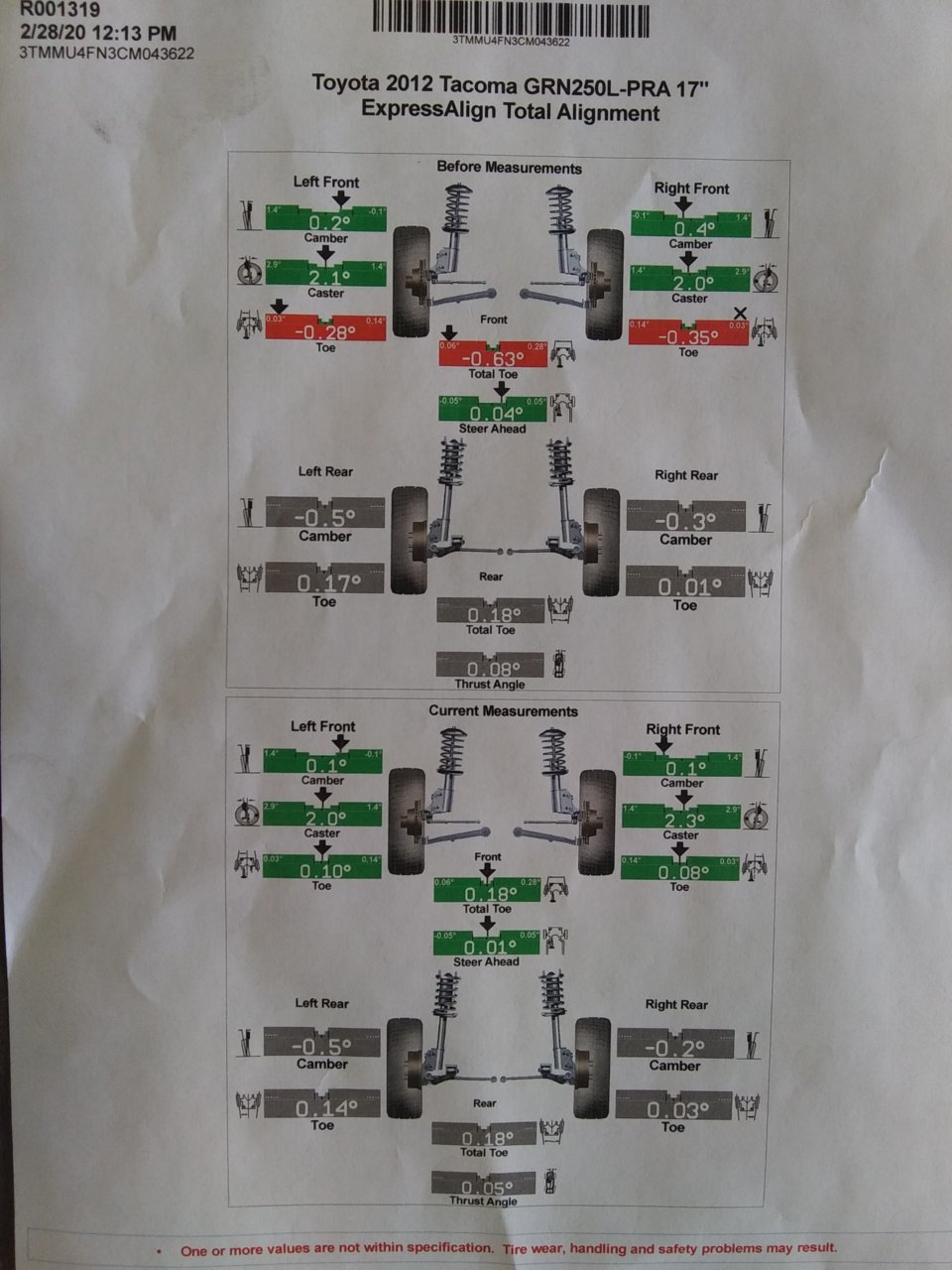

    Here the specs after alignment

  11. Feb 28, 2020 at 2:19 PM
    #211
    Muddinfun
    Muddinfun Well-Known Member
    Apr 17, 2017
    #216500
    7,489
    Nice alignment! I’m impressed.

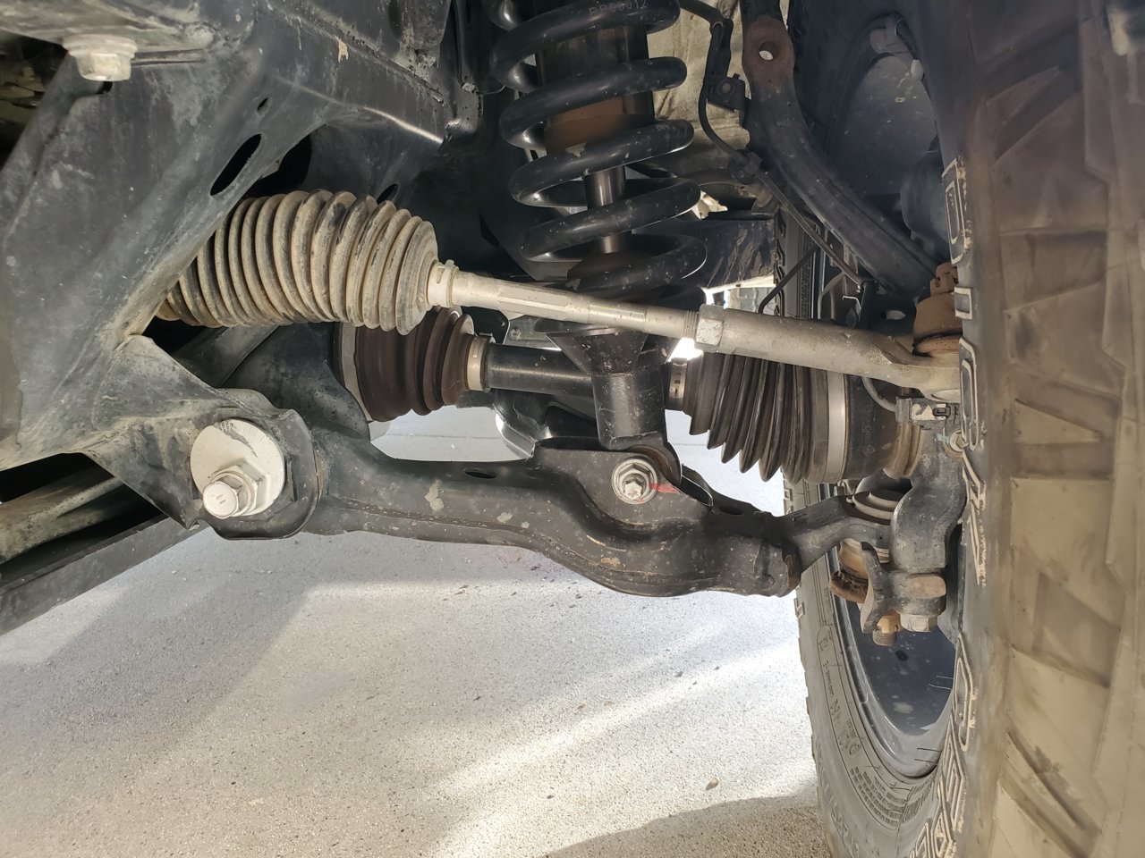

    I hit a rock and this happened, so shop said bent steering kuckle, lower control arm, need new outer tie rod and hub/bearing. What do you guys think

    I think they’re using the shotgun approach. I’m sure the knuckles bent, but beyond that, hard to say. I can understand them not wanting to put a knuckle in it, and then check it and see if something else is bent, but I have a feeling they’re replacing a lot of parts that there’s nothing wrong with. Easier for them to just say, “you need everything on that side”.
