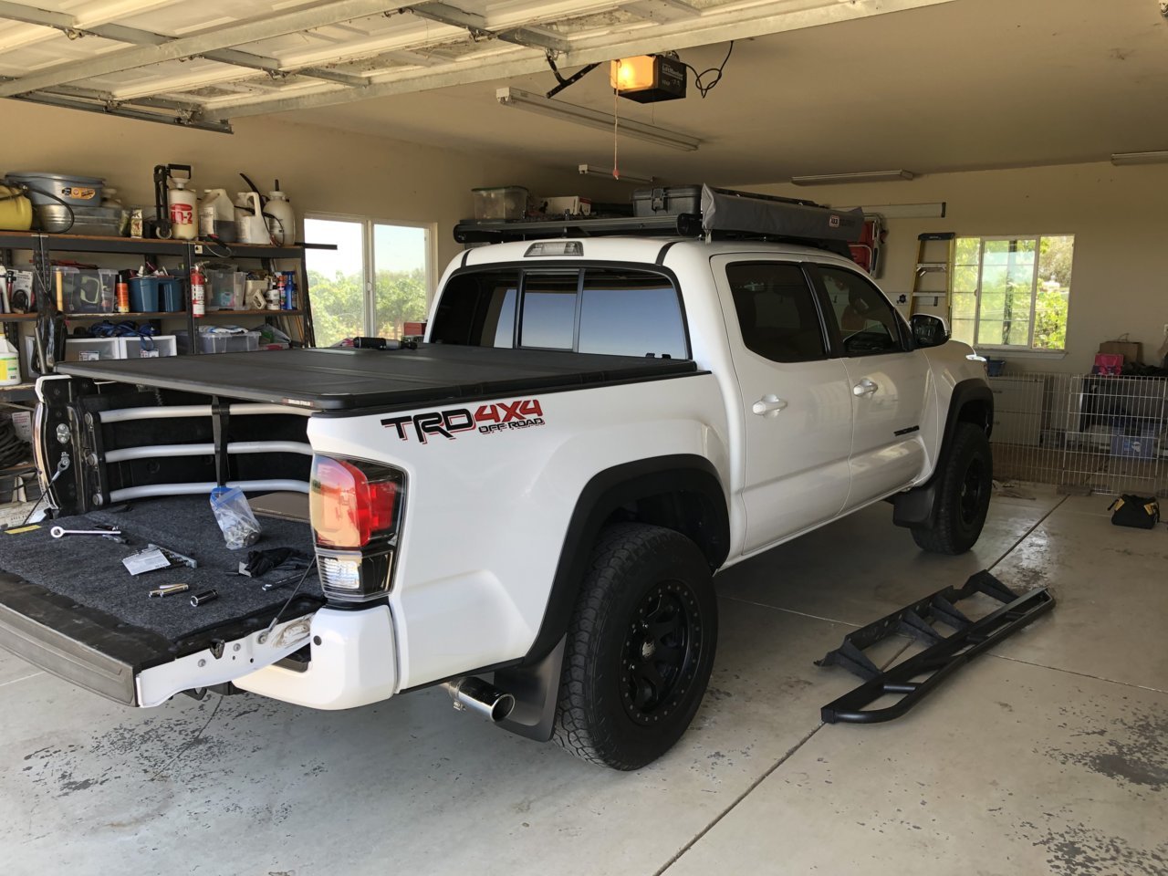

    Could be, it attaches directly to the frame though. Hard to imagine that a swing arm would bend the frame just by being open. There’s also around the same amount of weight on each arm, so that should also theoretically prevent it from bending one side.
    That being said… I do have a old pic with the tailgate open before installing the bumper. Looks like both cables are pretty taught. Maybe it’s just my eyes playing tricks on me, but if anything the passenger side looks a bit looser.

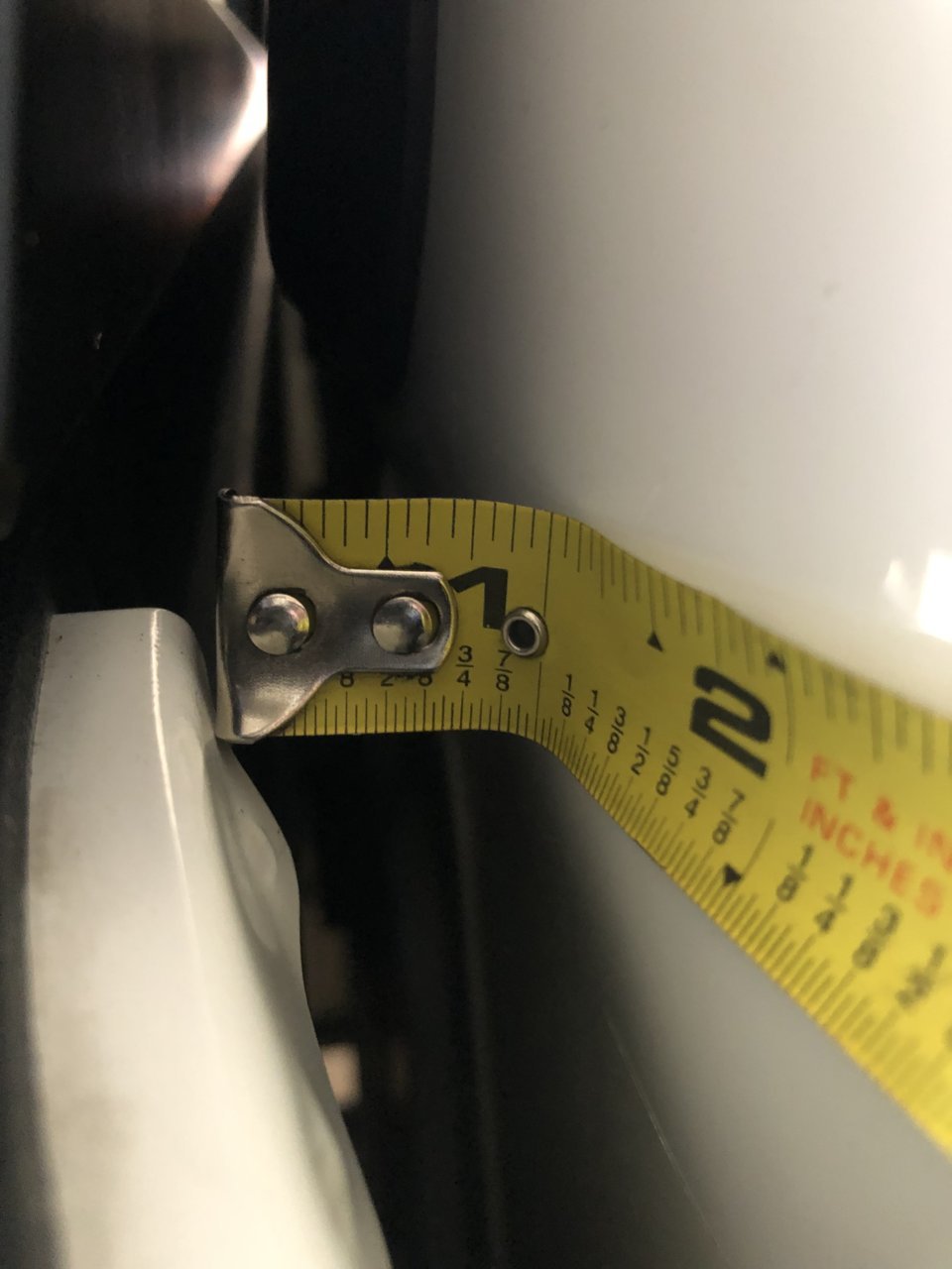

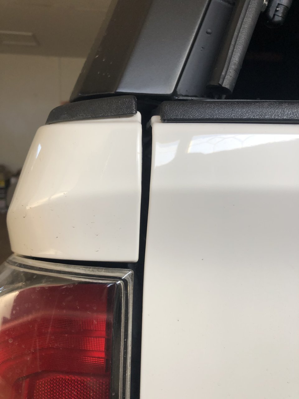

    So I just started measuring shit to try and figure out what’s going on. It seems that the entire bed is skewed by about 4mm.
    These two pictures are measuring between the bed and the cab on either side.
    What’s also interesting/annoying is a slight bend in the bed on the driver side. (I looked through some old pics and it seems that the bend has been there since before the shell, but those photos are crap so I’m sharing the most recent one)

    That last pic looks like a bed stiffener fail.
