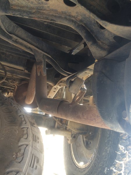

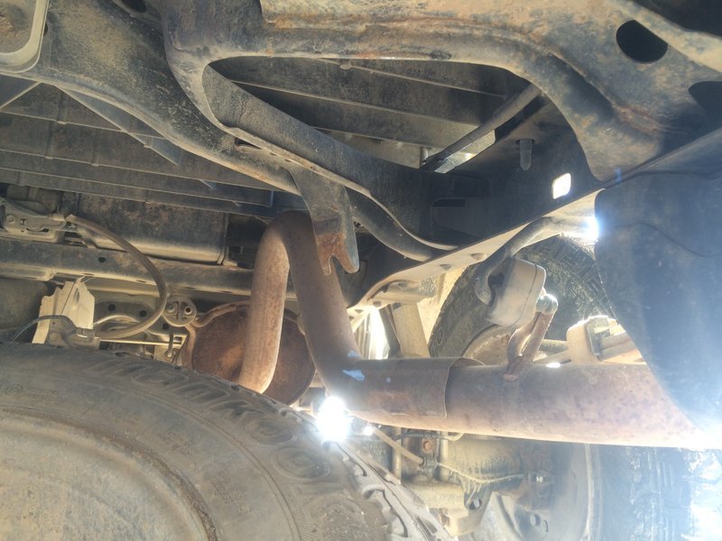

    I was puttering around the rig today and I think I must have bent up my exaust sometime lately. Can someone take a comparison shot to give me a comparison? It looks like the read most hangar bent up toward the bed possibly?

    My exaust is actually touching the rear quarter panel behind the rear tire.

    Chop the bitch after the top of the hoop that goes over the axle. Forgo the last hanger and its up and out of the way never to be bent again.

    I was hoping someone could crawl under their rear end and take a picture to show me how much I need to re bend the manifold hangars. Somebody gimme a hand!

    The rubber piece that the metal hooks go into is completely upside down. Pull down until the hook on the pipe is under the hook on the frame and the rubber piece looks spaced properly.

    Ahh, thanks that'll get the tip off of my rear QP but I think I'll still end up bashing that arm a bit

    I almost ran over my exhaust pipe reversing down a steep, really uneven section of bed rock a couple years back. I pulled it back into place(more or less) and its been fine since. Hope this helps. Good luck bro.
