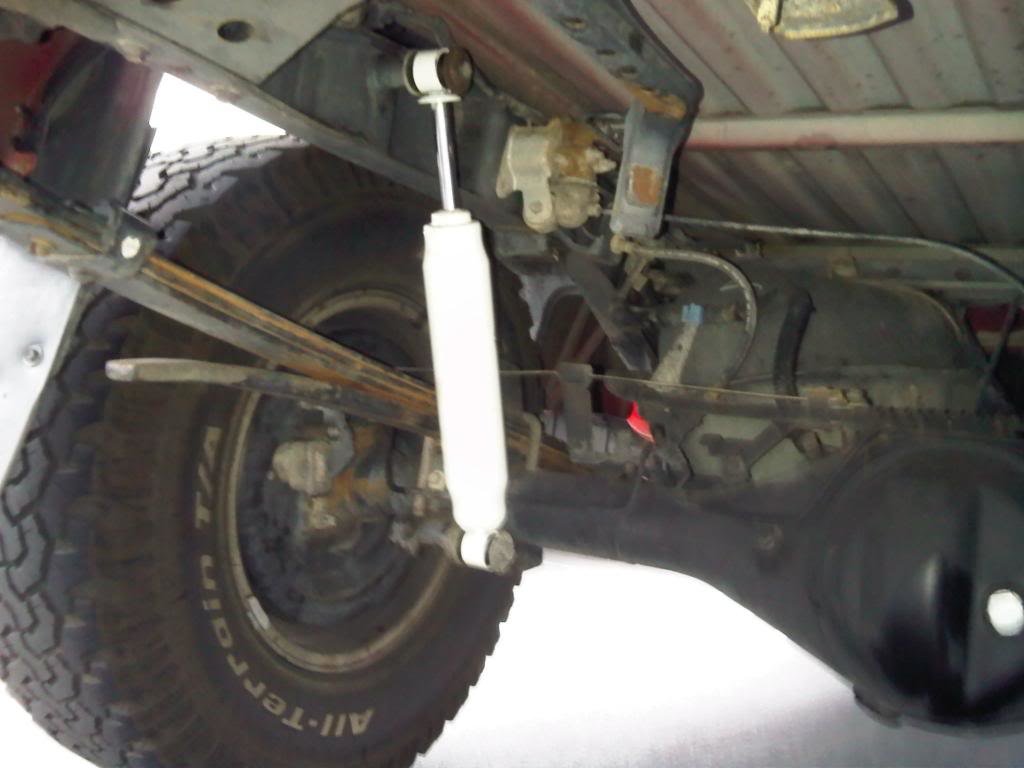

    First of all, judging by the pic or 2 in his build that have the frame in them, this is false and you have no basis for this assumption. His frame has very little rust on it.
    Second, the warranty has not expired if he did a frame inspection in the past. His truck would be good until 2016ish.
    Third, (for another poster) the warranty is 15 years from the in-service date. Your dealer can tell you when the truck went into service.

    I had a truck bought back already. I know about the frame rust. If you don't have any rust on the outside of the frame, there is no practical way you have enough rust on the inside to eat almost .095" of steel and bend the frame. You can argue all you want but you have no basis for your conclusion on his frame.
    The initial inspection campaign may have ended December 2012 (your info on 2011 is wrong wrong wrong), but if you did the required inspections by the end of the campaign you are grandfathered in until 15 years of the in-service date. This is a fact and cannot be argued. Hence the reason people on this forum are still getting trucks bought back and frames replaced. Please stop providing false information and freaking all these owners out.

    both my trucks were black on the outside with plenty of paint when they failed. being from cali it probably actually bent. Get it straightened and then box the frame.

    This is his truck from his build.
