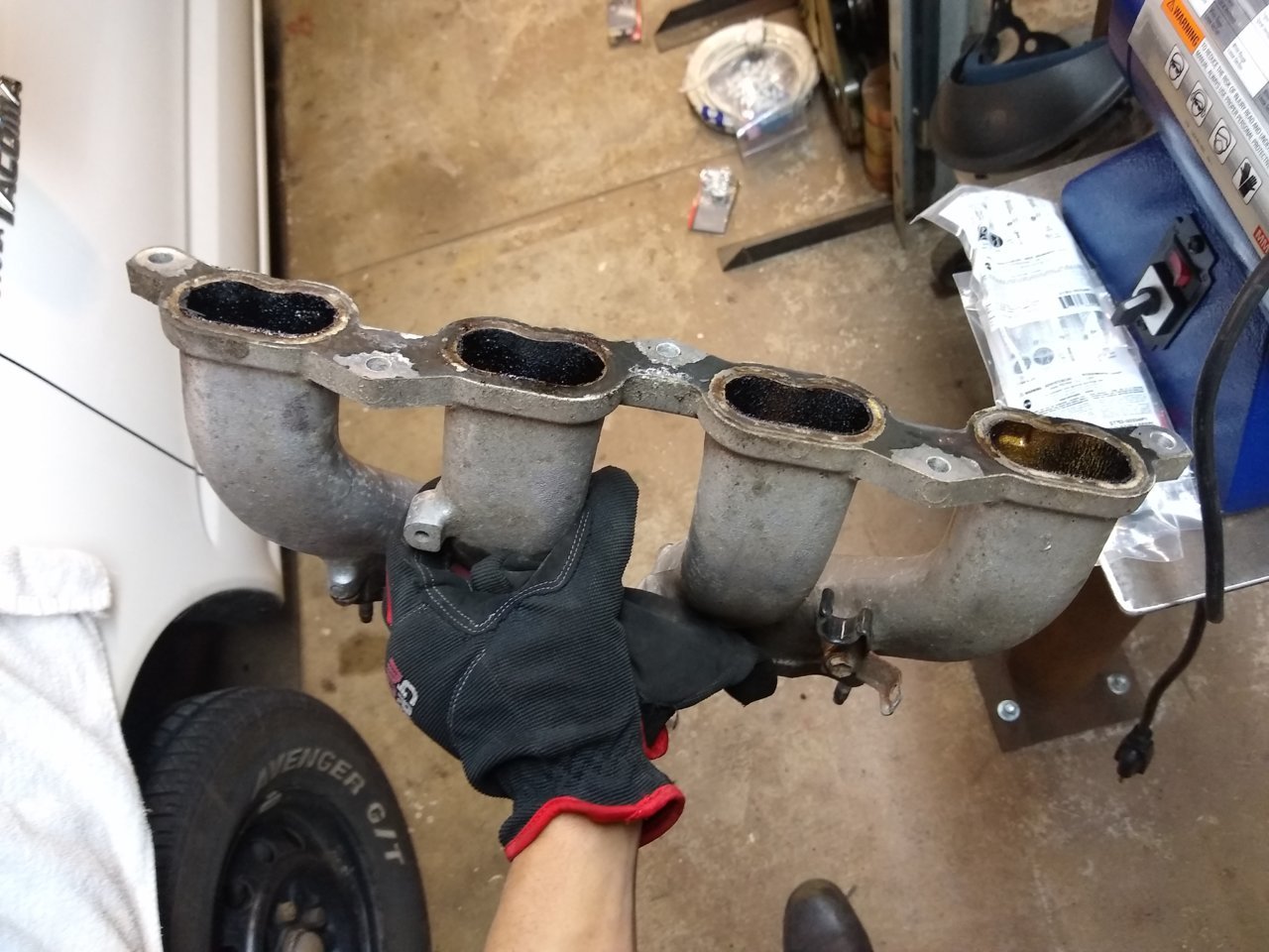

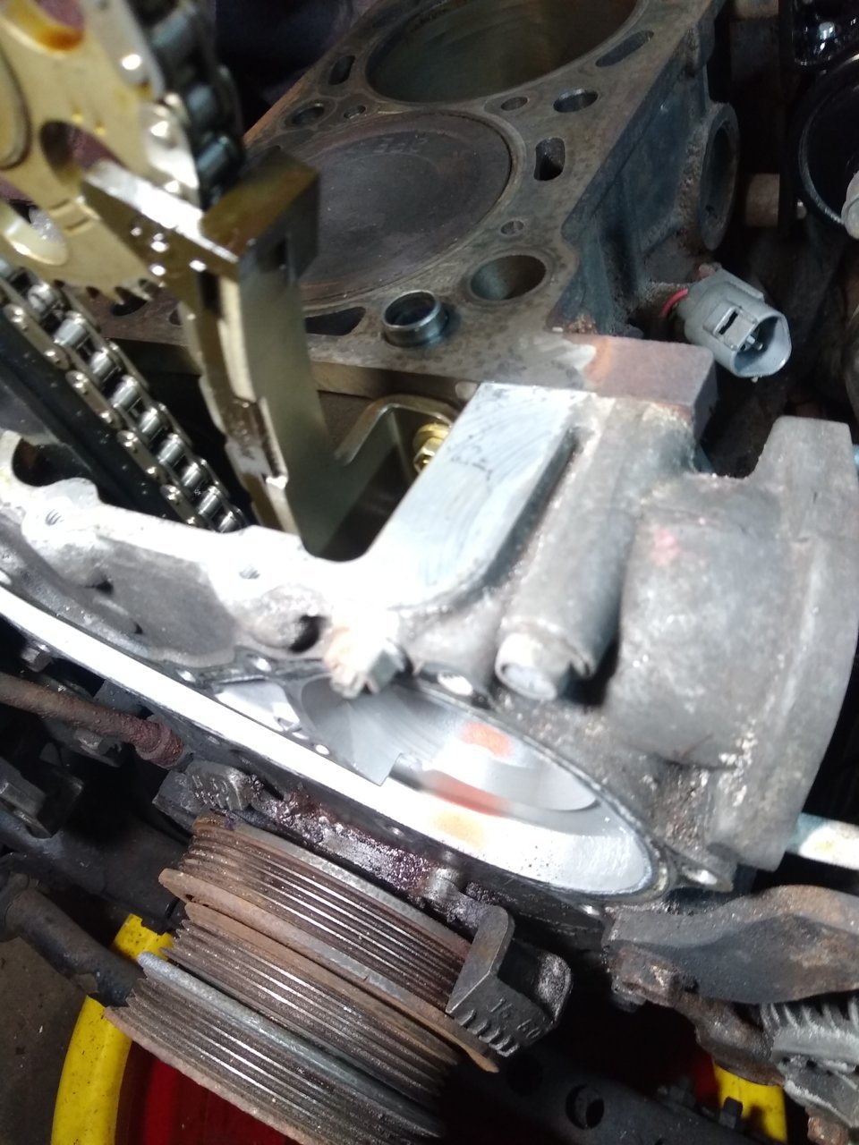

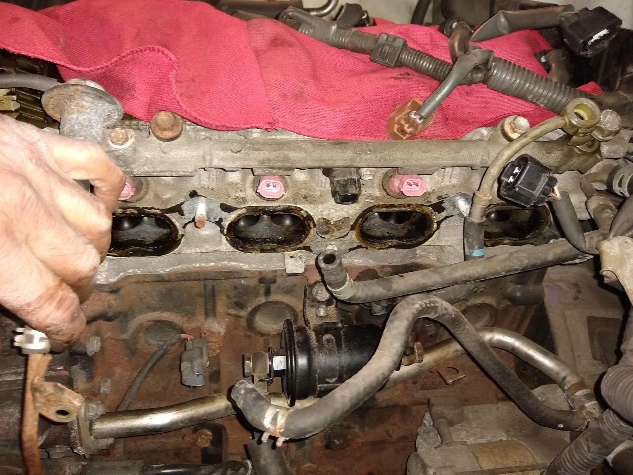

    I attached some pictures of interesting details. Note the cylinders being at TDC but the crankshaft punchmark being WAY off of zero degrees, and the gas/oil gunk on the intake manifold (suspected from the breather).

    First and foremost I replaced the bent exhaust valve and lapped it in and did the same for all of the other valves (new shims for all 16 buckets of course). The intake manifold and breather tubes had black, sticky residue that I cleaned out. We also noticed the old intake gaskets were worn down through the black coating to the metal (maybe small are leaks were entering here...) so these and all other top end gaskets were replaced as well. The MAF and upstream O2 sensors that I previously replaced were replaced again (a few weeks later) but this time with Toyota brand. They may have been the cause of my lean codes that I kept getting. New fuel filter as well.

    The black sticky mess is from the PCV valve. You can add a catch can if you want to prevent that gunk from getting back into the intake, otherwise you have to clean it out every so often.
