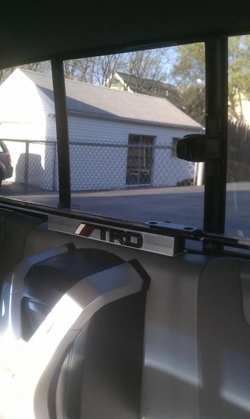

    Was really a piece of cake Greg. I just took my time and didn't force anything too hard. The adhesive that holds the latch to the glass is like a soft plastic that the blade cuts through nicely. Once the latch was detached, there was some leftover adhesive that needed to be pared away off the glass, but too was easy.
    You certainly could reposition the glass so that it is fully shut if you want to, but its not really necessary. You simply loosen the two allen screws on the bracket when the regulator is in the full closed position, then slide the glass over as far as it will go, and retighten the screws.

    I got the new one hooked up. Works great, smooth and no issues. Instead of pulling the latch off the glass, I took the bar off that it latches to (the one with the two screws) and used my dremel to cut the material off where it catches. So, even if I take the canopy off, it still looks like it is latched.

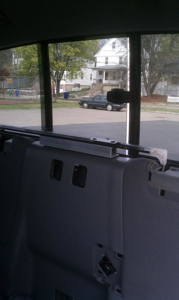

    On my truck, the anchor that the window latches to is held on by two small screws. I simply removed them and the strip at the edge of the window frame, and now the window does not latch to anything. it closes all the way making a good seal. It looks clean and can be put back if ever I want.

    I have an 08 DC. and am very interested in this kit. Is there any way of hiding the motor behind the plastic storage bin panel? Perhaps a longer cable so the motor can be mounted in the space below the storage bin?

    I did it to a 2010. Benwa's kit fits behind the panel no problem and you don't need longer cables to do it.I didn't cut the back panel at all. I finally finished today, this photo is unfinished. It works perfectly and I am very pleased
