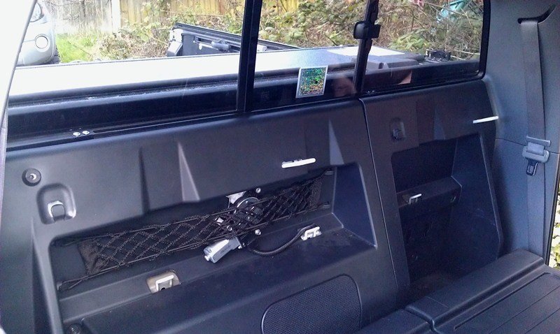

    BenWA [OP] Well-Known Member
    Feb 23, 2009
    #13977
    1,647
    Boston burbs
    '06 Double Cab TRD Off Road 4X4
    Without longer cables, there is no place to mount the motor of the Ridgeline regulator except in the non-hidden portion of the passengers side storage cubby. That is why I called it the "semi hidden" kit. The only way to mount the motor elsewhere is with longer cables, which you will not be able to buy anywhere. I have contacted many wire rope manufacturers in the US and none were willing to make custom cables for this purpose. I do not recommend using bicycle cables -- they are considerably stiffer than regulator cables and will wear the groove of the regulator spool very quickly, and will also tend to de-rail from the groove in the spool and become bound up inside the regulator case due to their stiffness. Trust me. I have been down this road.
    Your best bet is to do a semi-hidden version in which you can see the motor mounted in the storage cubby, or to experiment with another regulator altogether such as that used for a sliding window in an F150 or ram 1500.
    This is what my semi-hidden kit looked like in the double cab:
    This same embodiment of the mod also works as a full hidden kit in the Access Cabs.
